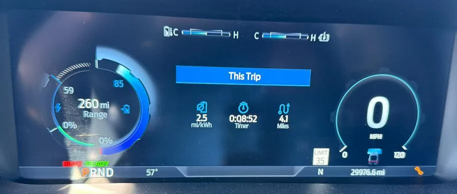

Yes.
Ford F-150 Lightning Dreaded Service Vehicle Soon Error 1731950983522-vj
When the error first came up it didn't show reduced power (or I didn't notice?), but after a few miles it dropped down to 59%, and then on the way to the dealer 56%.
I had the power reduction issue happen once during the summer at full charge, but without the error message and the wrench icon. I took it in, but it didn't happen for them, and I've been driving it since without issue until now.

Mine started at 54% and is at 57% reduced power right now. Both motors show they have power and it drives fine, but without being able to charge I had to stop driving it when It hit 62%. Dealership is 40 miles away so I didn't want it to get too low. Good luck getting yours fixed!
