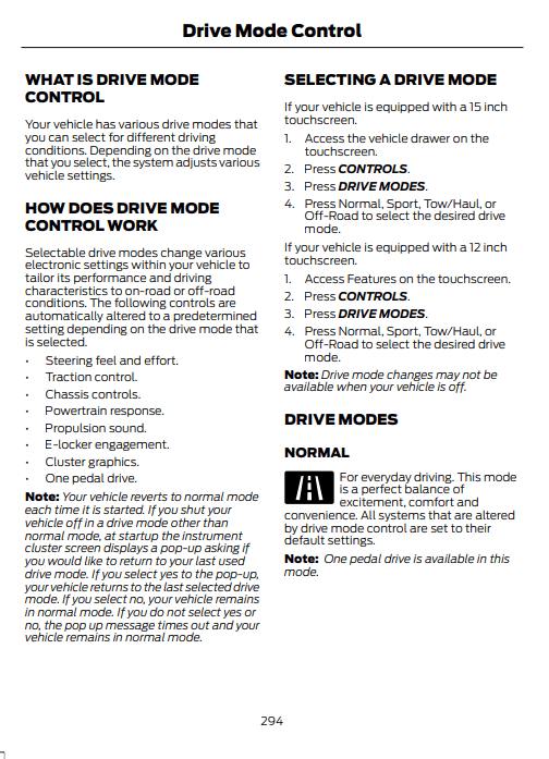

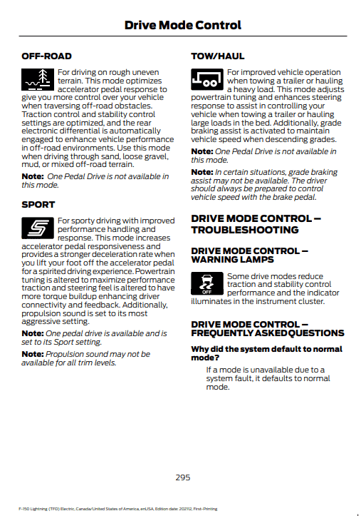

I would love to know what the different drive modes actually do. Please enlighten me.
I use my lightning for towing 90% of it's miles. So obviously you would think tow mode would be the choice. But why? Other then shutting off the one pedal drive and blind spot system does it actually change anything?
I noticed that the off road setting engaged the rear locking diff and I think it disables traction control?
4,911
6,462
All clearly explained in the manual, starting on page 294.
Ford F-150 Lightning Drive modes comparison -- what does each one do? drive mode 1.PNG
Ford F-150 Lightning Drive modes comparison -- what does each one do? drive mode 2.PNG
I see all that, but like... I kinda want a more technical answer.
For example... Normal vs Sport:
More accelerator pedal responsiveness... How much more? What changed in the mapping?
Stronger deceleration... How much stronger?
How is the traction setting altered?
etc...
