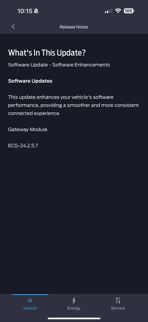

Here I am complaining about not receiving any OTAs in months and lo and behold, I got one today for the gateway module ECG-24.2.5.7.
I went to the store not more than 10 minutes from the house, by the time I shopped and returned home I got a successful update notice when I turned off the truck.
That funny! I was complaining to myself for the last few months about the lack of updates, and low-and-behold, an update, even though I don’t know what is meant by the description of what the update is all about!
