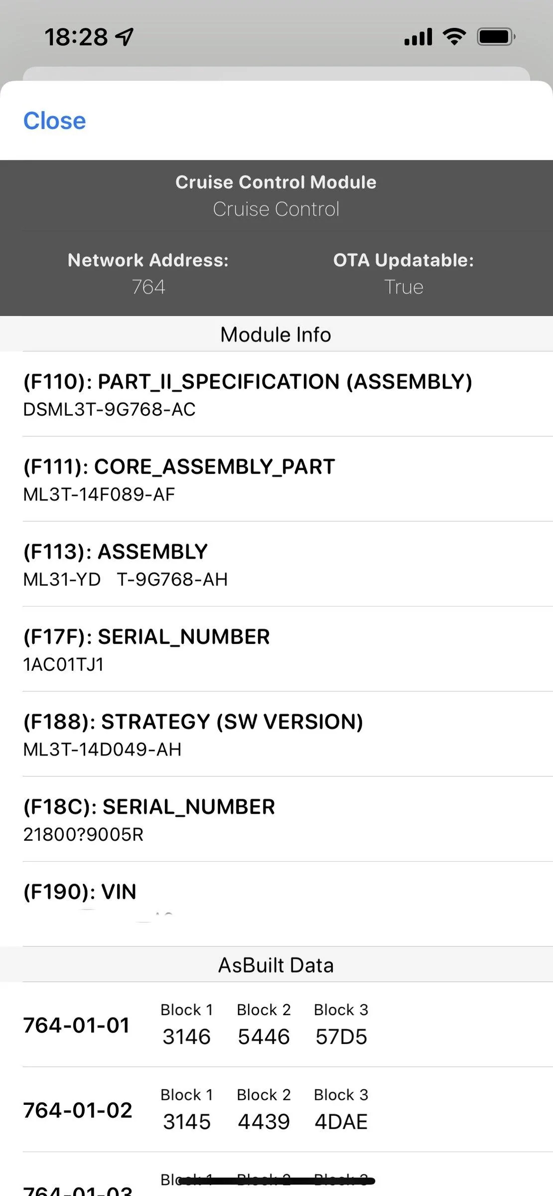

Sure. Here is a ss of widget too.

My current strad is ml3t-14d049
Does that help or do you need a diff mod info?
Your CCM is at ML3T-14D049-AH should be at ML3T-14D049-AL. So you are not up to date
