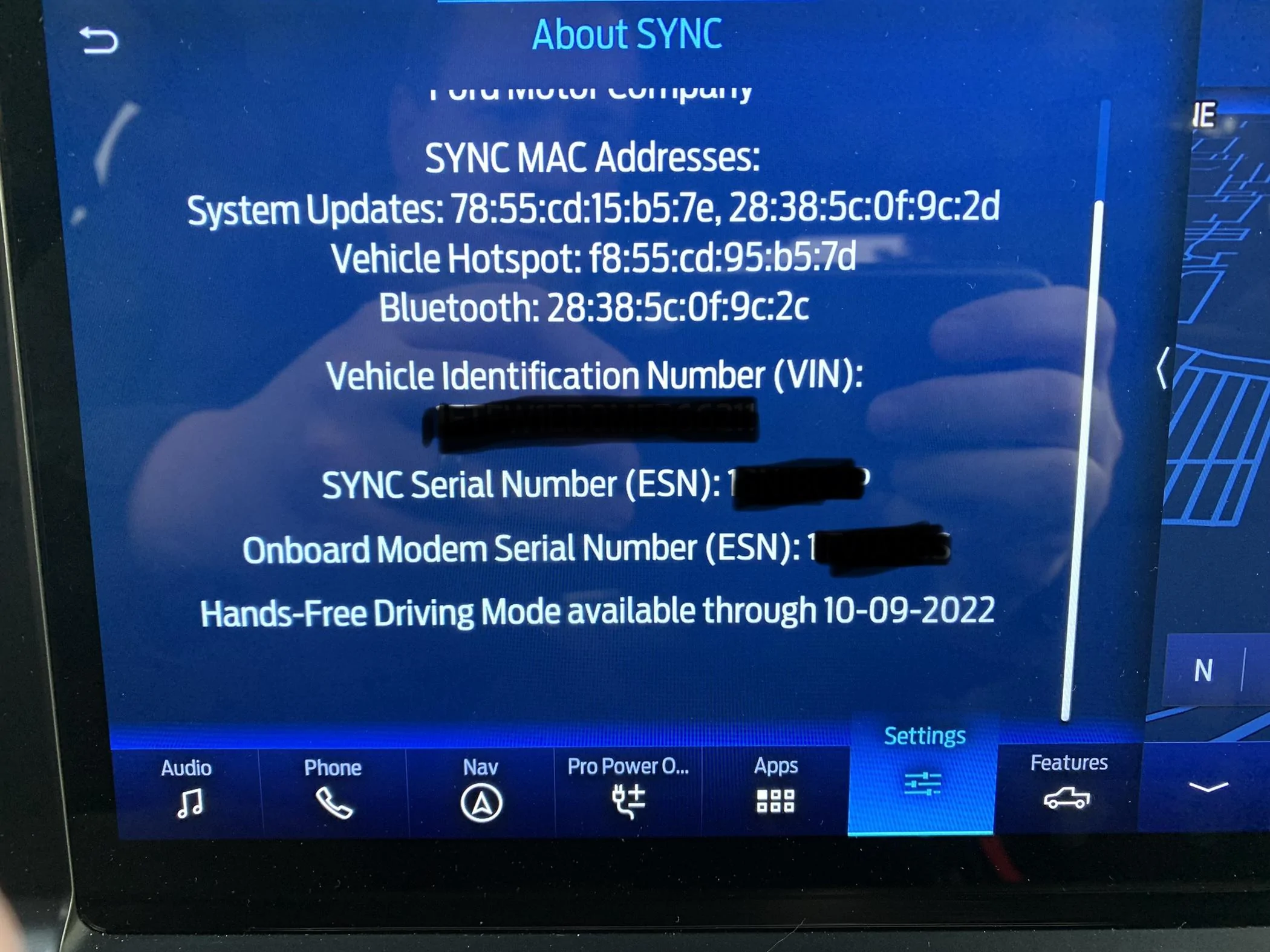

Anyone who has updated their modules to the latest versions in FDRS also notice this hands free driving license in the about menu in their Sync? Is everyone’s showing the same?
No, mine isn't showing that. Did you get the 2.52 OTA w/GWM update since it looks like you're ready for Bluecruise?

No, mine isn't showing that. Did you get the 2.52 OTA w/GWM updates since it looks like you're ready for Bluecruise.
No OTA, all updates via FDRS and I still have the IPMA DTC for Ethernet to gateway failure.
I did although make changes to the APIM, IPMA and IPC to match a job 2 truck. I posted those changes in an earlier post.
These are all the changes I made to match the job2 truck with BC from factory.

I haven't checked all those values but the IPC one is for a Flex Fuel Vehicle so not sure if that's what you have? My asbuilt there for a Powerboost is 9 so doesn't look like I would need any IPC change

Although your changes above may work, without the GWM update (2.5.2) I'm betting you won't get BC to work. Either way, I'm at 2.5.1 and I don't see anything in the Sync screen.
