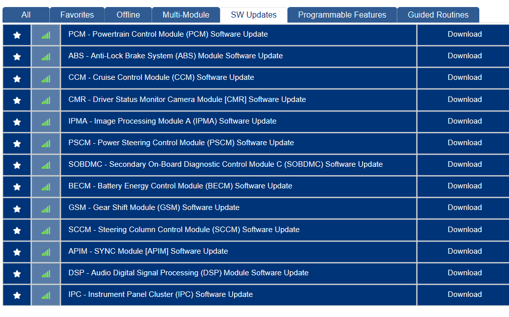

@Snakebitten
Any way to check my VIN as well for updates before I start the process?
1FTFW1ED5MFB85952
Thanks so much!

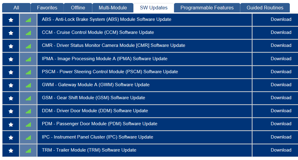

Powerboost'rs rule in this club. :)
It's like it must attract nerds?
thanks!
For those who have gotten BC to work, are there any AsBuilt changes to make?
