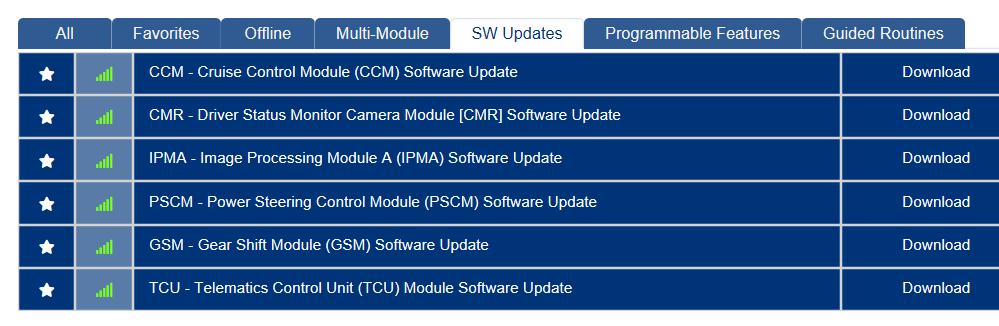

Can someone check that the updates are available to me before I go down the rabbit hole? 1FTFW1E89MFA46118

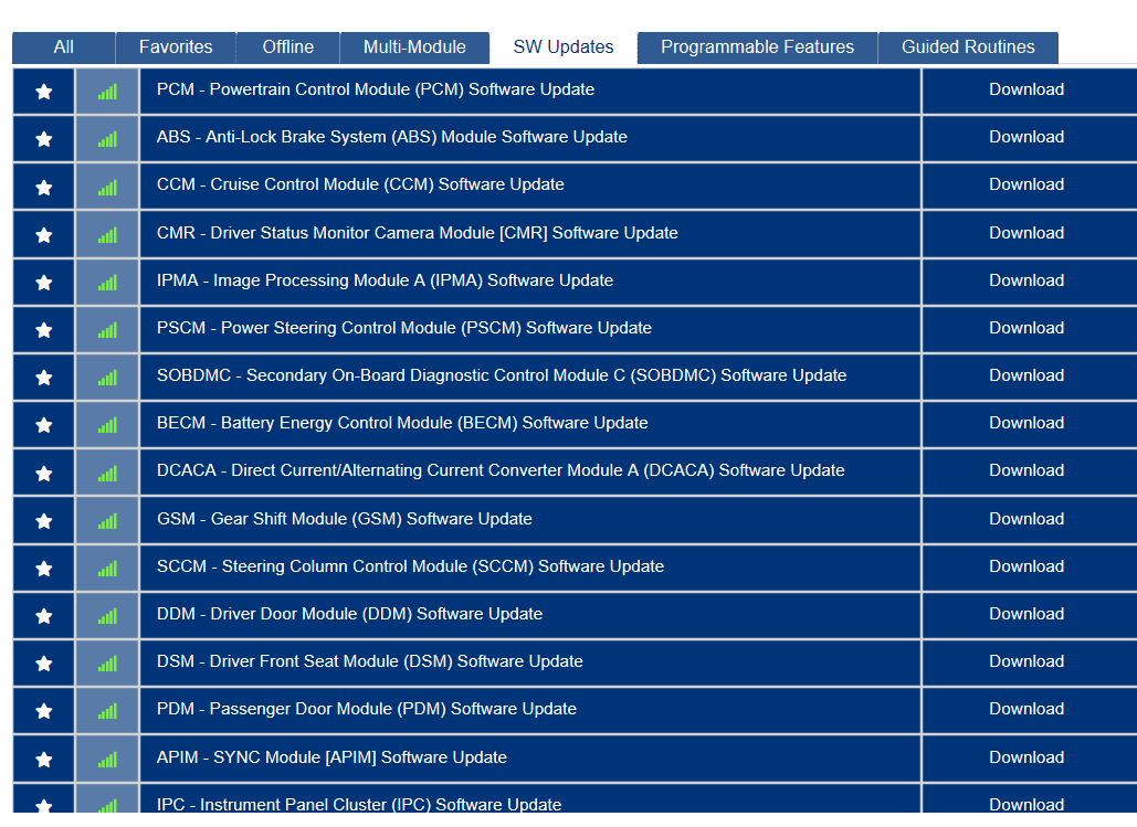

I hate to "me, too", but I would like to know if there are updates for myself. If there are updates, I can talk to my dealer (he's pretty friendly). Thanks! VIN: 1FTFW1ED0MFA88769

Yea I just called and the reason I was asking the guys for help. 3 different ones in Texas said they will not do them. I had to wait for OTA

You might get a pillow and blankey, because you will be spending the night in the captains chair of your mighty Powerboost. (there's a scroll bar, if you know what I mean ?)
Ford F-150 Lightning ECU module programming guide using FDRS REFACTORINGDR.PNG
