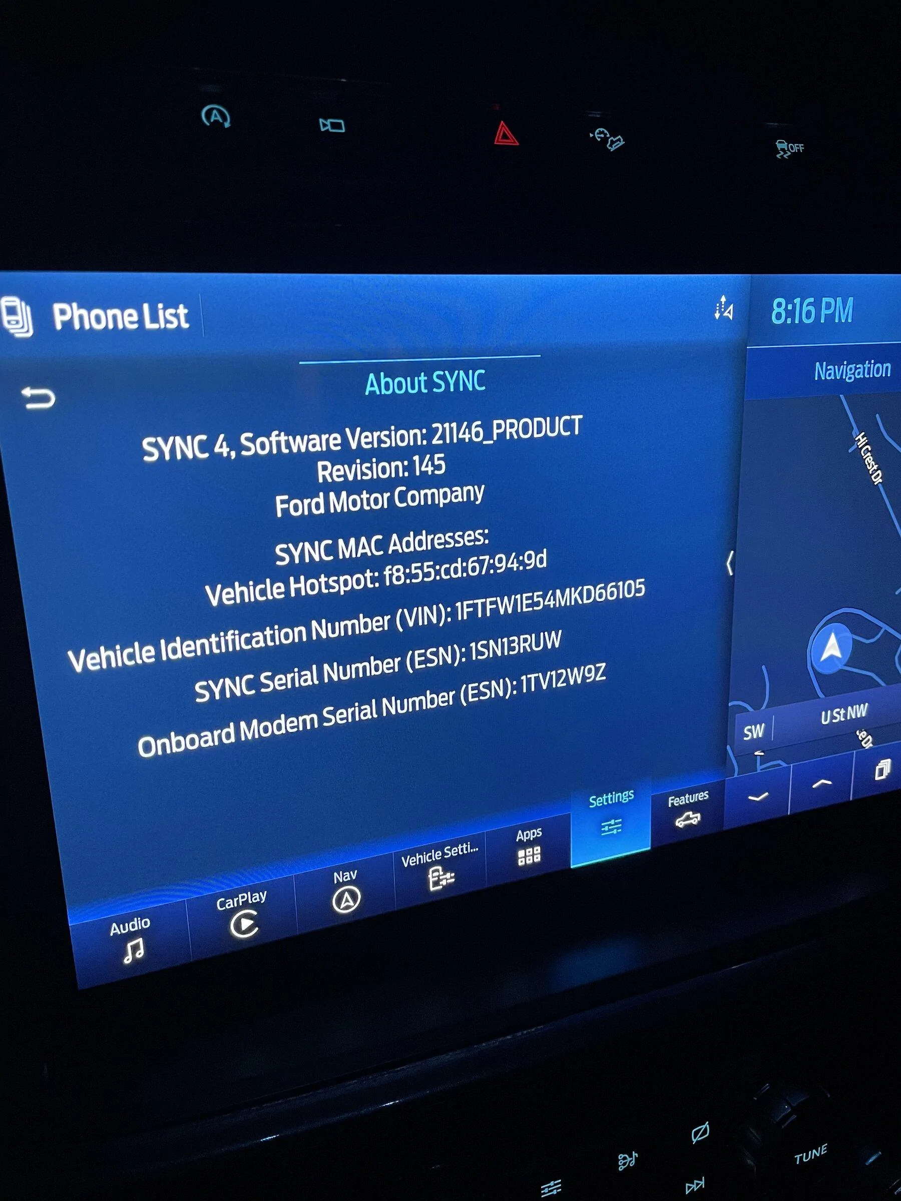

Hi SpeedRacer… yes I left the USB stick in and turned off WiFi completely (that connects to house) within Sync. About 24 hours later I noticed the auto updates and schedule updates allowed me to change the settings. After that the very old version of sync was listed in the About Sync area. (It was all blank for the longest time)
After seeing all that I pulled the USB stick, started up the truck, then re-inserted the stick… about 3-5 minutes later. BAM! The USB install notice popped up!
