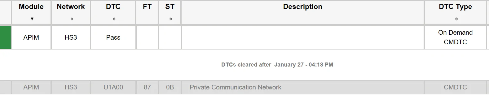

I'm a stubborn SOB, so I paid another $50 to get my FDRS license re-upped and found this waiting on me. Could this be why it's not kicking off the usb update for APIM? And if so what can I do?

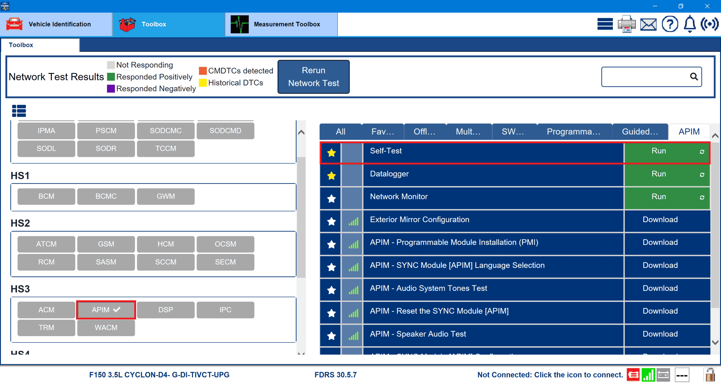

Click on Toolbox, select APIM (its under HS3 section) and run Self-Test. See what's the issue and try to clear the fault.

Post a screenshot if you need further assistance
