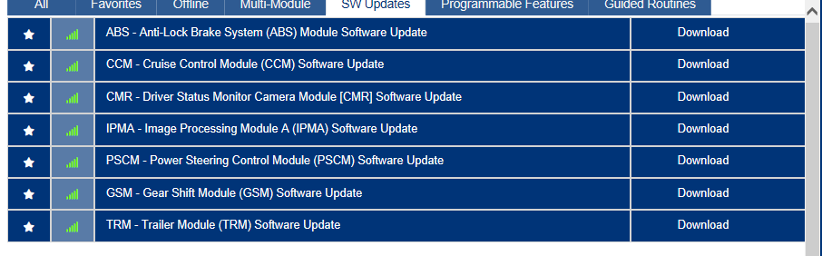

Gwm is supposedly up to date. Tried to get BC full blown to trigger by pmi as new gwm but comes up with an Ethernet error. Ran self tests, etc. No errors. Same 4 ghost updates still not going away but indicate they are current. Tried reset the gwm from forscan. Didn’t help. Ugh. ?

The PSCM module will also kick off the CCM/IPMA/CMR/PSCM chain. I'm guessing that if you attempt CCM, PSCM, or IPMA, you're likely going to be updating all 3 modules, so don't try to do any of those with a Nano device.
I (a Nano user) thought I could start the chain and cancel before the CCM tried to update. I don't have the BC prep, so hands-free was never my end goal with these updates. I figured I could get everything but CCM and wait for that update OTA.
And perhaps if I was really attentive, that could have worked. But I accidently started the CCM update. And so, the Amazon fairy shall deliver a Mongoose tomorrow.
I figure if I'm going to keep at this, then I need to upgrade my hardware accordingly :cool:.

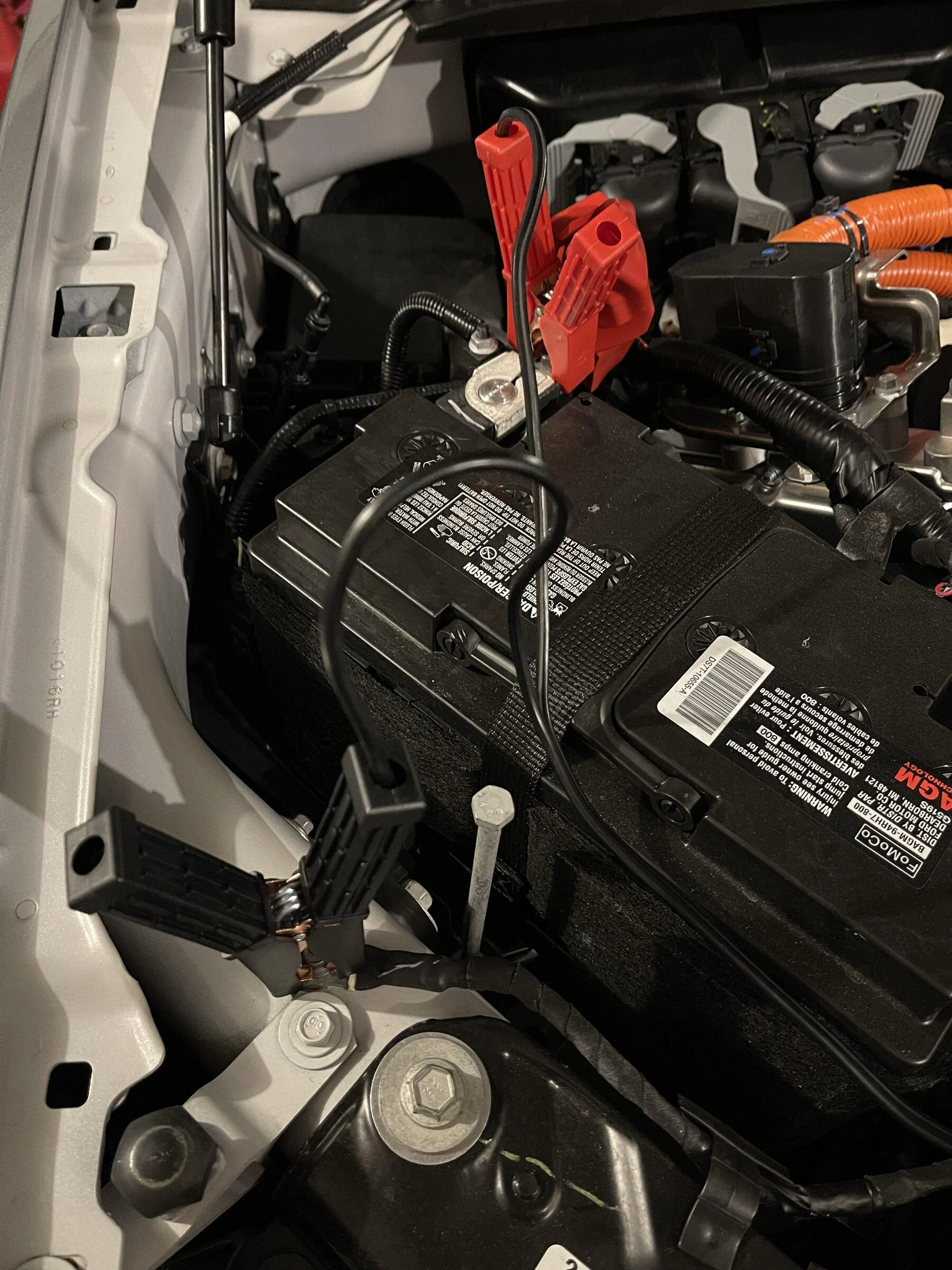

Beginning my long driver seat journey on my job 2 truck today. wish me luck! ?
This is the best location I have found to connect the negative lead to the truck. The other locations in this thread didn't work for me. I'm using the maintainer recommended.

All went well and I got my BlueCruise notification after the GWM update. Below was my sequence, and also the update method for reference for others.
PCMCANKey On, Engine Off
PSCMCANKey On, Engine Off
CCM (w/PSCM)CANKey On, Engine Off
CMR (w/PSCM)CANKey On, Engine Off
IPMA (w/PSCM)CANKey On, Engine Off
GWMUSBKey On, Engine Off until update installed, then Key On, Engine On
APIMUSBKey On, Engine On
The CMR module took about 50 minutes, the IPMA took about 2:35 start to finish. Overall the updates took me about 5 hours. The option for hands free didn't show up in the APIM until after letting the truck sit off for several minutes after the update finished. I had the notification for BlueCruise in FordPass shortly after the GWM update finished, but the APIM update needed done before it showed up there. I also don't think my Sync version changed despite the APIM update, but I'm not certain. My expiration date is showing 10-09-2022 like someone else posted here and I am not in Canada. I'm wondering if that is a hard coded date string and it just hasn't talked to Ford's servers yet for me. I was parked in a poor cellular reception area when it finished. Can't wait until tomorrow to try it out.
I also downloaded my AsBuilt data from Motorcraft before starting, going to compare to after the process later to see what may have changed. I did download it partway through and the oddities in text strings in the XML are gone now that I used the Mongoose.
Why not follow that back to the battery and put the clips on the flat connector piece before the monitoring electronics? You would have more to bite on to and it is technically the same ground point but 8 inches closer to the battery.
