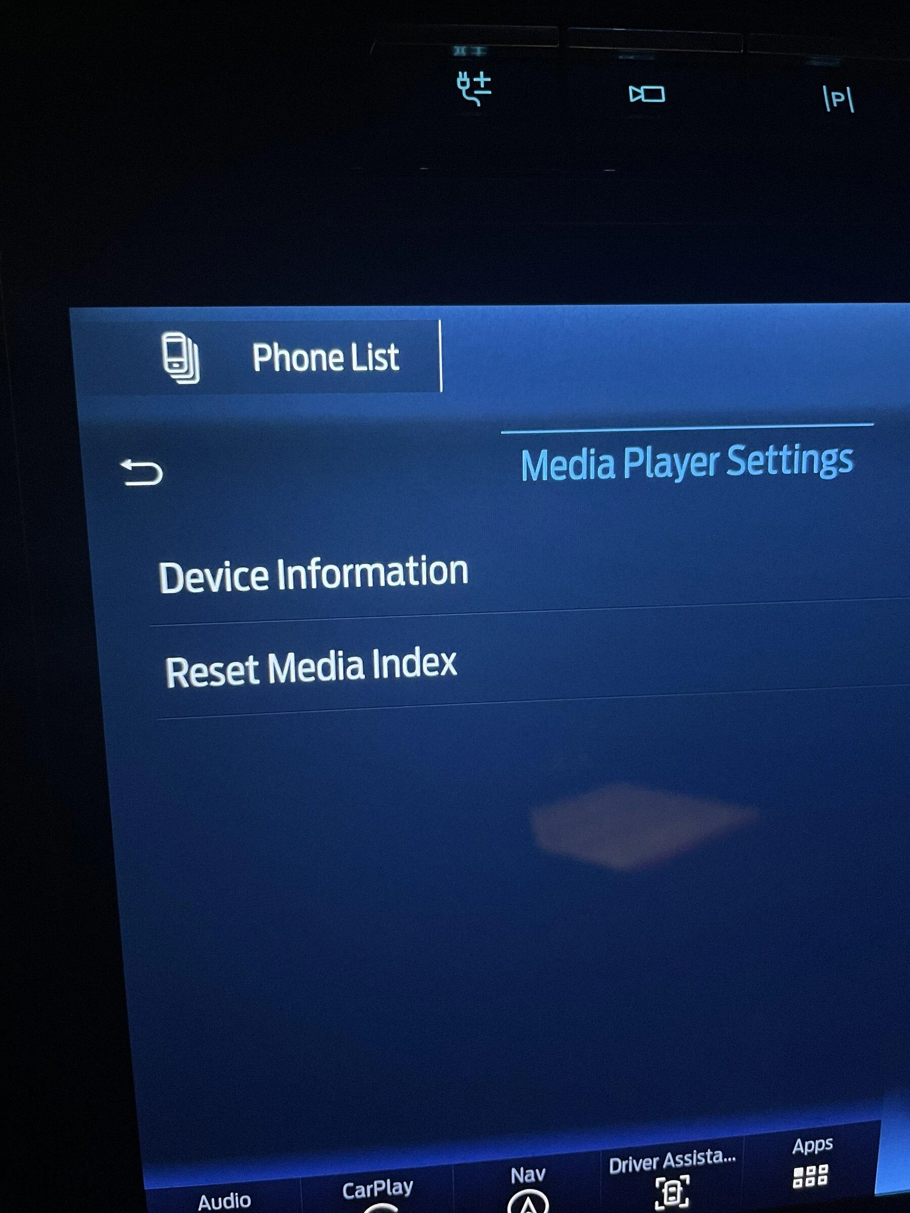

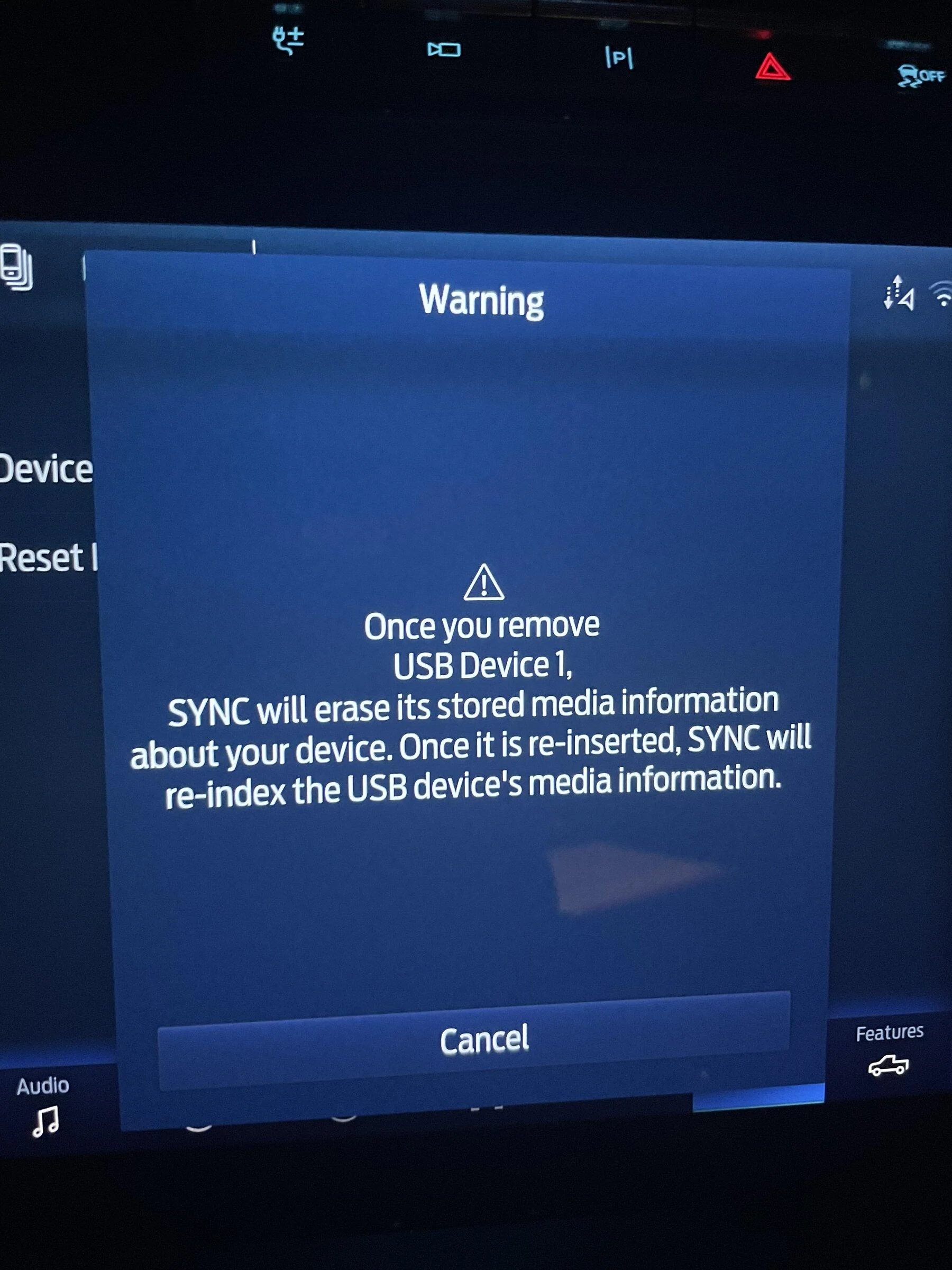

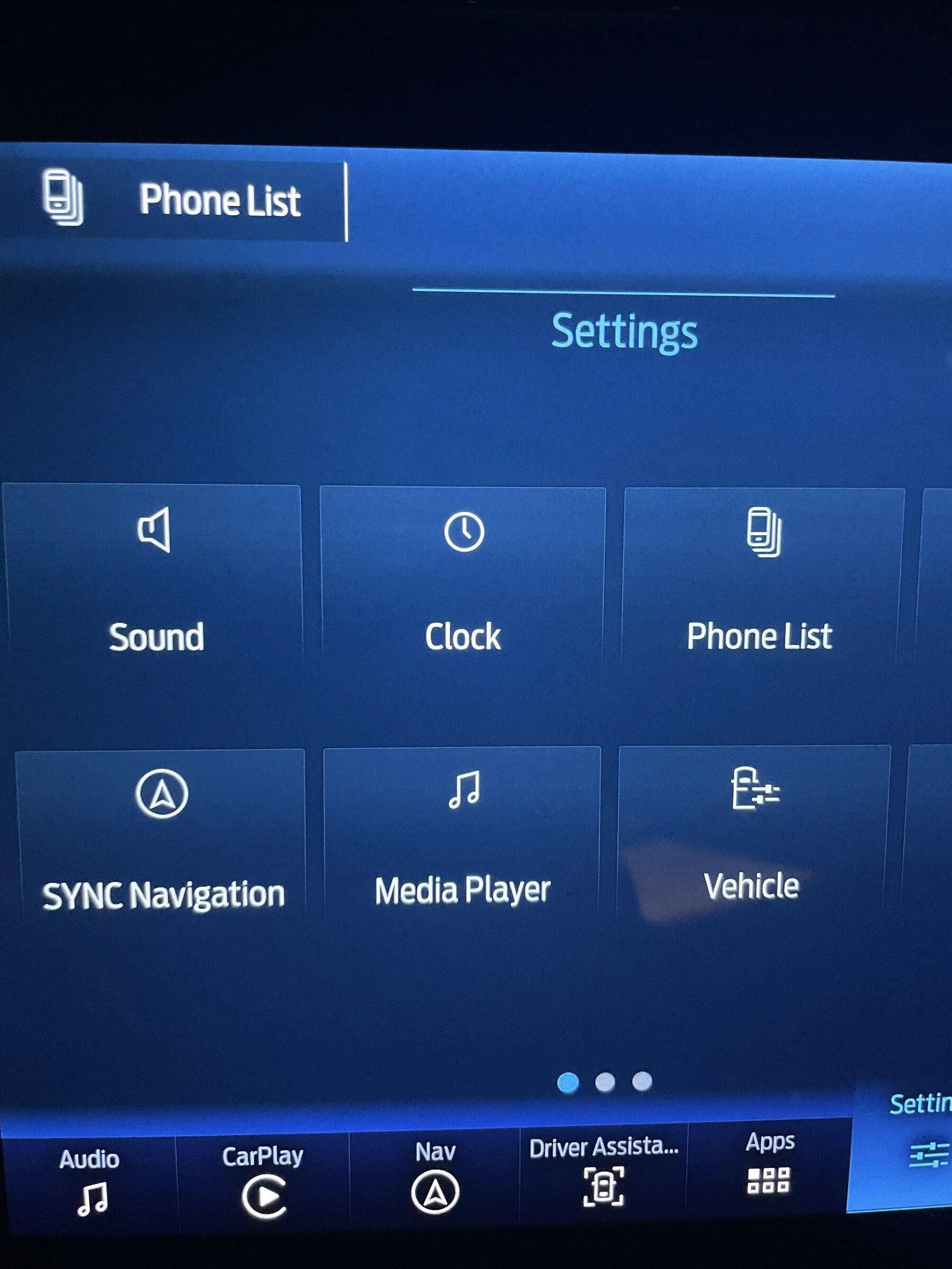

Discovered something today while trying to do my updates. No need to do a Master reset to get the usb to re-index. Go to Settings>Media Player> Reset Media Index. Upon removing the usb the system will delete all info from the usb and it will initiate indexing the next time you insert it. Do all this while it is still inserted in the media hub

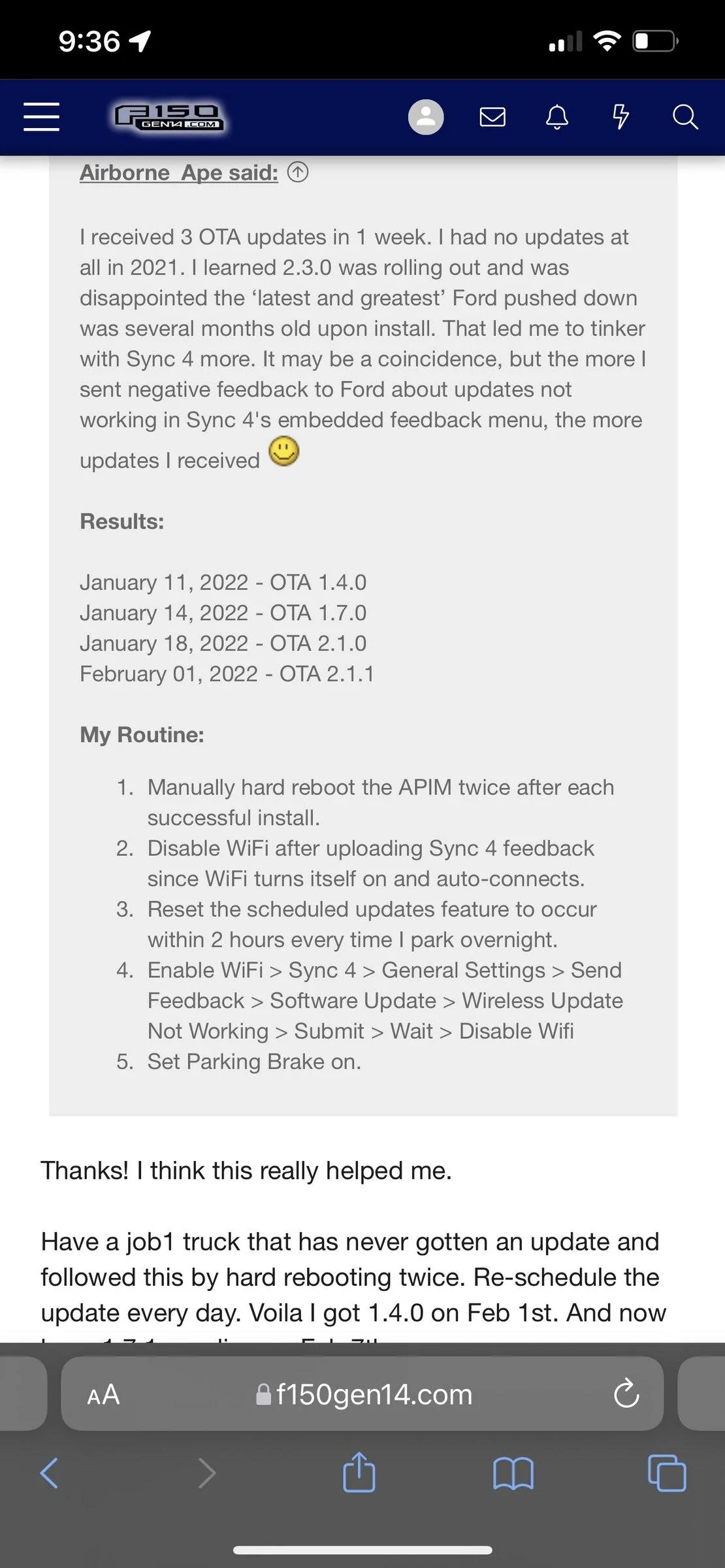

My APIM just kicked off via USB
I made the USB yesterday afternoon, about 20 hours ago. I did a master reset and a GWM reset at the time. Left the truck parked overnight.
This morning, I followed the steps in the photo below, but I sent feedback for both USB and Wireless. I then plugged in a charger, did a network scan in FDRS and got the “keep USB plugged in message”
