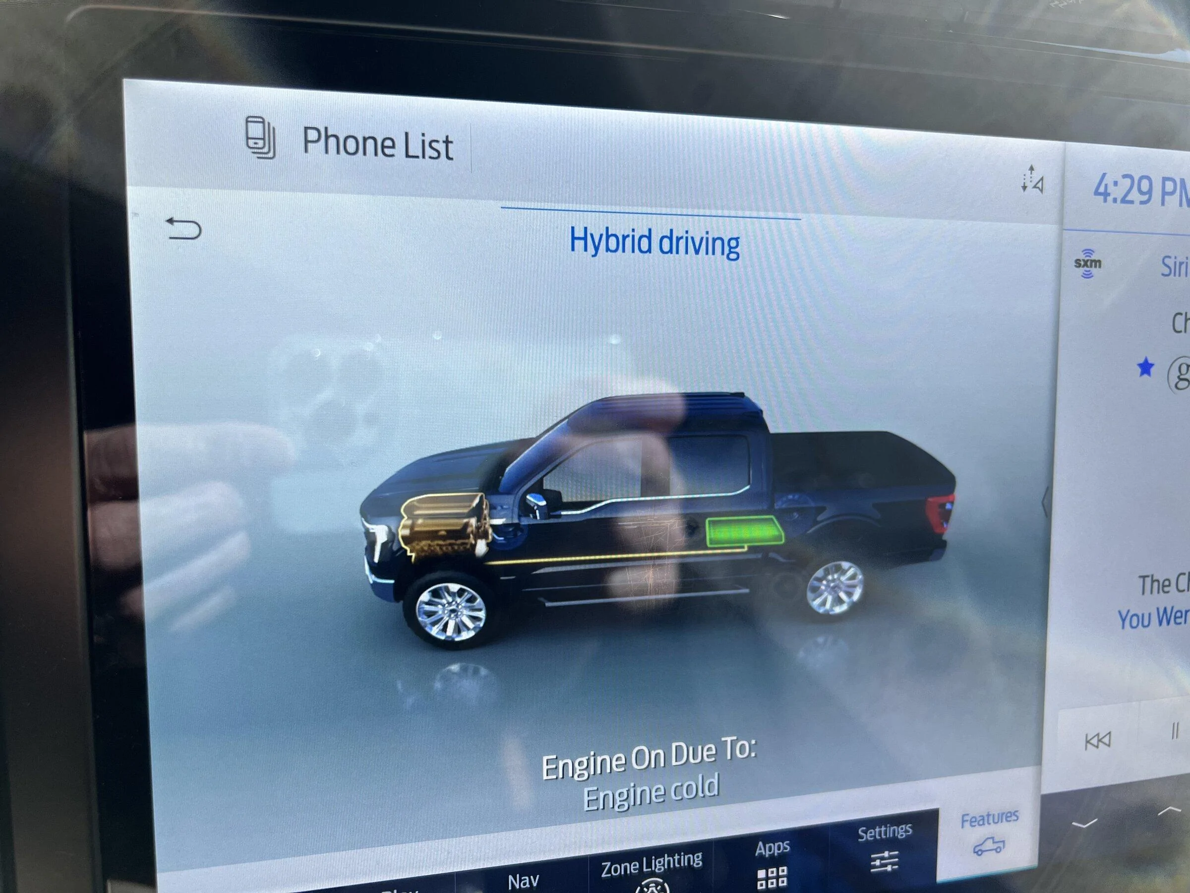

My battery charger was DOA so I didn’t get all of the updates done yet. I had 3 odd issues afterwards. 2 only occurred the first time I drove it after the updates. The last issue is this running board issue.
Message came on that backup brake assist wasn’t available backing out of the garage. Next 2 times in the truck and backing up with no error.
The truck wouldn’t run on battery. I checked the power flow and it showed this message. It was 66 degrees out and I’ve been driving over 7 miles at this point. After we stopped for ~45 mins and left it was back to normal.

I had mine forget it was a hybrid after the insulation recall repair. I believe they drained the HEV and for a drive cycle it wouldn’t go into EV mode. I don’t recall if it fixed itself or if I charged the battery, but it did correct itself and I believe it was caused by low battery.
it’s possible yours Is related to doing updates without a charger and it will fix itself.
