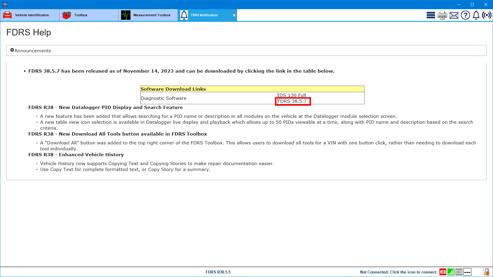

Ford F-150 Lightning ECU module programming guide using FDRS FDRS_38-5-7

FDRS has been updated again...but trying to login is still frustrating.
It requires multiple attempts using your motorcraft account login email and password in the dialog box, alternating with your FDRS username and password in the dialog box, and then suddenly it lets you in. 🤷‍♂️
Not updating unless I have to. I had to download an archived version of FDRS to be able to login to motorcraft and this latest version sounds like they still haven’t fixed the issues with that.
Somebody literally minutes ago on the MME site said that they have been using their motorcraft email address account and password to get in and it works fine everytime. I had tried that this morning, on one of my many login attempts, and when I finally got in I noticed that now at the top of the screen instead of my normal FDRS username it shows my motorcraft email account address.
If they were going to change the login from what they've been doing for at least the last two years to something different it would've been nice to post that on the splash page or something.

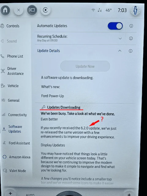

So it looks like this week's new release is going to be a second revision of the APIM OTA update similar to what the Mach-E folks got last week.
For those who aren't aware...many of the MME owners who got the APIM update that was OTA 6.2.0 (same as Lightning OTA 6.3.0) got a revised version last week that kept the same OTA number but was an updated package.
It looks like this morning in FDRS we are going to get the same thing as there is a new APIM update in the list for my '22 model and the application manifest says its the same revision as the newer one released for the MME last week.

So I went out to do the update this morning using FDRS and checked the "Software Updates" screen ahead of time to find this:
Ford F-150 Lightning ECU module programming guide using FDRS Lightning_APIM_6-3V2_Sync_1049
Yeah...instead of an updated version of 6.3.0 (APIM)...the notes say that it's an updated version of 6.2.0...which means they copied and pasted the notes from the Mach-E OTA 6.2.0 re-release and didn't change it to read 6.3.0 for the Lightning. 🤦‍♂️

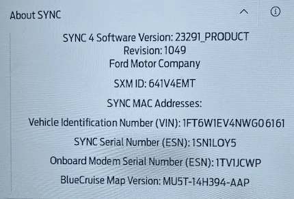

Regardless...since I didn't want to wait for this OTA to finish downloading (due to a planned roadtrip this morning) I did the update with FDRS and it resulted in the APIM going from Sync 980 to Sync 1049...just like the Mach-Es that were updated last week.
Note that starting with Sync 980 that the "Expiration Date" for BlueCruise hands-free driving text at the bottom of this panel has now been replaced by a map revision version number instead.

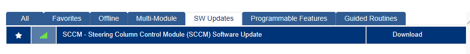

Happy Thanksgiving and surprisingly a new update showed up this morning:
Ford F-150 Lightning ECU module programming guide using FDRS Lightning_SCCM_Thanksgivi
Another update related to the slow steady march toward BlueCruise 1.3. I'll see if this will show up as an OTA and if not I'll do it this weekend when I get home from visiting family.

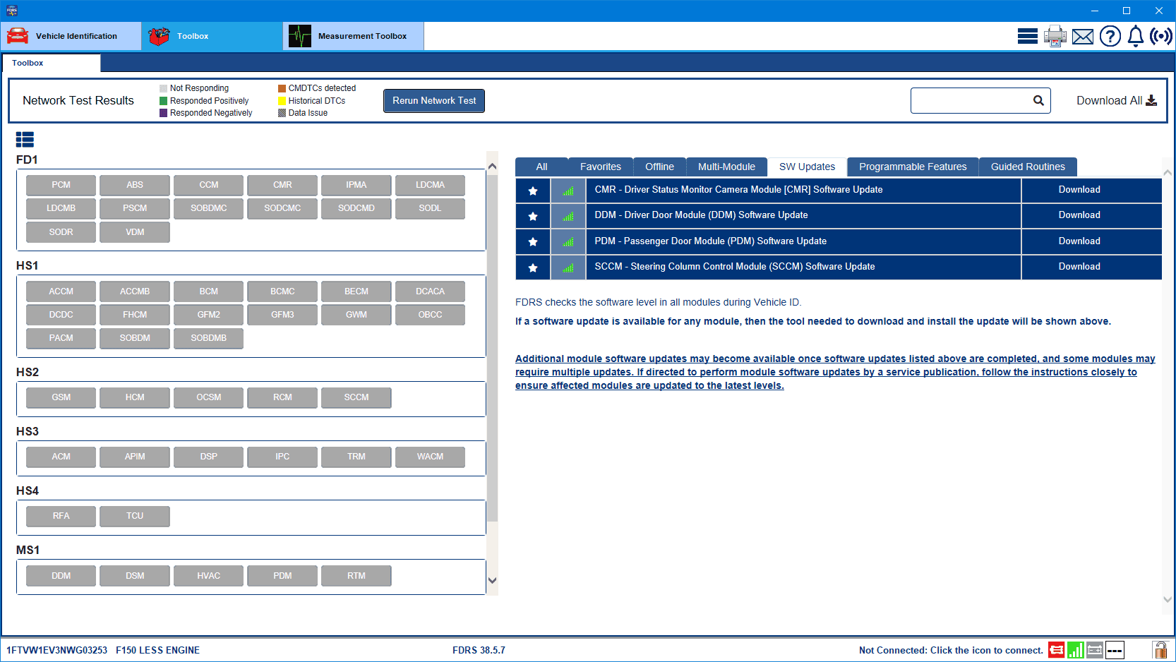

Happy Thanksgiving!
Here's your list this morning:
Ford F-150 Lightning ECU module programming guide using FDRS 1FTVW1EV3NWG03253-23-Nov-23
