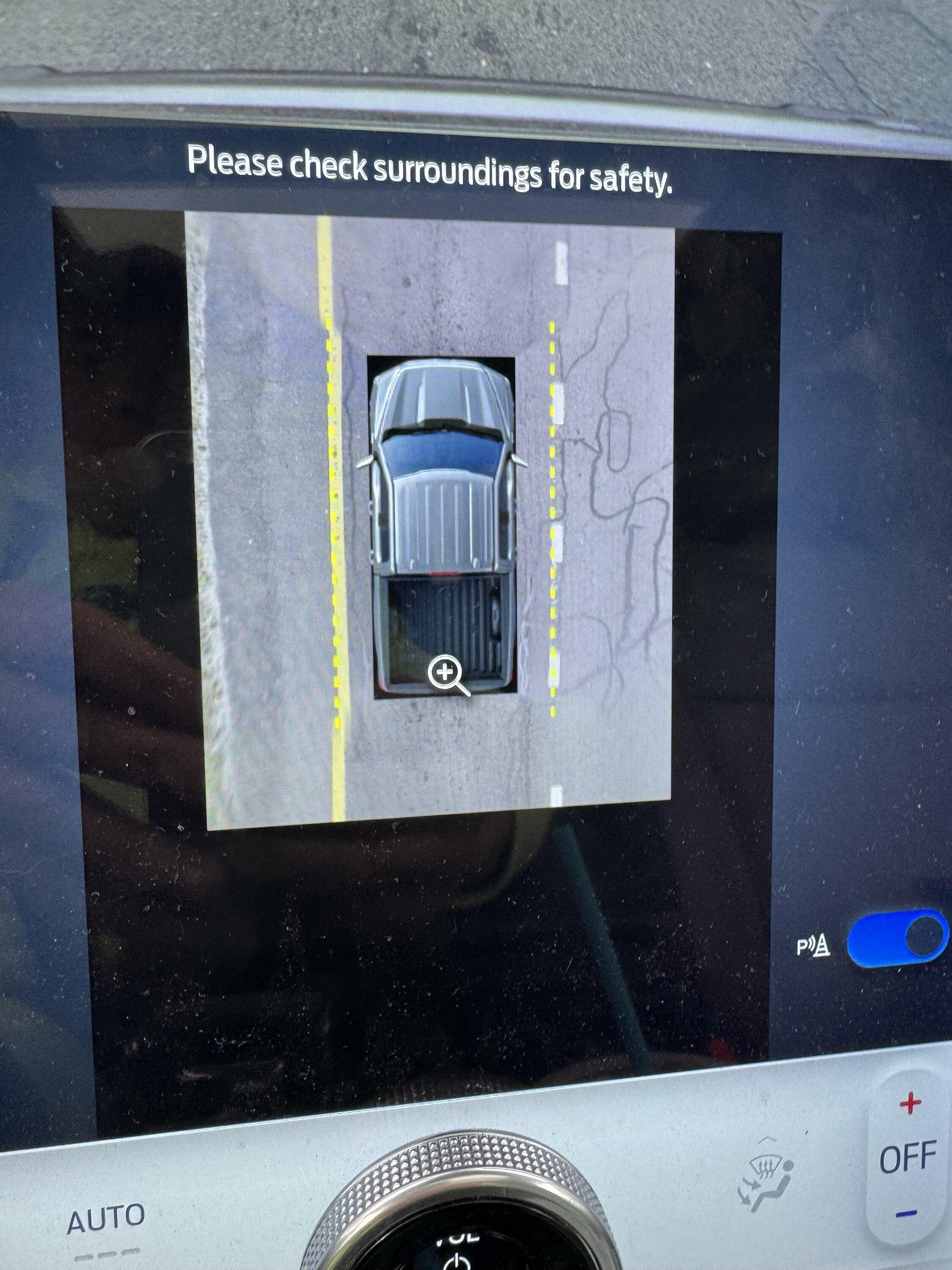

anyone notice their truck camera display looks like this after the update ? Am I doing something wrong ?
My truck came like that. There's apparently a process to align it, but you have to have FDRS or Forscan or something to DIY. Need to take it in and have a tech align your cameras. I need to do the same but good luck finding a service department that doesn't want to just hold your truck on their lot for a week before they'll even look at it.

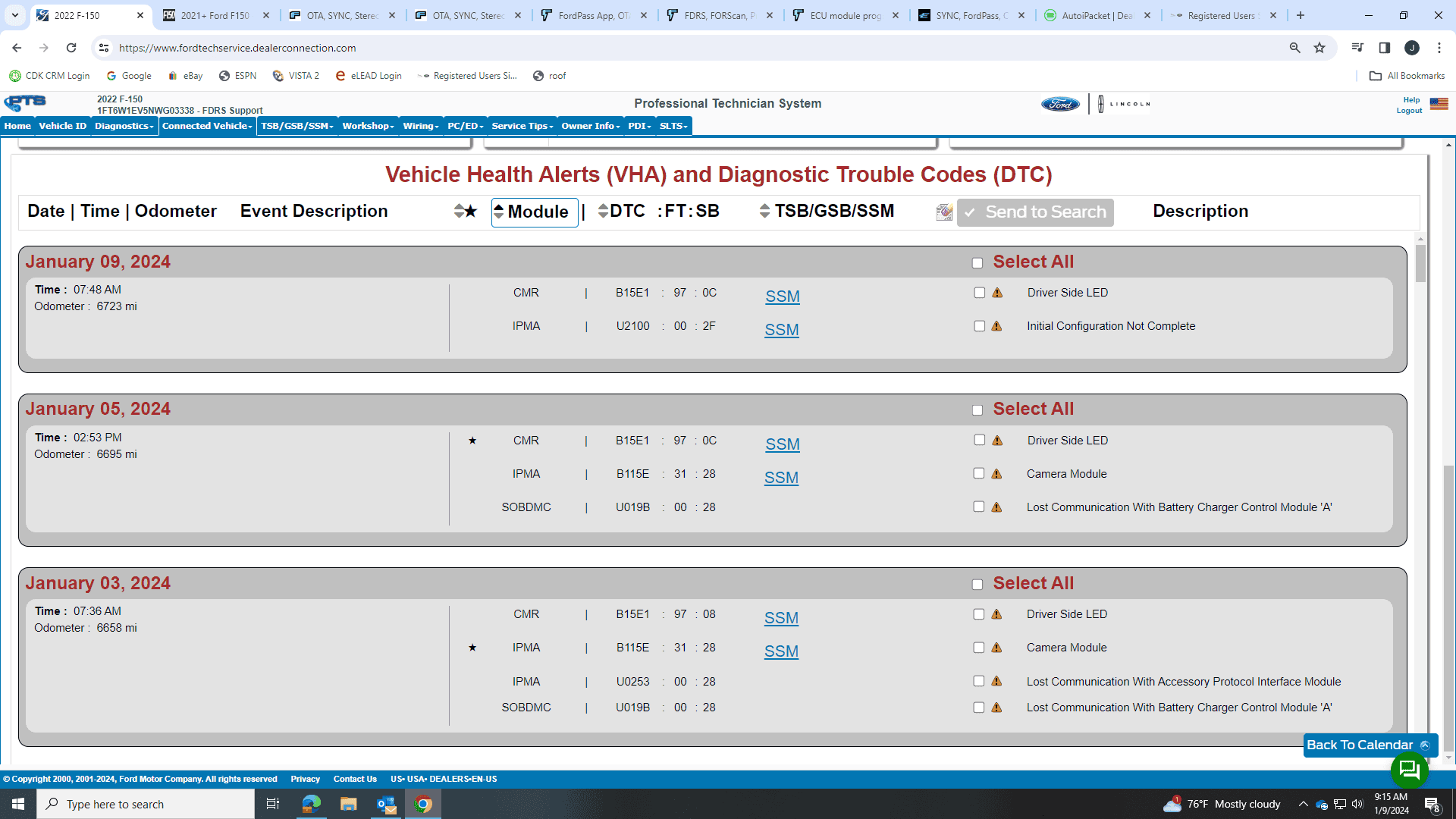

However, I now have Pre-collision not available and my camera looks like what @ChrisCon posted. I also noticed my light pattern looks higher on the right side, but no one flashed their lights at me. Another thing is I have not had a front sensor alert go for no reason like it normally does.
Would someone look in PTS for 1FT6W1EV5NWG03338 and make suggestions on what to do next? I have both FDS and FORscan.

Based on the DTC's you truck just recorded, your findings are well justified. I see you tried to update the IPMA again a second time. I don't have access to FDRS now, but I am assuming the IPMA update is still available for you in FDRS? Vehicle history shows the second IPMA update did not go through due to a unknown battery check error.
My instinct tells me to PMI the IPMA and select "no" when asked if it is the original module, but I am going to ask for a second opinion.

@MickeyAO Second opinion came back and my hunch was correct. Run a PMI and select "no" to the original module question. That should fix the issue.

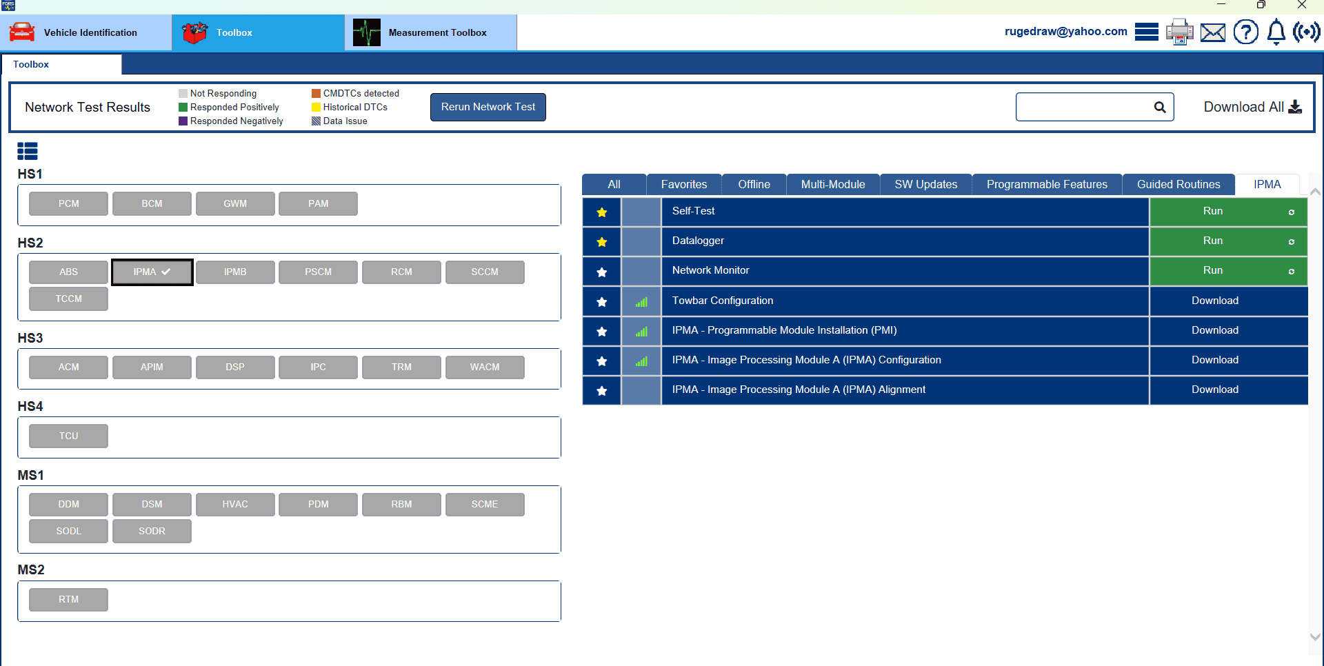

In the toolbox tab, click the IPMA module on the left and this menu showing everything that can be done to that module as far as FDRS procedures will populate on the right. Download and run the PMI. It will ask you if the original module is installed, and you select "no" in this case. If you select yes, it will load the original as-built data and that you do not want. If you select no, it will look for the correct files needed to properly config the IPMA based on the current software state of your truck.
The PMI will take just as long as the updating the module, so three hours in this case. Do it when you have time to do it, and this will fix the issue.
