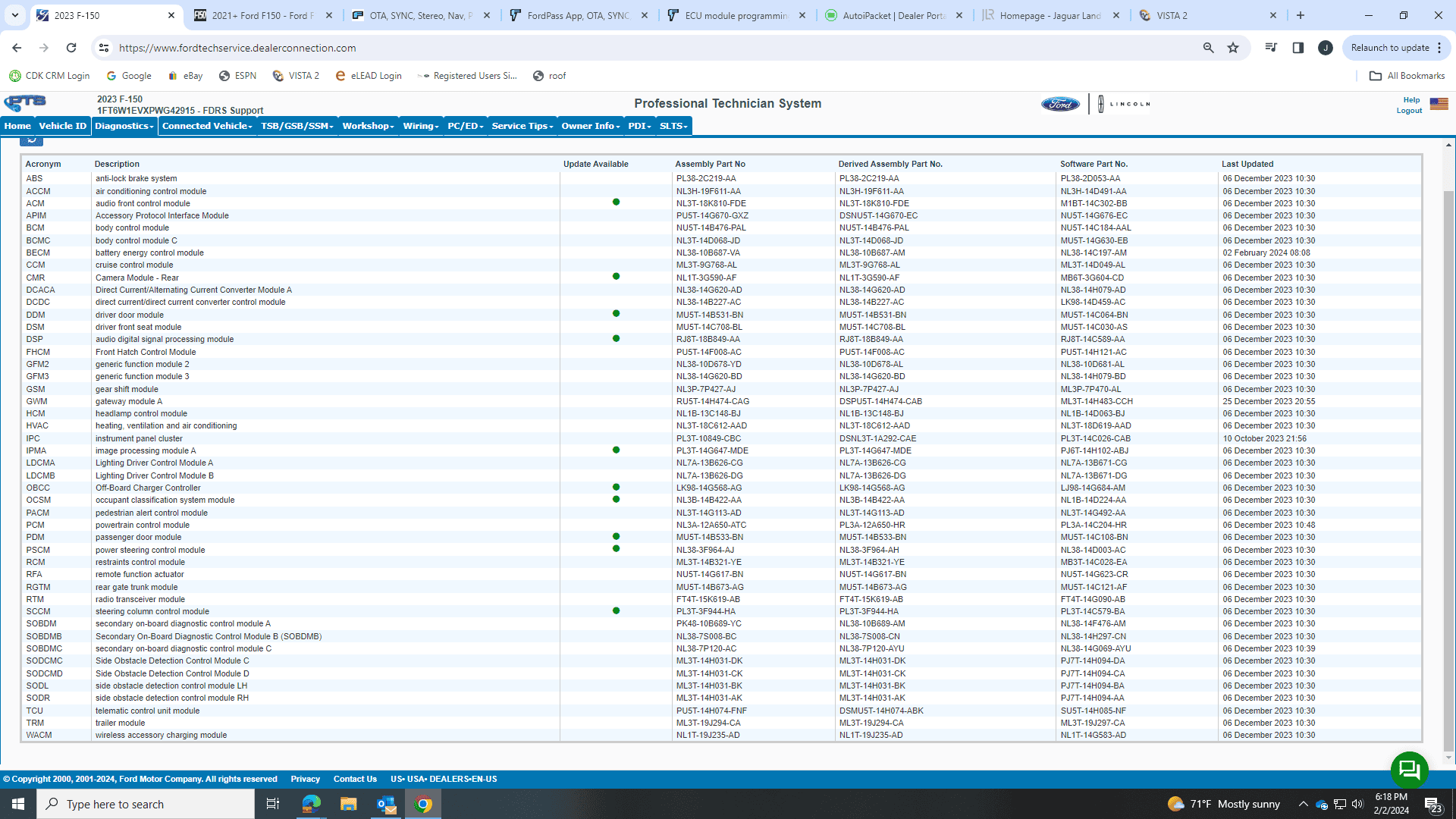

So I dropped my truck off for 23B57 and 23B70, along with an issue with a parking sensor. They told me that when doing the updates, it required other modules to be updated, and one of them failed to update and is now in failure mode needing replacement.
I'm curious what my update list looks like, if anyone has a moment, please; 1FT6W1EVXPWG42915
  • Sad
Reactions: GDN
rugedraw
Javier
Dec 14, 2021
1,773
2,133
Miami
Auto Sales
It got hung up while they were trying to update the IPMA. Same thing happened to a Mach E owner this week where the dealer got stuck updating the IPMA showing the same programming errors as your truck.
Modules pending updates are below:
Ford F-150 Lightning ECU module programming guide using FDRS 1706915942338
