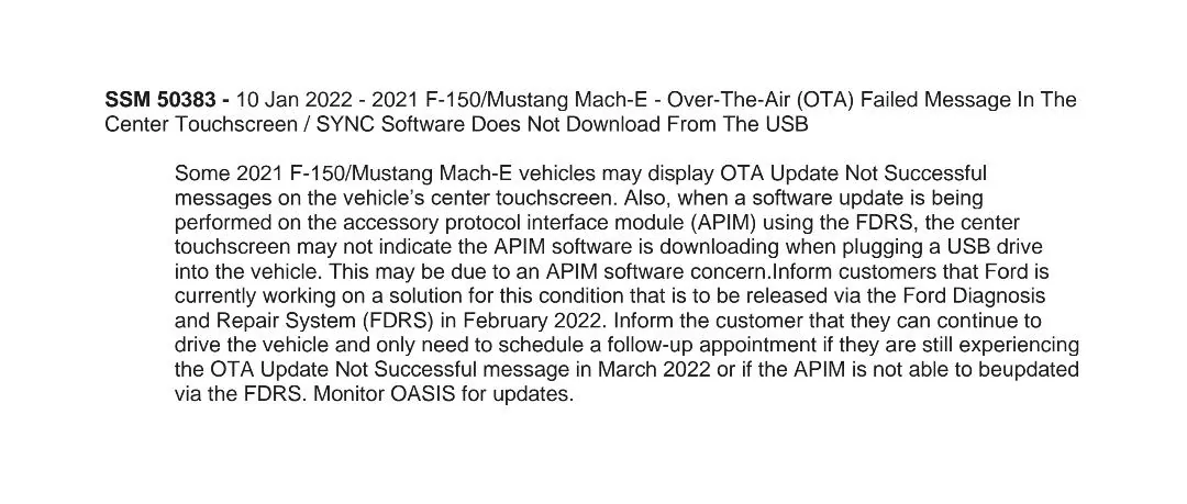

While burning yet another 30 minute wait I came across this: (another thread)
Ford F-150 Lightning ECU module programming guide using FDRS Screenshot_20220122-171142_Gallery
I said to myself "myself, that's ME"! I'm the guy with one of the trucks that fails the APIM update OTA, FRDS, USB.... Whatever. And the good news is Ford knows about it.

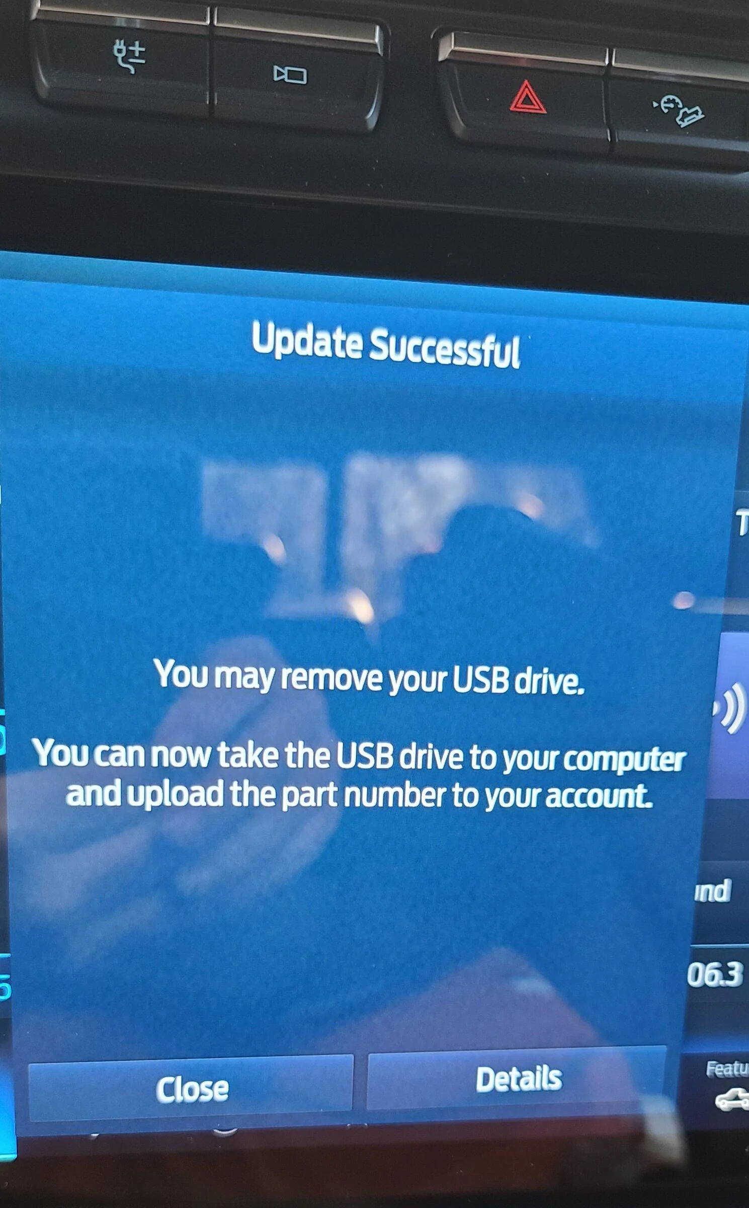

Ford F-150 Lightning ECU module programming guide using FDRS 20220122_153529
My USB stick was NOT in the truck!
I had already removed it when I shut the truck down.
I was stunned. So I immediately checked and :

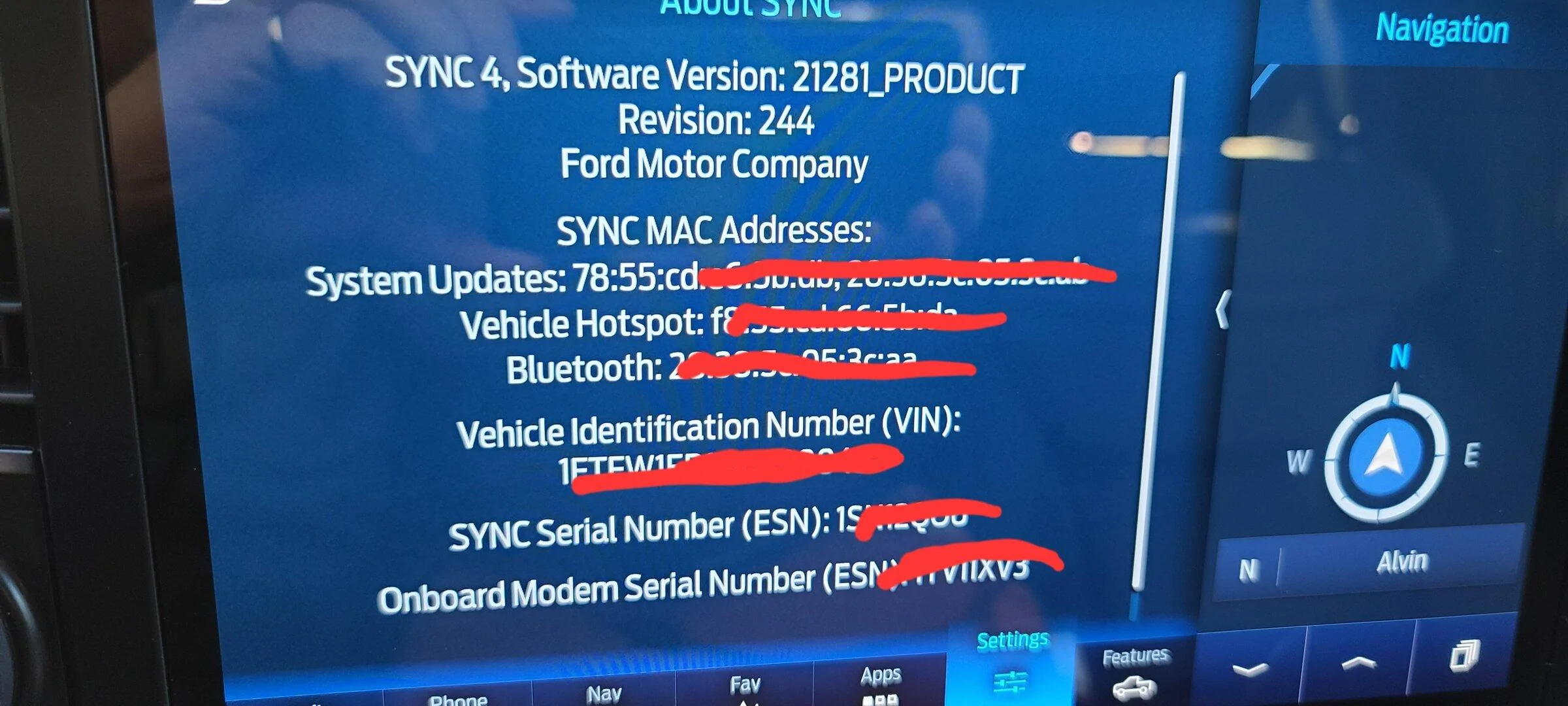

Ford F-150 Lightning ECU module programming guide using FDRS 20220122_152926
No longer 21146

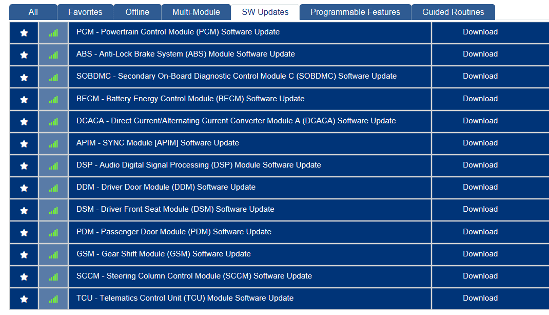

But, after the APIM finally succeeded, a fresh scan showed a new update available for the Gateway module!
Oh happy day. Lol
