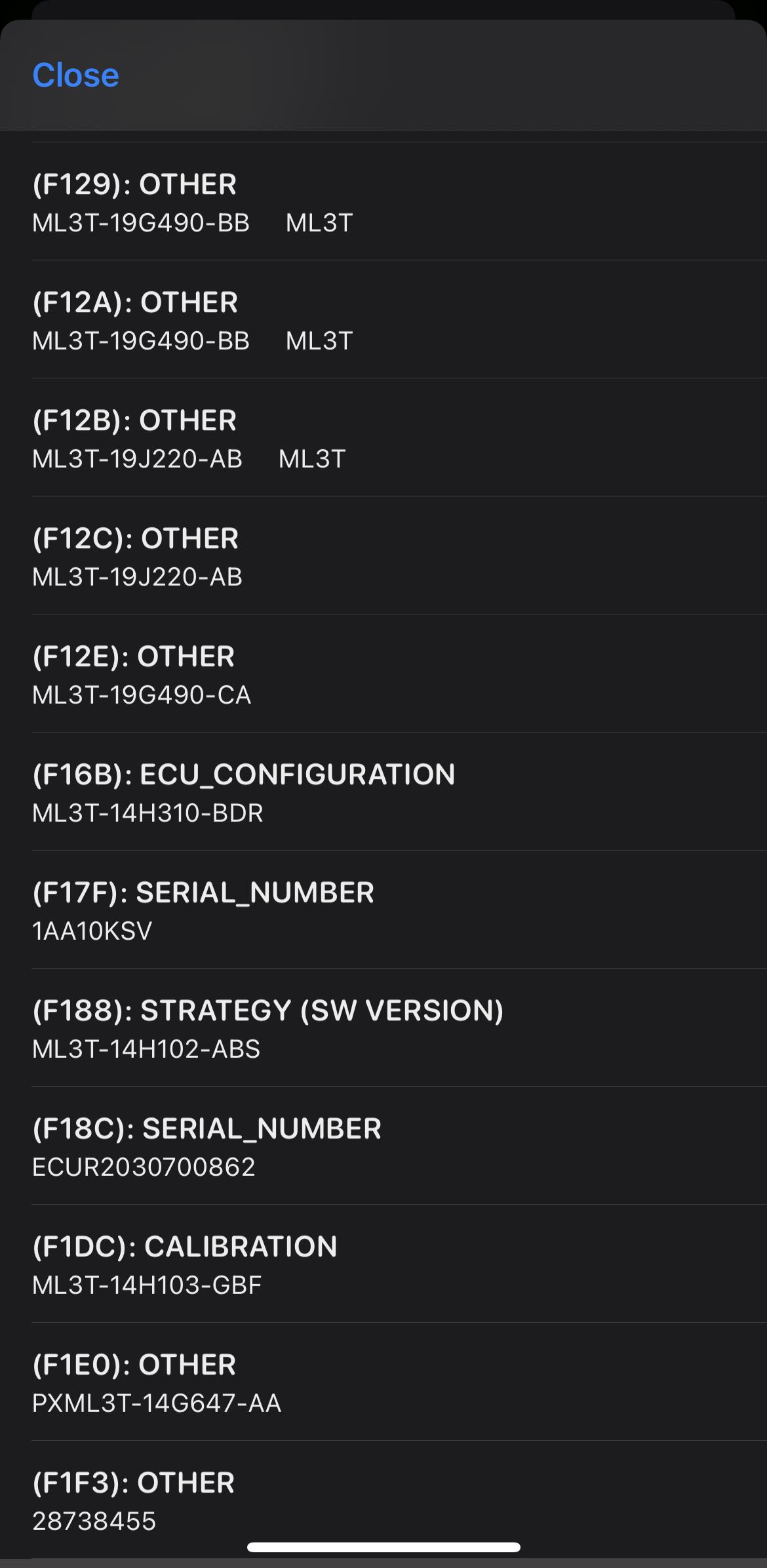

Iā€™m getting similar stuff this is my IPMA. So I need to fix this?
I have the same 3 marked as ā€œOtherā€ with the same values as you do. I used a Mongoose to update my modules so not sure what these mean or if theyā€™re corrupted. Iā€™ve tried multiple network scans and ope/close FDRS with no change.
Your AB data look rock solid. I don't see any corruption that is typical for the VCX Nano.
I do see those extra characters though you mentioned myself:

Not sure myself what those fields are. But I would not stress about it much. Besides that you look to be in good shape
Have you run the J2534 diagnostics? I responded to your earlier post about doing this.

Sorry, yes I ran all the diagnostics with the same result.
Ok. Thatā€™s good data. Iā€™m wondering if @tonesto7 ā€™s widget is doing something weird with these three nodes since @iceman77 isnā€™t finding any corruptions. As I said, these corruptions look less ā€œcorrupt.ā€

@icemann77 saw those values outside of the Ford Pass widget too. He said AB data looks good but isnā€™t sure what those values are or why theyā€™re the way they are. Some day weā€™ll figure out when these trucks do a scan and report by themselves to the mother ship but for now I guess we wait.
Maybe @Bob_Mac can check his module data. Iā€™m curious if heā€˜s seeing the same thing in these three nodes. Bob?
