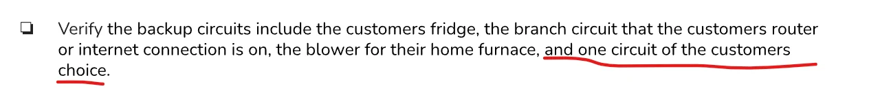

However, Sunrun has told me that their SOP is to break out just the circuits my wife and I deem as critical to a sub-sub-panel that is referred to in their documentation as the "backup panel" (BUP). When you look at their website setup literature, the requisite checklist sheet for backup loads testing allows for a panel that holds at most 12 household circuits:
https://sites.google.com/sunrun.com/sop/work-instructions/backup-loads-testing?authuser=0 (sign in with a Google account, see slide 12 by clicking on the slide number at the lower left)
Also, the required photo checklist for installation commissioning shows a panel with at most 12 breaker slots: https://sites.google.com/sunrun.com/sop/photo-checklists/ev-charger-system-checklists?authuser=0 (sign in with a Google account; see slide 20 in 2nd set of slides for EV Charger and HIS by clicking on slide number in the lower left of 1st slide)
I suggested to Sunrun that the truck with 9.2 to 9.6 kW output could easily back up our very low electrical usage if the dryer circuit were just removed from the sub-panel. If Sunrun were concerned about the ill-considered use of electricity drawing too much power from the truck, why not just put a 40-amp breaker in the HIS circuitry to the sub-panel? No response whatsoever from Sunrun so far on this suggestion.
I decided the ultimate bottom line would be the City of San Antonio electrical code inspectors. So, I spoke to a very helpful inspector on the phone today.
He suggested that putting load-dumping circuitry between the HIS and the sub-panel would be one way to have a "whole house backup" while protecting the truck from drawing too much current. He agreed that putting a 40-amp breaker in any acceptable place between the truck charger and the sub-panel would also do. But he said one of the most important elements of code inspection in San Antonio is whether or not the wiring scheme used meets the recommended wiring diagram of an OEM. He did suggest that if Sunrun wasn't willing to customize my installation, I should find another installer, but it seems that meeting the wiring setup recommended by the OEM is going to be a tough nut to crack. The inspector did say that all the Sunrun installations that he's inspected (presumably mostly solar panels) were well done.
I've forwarded the electrical inspector's comments to Sunrun, but they haven't responded yet. It does seem like with Sunrun that you're paying a lot but getting a little, at least in customizing an installation to fit a customer's electrical usage. Another complication that I didn't discuss with the inspector and perhaps the reason Sunrun doesn't employ the two overprotection ideas I'm considering is that both load dumping circuitry and big breakers can generate large transient voltage spikes, according to Internet articles. There might be a need to provide downstream surge suppression that might wear out eventually. So, if anyone has any good advice on any of the above for an electrical ignoramus, I'd much appreciate it.

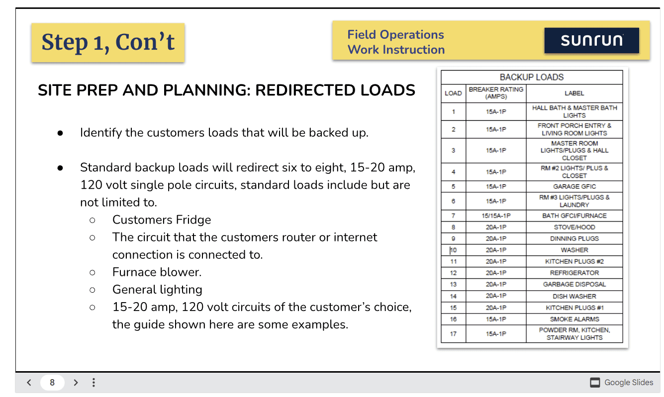

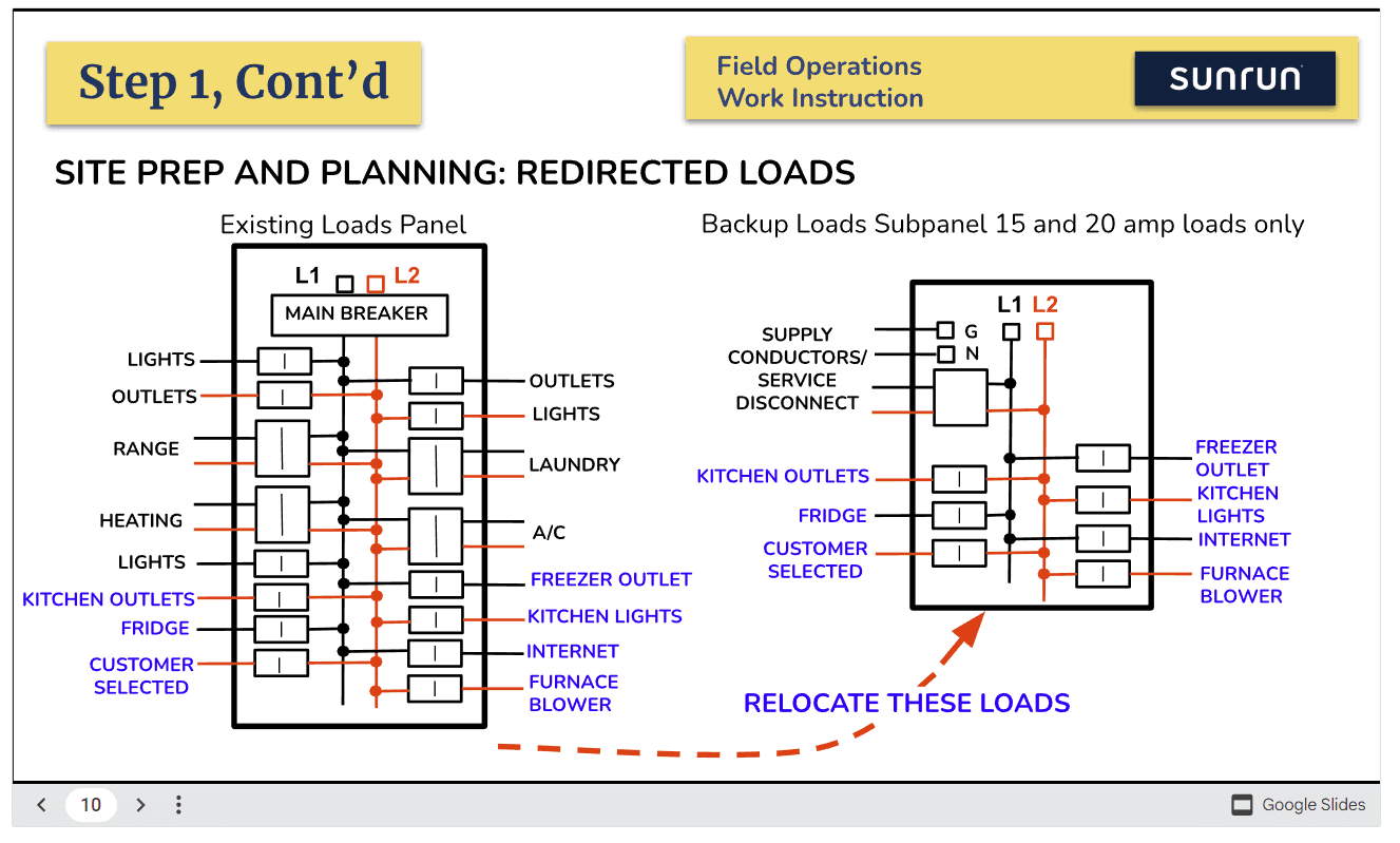

<<<sarcasm intended>>>: Sunrun's Field Website instructions on how to set up a "Whole Home Backup."
Slide 8 at https://sites.google.com/sunrun.com/sop/work-instructions/backupmicrogrid-circuits Click on slide # in the lower left to access a list of slides.
Ford F-150 Lightning Elderly Couple Disgruntled with Sunrun's "Whole Home Backup" Home Integration System 1676526513688
Diagram showing relocation of only a limited number of loads from Main Panel to Critical Loads Sub-Panel (slide 10 at same link as previous slide):
Ford F-150 Lightning Elderly Couple Disgruntled with Sunrun's "Whole Home Backup" Home Integration System 1676526675268
You're going to be in the dark in your bedroom and bathroom... What a joke! ?
And even better, from slide 16 in the same set! ?
Ford F-150 Lightning Elderly Couple Disgruntled with Sunrun's "Whole Home Backup" Home Integration System 1676527644917
