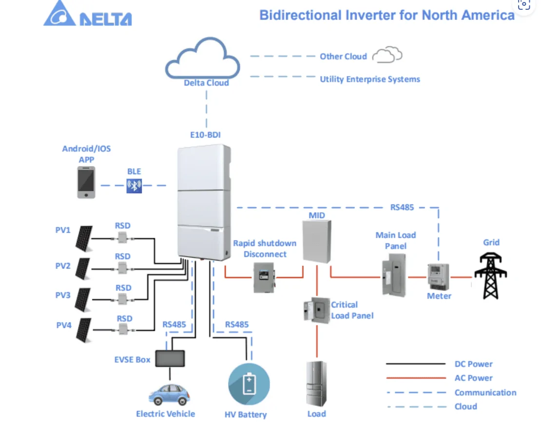

their Response was during back up, any energy generated from the truck will first go to any load on the BUP. any residual energy feeds back into the main. Hence whole home backup.
That would be great if it were true. But, for instance, here's a Delta circuit schematic for the whole shebang with photovoltaic input. The "critical load panel" is essentially the backup panel (BUP) or restricted loads panel. I don't see any provision for returning unused residual power to the main panel or any subpanel connected to it (but then I'm not very good at reading wiring diagrams or schematics). I imagine any other subpanels in a house are in parallel to the MID device and come off the main panel. They would not be backed up. Image copied from post: https://www.f150lightningforum.com/forum/threads/backup-power.11256/post-233552
The guy who posted the schematic just below refers to the "grid-only main load panel" in his post. Certainly doesn't sound like power feeding back to the main panel in an outage (and you can't let power from the microgrid go back into the power grid during an outage).

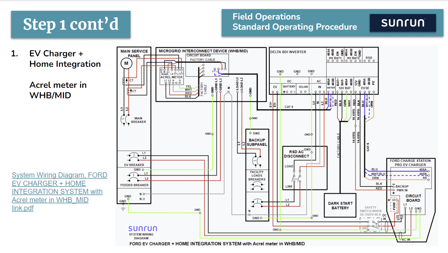

Here's Sunrun's official wiring diagram for the FCSP and HIS, with the Acrel Meter located in the MID/WHB box. If anyone can explain from the wiring diagram how the truck battery can really power the whole house, if circuits that are in what's termed the "Backup Subpanel" in the diagram don't have too much load, I'd appreciate the explanation. Slide 16: https://docs.google.com/presentatio...LiolTZo3G9TQms/edit#slide=id.g12cfb4a2f85_0_0 when you're logged onto the Sunrun Field Website thru a Google account: Field Website - Ford EV Charger (google.com) ).
Ford F-150 Lightning Elderly Couple Disgruntled with Sunrun's "Whole Home Backup" Home Integration System 1676444814770
I'll also ask Sunrun myself for a more precise, technical explanation of how the "Whole Home Backup" setup actually works.
