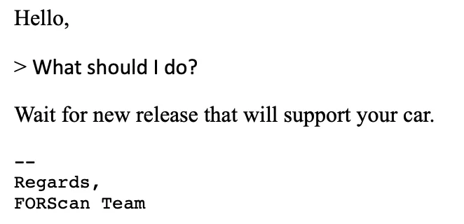

Anyone able to connect Forscan to a MY2023? Mine says "Unable to identify the vehicle" and asks for the PCM part number. This is with Forscan v2.3.49.
Forscan responded saying I needed to wait for a new release.

Shoot Forscan support an email and they will send it to you.
Update, they sent me the v2.3.50 test version and it wrote to HCM first try.
