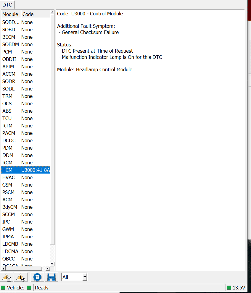

I did notice that the HCM is now throwing DTC for "General Checksum Failure" which is lighting the MIL.
Code:
Code: U3000 - Control Module
Additional Fault Symptom:
- General Checksum Failure
Status:
- DTC Present at Time of Request
- Malfunction Indicator Lamp is On for this DTC
Module: Headlamp Control Module
Clearing DTC's doesn't work - it just comes right back...

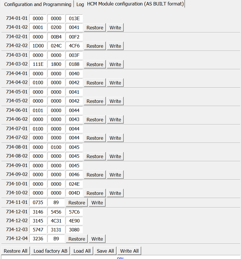

Hey @vandy1981, I did some more experimenting tonight and found the working glare-free settings from scratch.
See https://www.f150lightningforum.com/forum/threads/lightning-forscan-hcm-spreadsheet.11807/post-248344 for the post.
Here is the proper HCM recipe for a new truck:
734-01-02 xxxx x2xx xx-- (CAF ADB_GfHB)
734-03-02 xxxx xxxx x1-- (ADBDBL ADB/DBL Combined)
734-11-01 0735 89
Then you have to check to make sure there aren't any checksum DTC's set for the HCM - that will prevent glare-free and bendy beams from working.

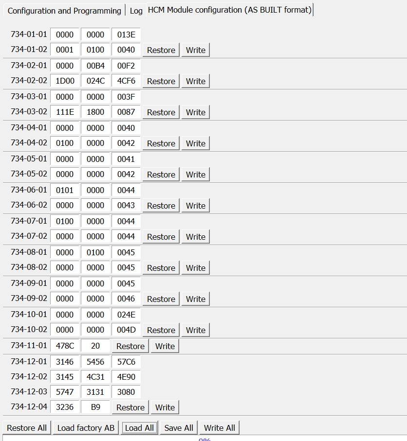

So I tried to enable the glare free settings again hoping that I could get it to work or possibly messed it up last time. Still no luck for me. I keep getting a DTC on the HCM. I screen shot what I'm getting if someone could help. Thanks in advance.
Stock As Built HCM
Ford F-150 Lightning F150 Lightning FORscan thread Stock As Built
Modded for Glare Free with DTC
Ford F-150 Lightning F150 Lightning FORscan thread With Glare Free DTC
HCM DTC
Ford F-150 Lightning F150 Lightning FORscan thread DTC

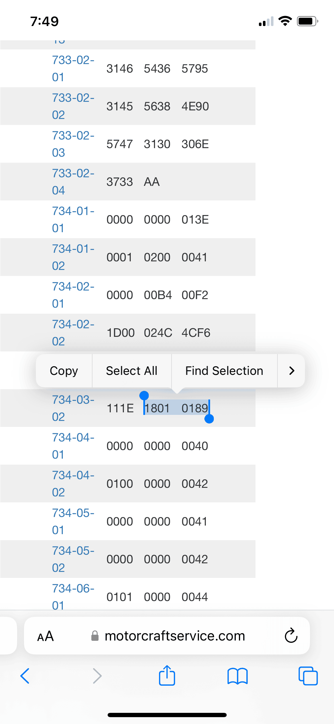

Small update. I found a vin from our reservation and orders thread that was from Canada with a base XLT. Pulling there as built data I compared to what I had above. The only difference is the below value. The “1” in the 1801 is for zone lighting which shouldn’t apply since I don’t have it.
Ford F-150 Lightning F150 Lightning FORscan thread 541999CC-FD9E-40B9-915B-6DABB7E3D490
After updating this value on my truck the error on the HCM went away. Now I need to find sometime without rain to drive the truck and test it.
