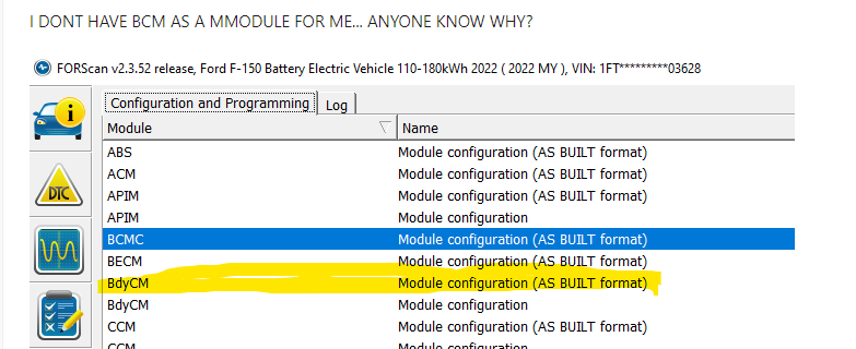

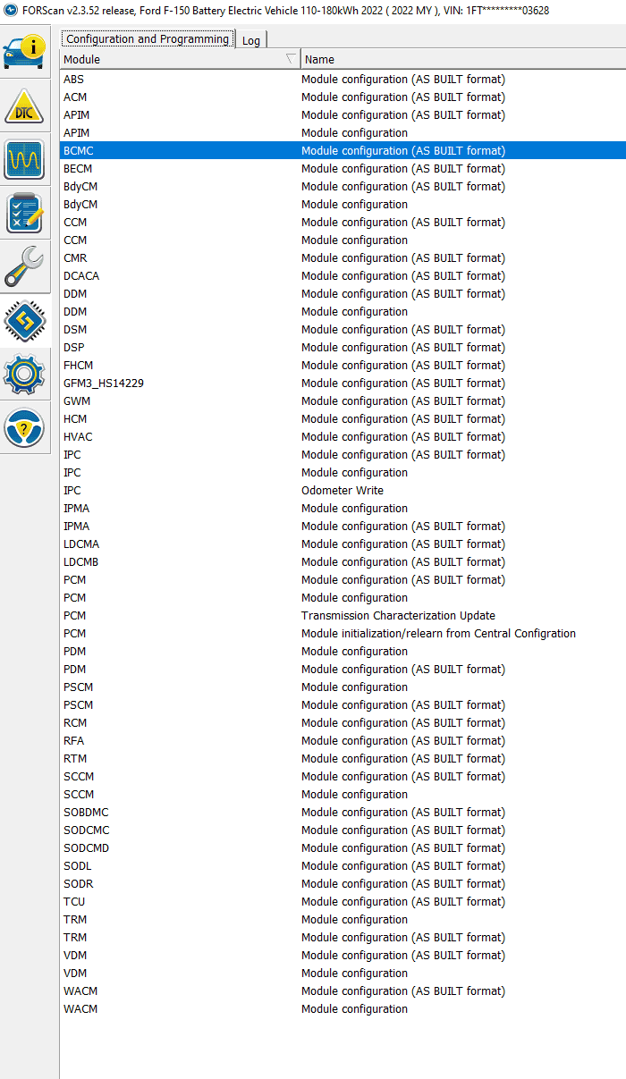

I DONT HAVE BCM AS A MMODULE FOR ME... ANYONE KNOW WHY?
