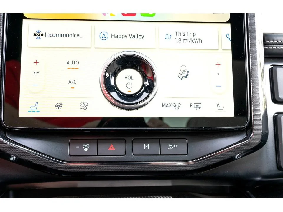

For Sync 4a (15in): Has anyone tried to found a way to manipulate the climate control buttons? I’d like to display both Heated and Ventilated Seat icons for selection.
Ford F-150 Lightning F150 Lightning FORscan thread 1685652870389
I don’t like clicking on the singular seat icon because it defaults to seat heat rather than waiting for a selection to be made. Why kick on the relay unnecessarily? Honestly, Ford needs to figure out their UI design, it wastes a ton of usable space and it’s clunky / inconsistent.

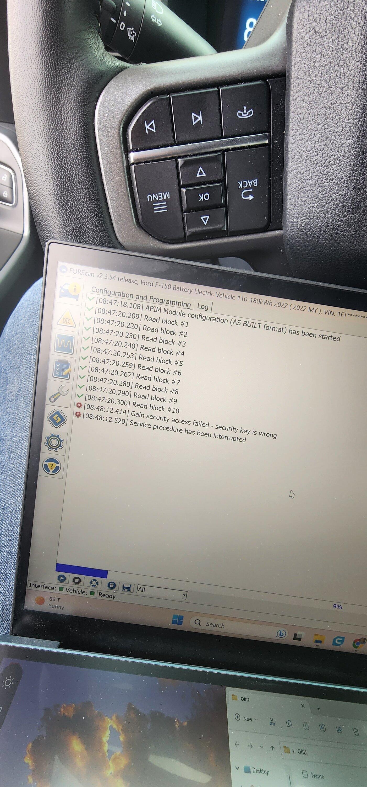

Yesterday I changed the front light bar brightness and all was fine. Seemed to take with no issues.
Then a few hours later I tried to change the matrix headlights. I got a error code on forscan and thought maybe something was wrong with my p.c. or obd adapter and put it all away last night.
So today I did it again and I'm still getting the same error. Anyone with experience have any advice ? Take a look at this screen shot
Also see a DTC now that the APIM module wasn't responding.

Did you actually notice any difference with the lightbar brightness ? I tried it months ago and didn’t notice any change at all
