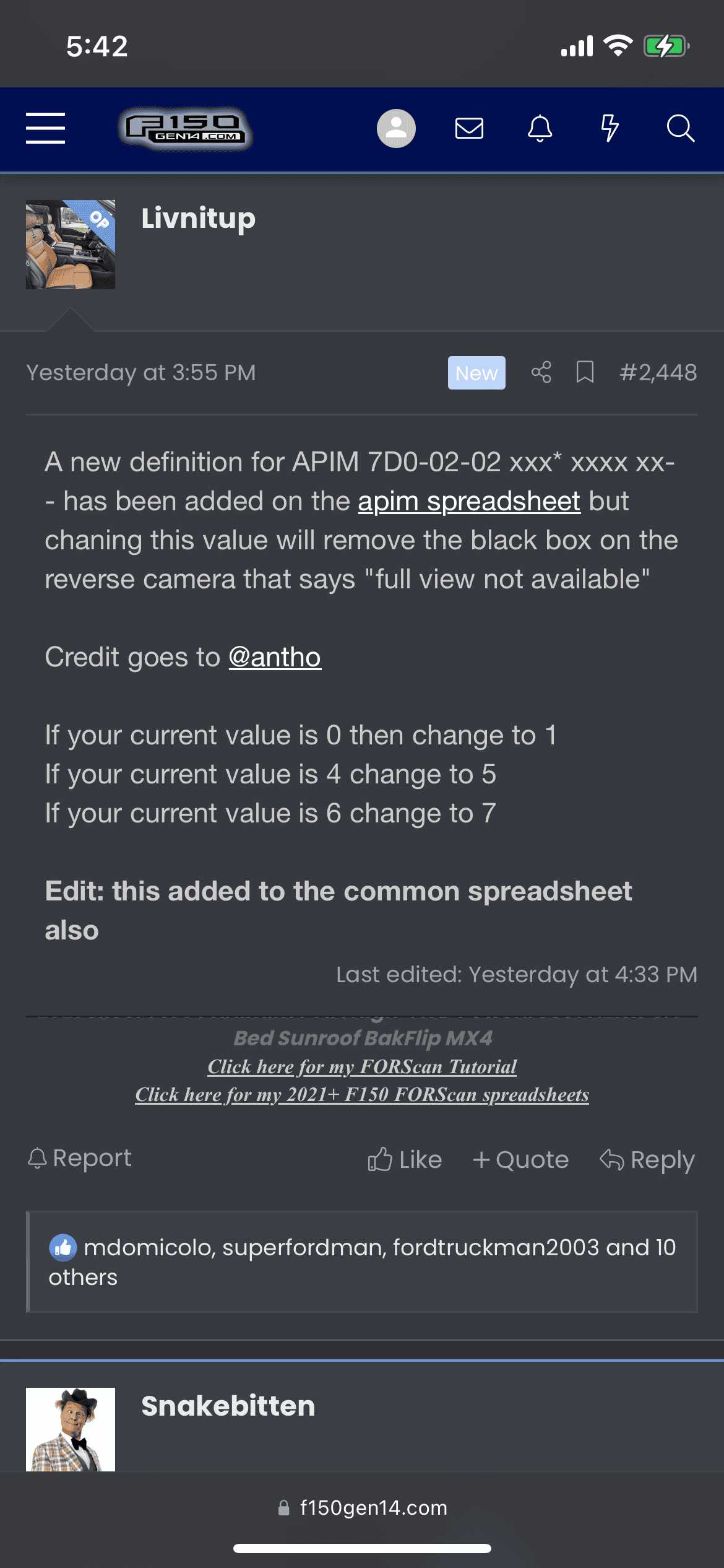

Just saw there were some new updates to the Forscan excel sheet. I haven’t been able to test them yet but knew there would be some interest.
Remove "full view not available"

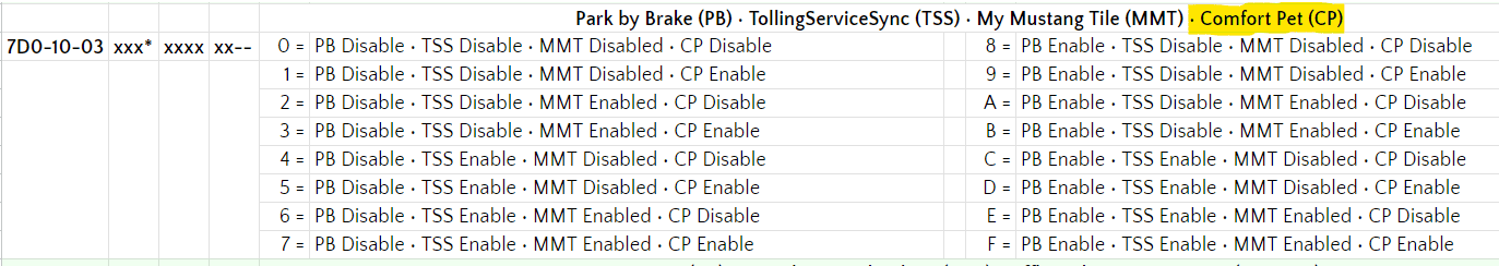

Pet mode?
Have you tried enabling the "Comfort Pet (CP)" option?

I haven’t. I don’t take my dog or kids anywhere and leave them in the truck.
