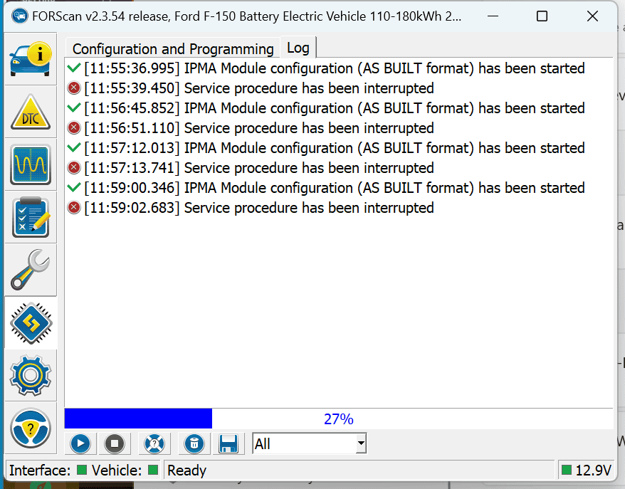

Anyone else having problems loading the IPMA As Built? When I try to load it, it gets to 27% and stops with an error message. IPMA (not As Built) will load up just fine.
not sure what adapter you are using to go from the computer to the truck but some adapters work and some don't.
I was getting this exact same error at 27% on the IPMA module. That was using my Veepeak OBD Bluetooth adapter with my laptop. Switched to my OBD USB wired adapter and problem solved. I think the IPMA module is the most data intensive and overwhelms the BT adapter.

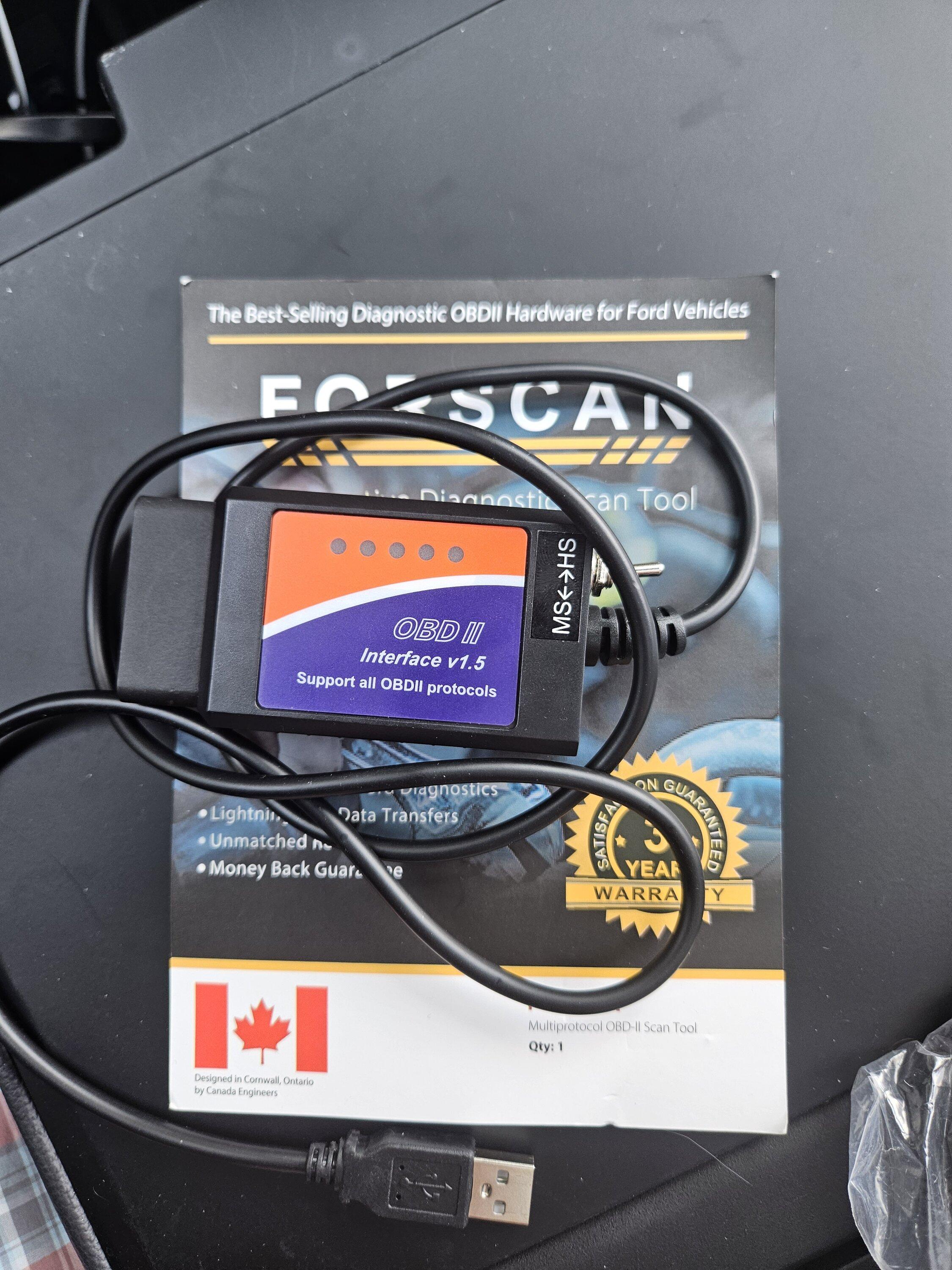

I was using the recommended wired adaptor
Ford F-150 Lightning F150 Lightning FORscan thread 20230625_111024
I just bought the newest recommended Bluetooth adaptor and will try it this weekend.
I don't know what to say other than we both erred out at 27% I'm guessing it's an adapter problem because mine works flawlessly with my USB adapter.
Same as you the not as built IPMA module loaded just fine on the cheap Veetek BT adapter.
This is my USB adapter. I believe it's recommend by Forscan as well.

If the new adapter doesn't work on IPMA, I will immediately order that adapter.
