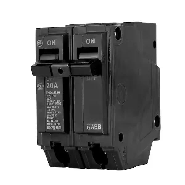

The best “cheap” install that would get you is a Level 2 at 16 amps. That requires a 12 awg “romex” wire and a twin 20 amp breakers with the joiner bar. This arrangement can be in a single breaker slot configuration if you have a limited breaker box, but you will have to tandem the adjacent 120v lines to free up a spot. You would run a NEMA 6-20R receptacle.

The best “cheap” install that would get you is a Level 2 at 16 amps. That requires a 12 awg “romex” wire and a twin 20 amp breakers with the joiner bar. This arrangement can be in a single breaker slot configuration if you have a limited breaker box. You would run a NEMA 6-20R receptacle.

Most modern panels cannot get a 240V circuit form a single tamden breaker. The design only has access to one bus.

It is always ideal to take from both phases, but you can pull both 20 amp “phases” from a single bus. Not all panels are a split bus approach, so it happens more than most know it even with a double pole breaker.
90% of panels sold today are either Schneider, Eaton, GE, or Siemens. Not possible on any of them.
This isn’t actually correct. It “is” possible on these panels to insert a double pole breaker.
On a GE panel, for example, you can install up to 50A double pole “mini” breaker. If you use install this as “normally” done, by default the breaker would pull power on both legs from the same bus, giving you just 120v. Not what you want! Instead, you have to install the breaker so that it is half way in one slot and half way in the adjacent slot, thus shifting the breaker to pull from 2 different bus bars.
This works and it perfectly safe (electrically).
