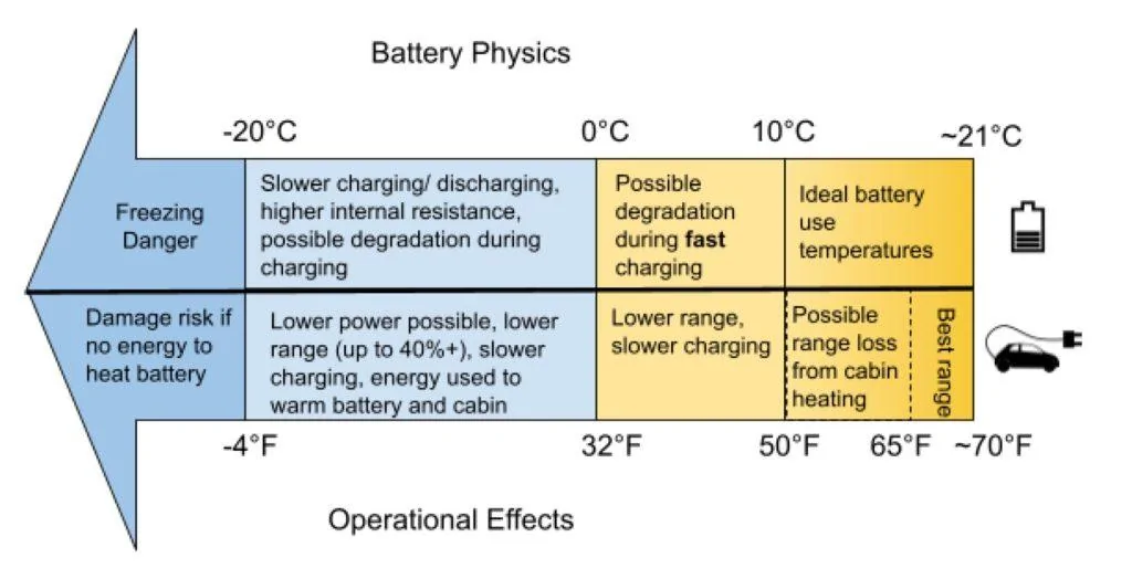

What does the term extreme weather conditions mean exactly?
"How Extreme Weather Affects an Electric Car's Battery. Very cold or hot weather—generally defined as below 20 degrees or above 95 degrees Fahrenheit, according to AAA —can cause a drop in EV range."
https://www.pcmag.com/how-to/extrem...ic-vehicles-handle-super-hot-and-cold-weather
"All electric cars experience some degree of range loss in cold weather. For EV owners in colder winter climates, like northern portions of the United States, daily driving and charging behaviors must be adjusted in these months.
That’s the bad news. The good news is that this range loss is temporary and there is no long term detriment to your battery. As the ice melts and the temperatures rise, your vehicle’s expected range at full charge should return to normal. "
https://www.recurrentauto.com/research/winter-ev-range-loss
One clarification to that last article is the Nissan Leaf has a battery warmer that kicks in before the battery reaches a cold temperature that could lead to damage, very unlikely. The battery temperature would have to get very very cold to cause damage.
Li batteries suffer permanent damage below -4 degrees F (-20C).
Damage to an EV battery can occur when the battery gets above 104 degrees F (40C).
"Starting at about 40 °C (104 °F), irreversible damage to the battery can occur.
Between 70 and 100 °C, thermal runaway can begin causing a chain reaction that destroys the cell and spreads to adjacent cells, eventually destroying the entire pack."
https://www.batterypowertips.com/ev-battery-thermal-management-challenges-faq/

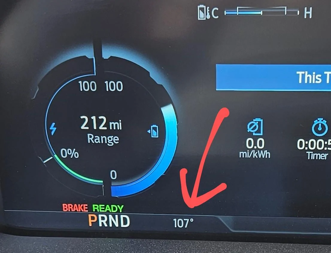

I'm well aware that the truck will cool itself even while not plugged in. The point I was trying to make is in regards to the notion that plugging in the truck every day is bad, which is misleading.
2,223
2,337
Temp when I left work yesterday, thankfully my garage only gets morning sun.
