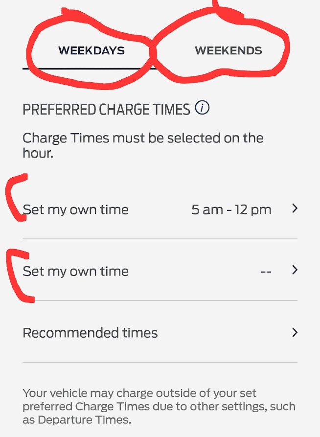

Make sure the time frame settings cover both weekdays and weekends schedules, set my own time on the first line, and optionally use the second charge time frame just below if needed, my example does not use multiple charging schemes per day.

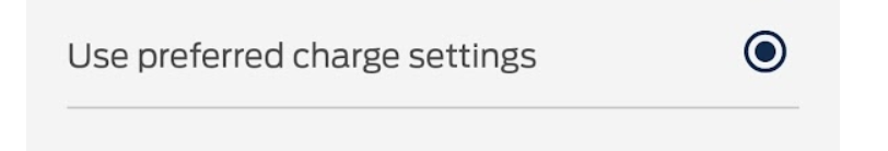

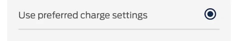

Make sure you've selected the "Use preferred charge settings"

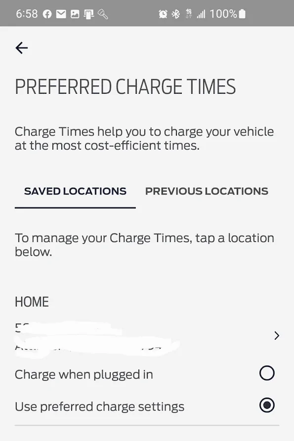

OK this is my official "Whoops" statement. I went out and checked the settings under preferred locations and my times and charge levels were there. For giggles I changed the % of charge from 85% to 90% and wala in about 15 seconds it changed on Sync 4. So the FCSP is just a big dumb charger. I guess when we go on vacation or leave home, Ill have to kill power to it at the breaker.
