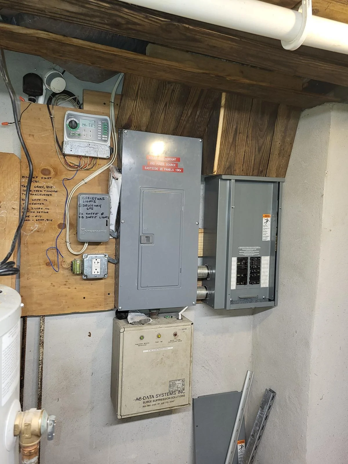

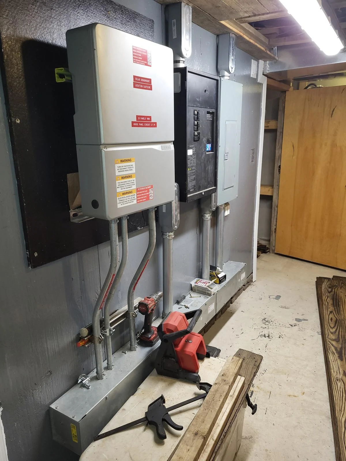

Site survey from Tesla is in the works for PW3 ,I had to install a 100amp fireman disconnect switch to to disconnect Tesla subpanel inside gateway.

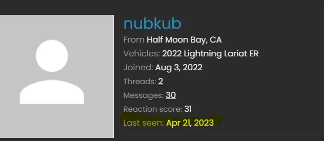

Still no word from (nubkub)

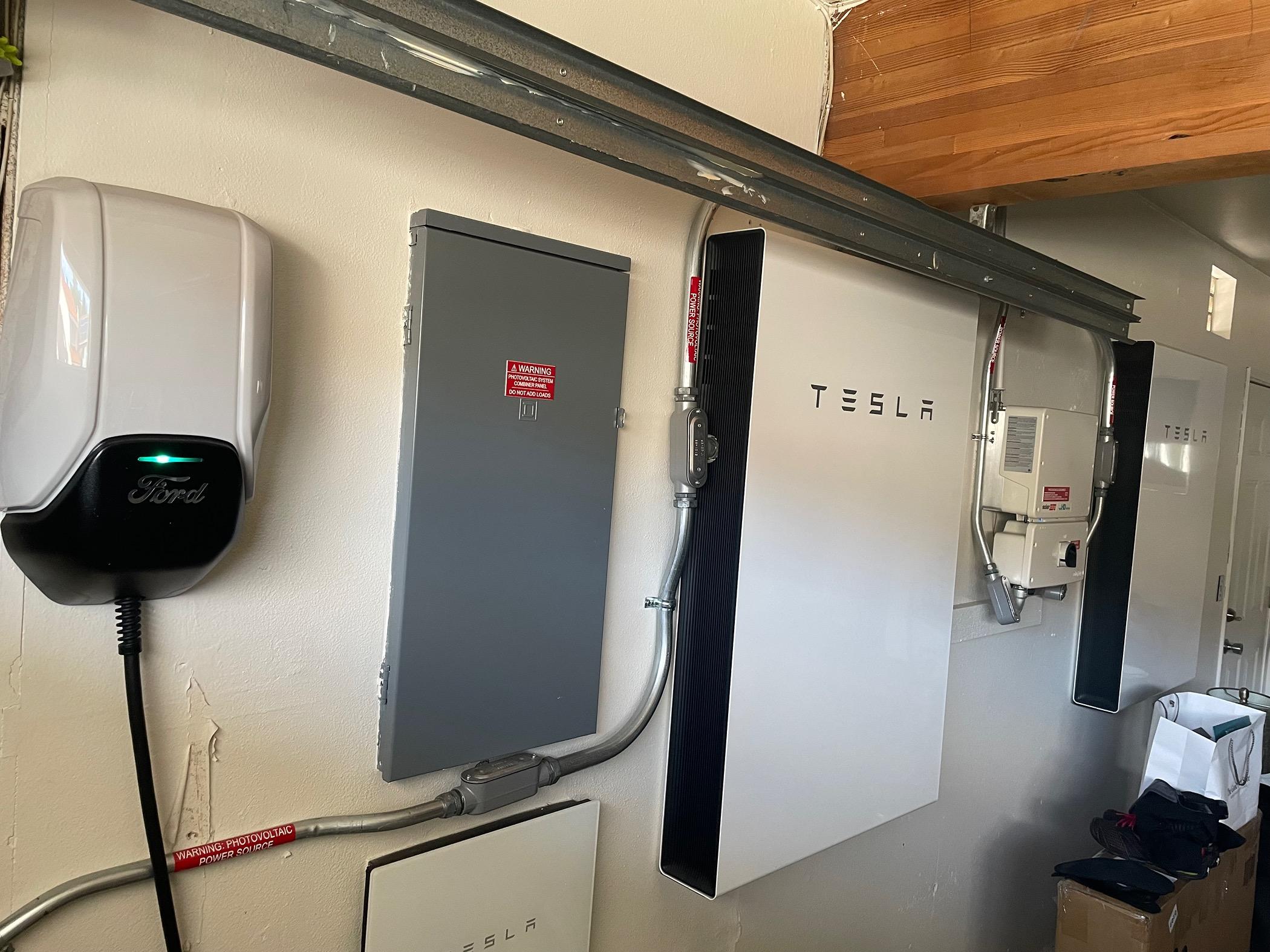

Here you go. All work done using local people. Tesla did not have anything to do with the install. New main panel. New sub panel for 20 circuits protected by the new PowerWall. SunRun sucks but we are installed and working as expected

I'm in final approval with my set up
I'm going back and forth with Telsa and telsa certified contractor.
The electrical contractor(local) guy is awesome but Tesla ( California) needs to get out of the office and see the real word construction.

Great install! I like how you covered up all the wires to the gateway and sort of recessed the cans.
Do you have any pics of the charger wies connected to the PW?
Did they use the DC wires from the charger?
Is there a communication wire from charger to gateway?
