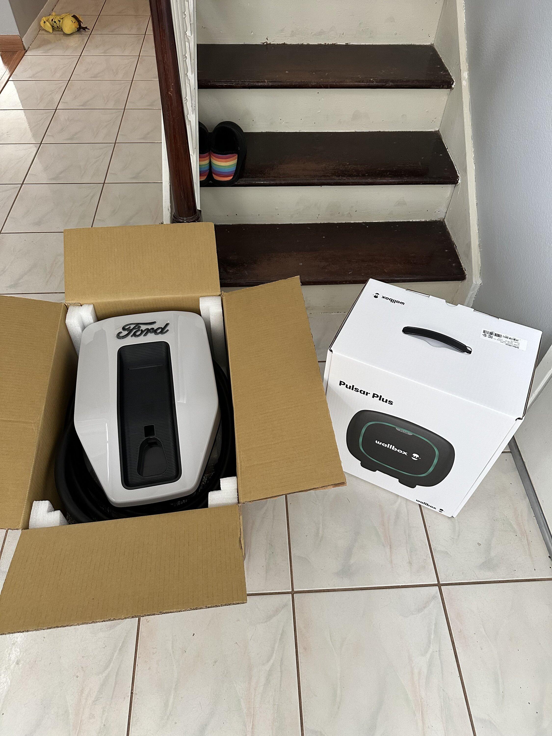

So I got my Extended Range Lightning XLT last week and the dealership sent me home with a Wallbox Pulsar Plus charger. Then today I got a package from SunRun with a Ford Station Pro unexpectedly. I just read online that ER models come with the Ford Station Pro, the dealership never mentioned this and I wasn’t aware, so seems odd they also gave me the Wallbox. Obviously, not complaining, just glad I didn’t already pay someone to install the Wallbox. May sell it or install it at work. Out of curiosity, anyone else have this happen?
If I had a serious question for the community, anyone use the Ford Station Pro to charge a non Ford EV? We also have an Ioniq 5, I assume it’ll charge it without a problem, but wanted to make sure.

Do you have a 100A circuit available? If so, choose the Ford unit, which will charge your ER at 80A. If you don't have panel capacity for 100A there's no real advantage to the Ford unit, and I'd advise selling that one and installing the Pulsar, which will charge both (likely at 40A or 48A on a 50A or 60A breaker respectively). The Ford unit has an 'extra' set of pins for the Home Integration System (that nobody seems to like and is really expensive) so you may need an adaptor to get it to fit the Ioniq. Congrats on the truck and bonus charger!

The fcsp comes included with ER versions and was shipped by Sunrun automatically.
It can be configured to fit almost any panel as it has internal hardware setting to reduce the amperage, mine is set for 48a on a 60a breaker and it works great.
Your dealer must have had some promotion for the wallbox.
The wallbox is rated for 40a and looks like it uses a nema plug.
Personally, I would install the fcsp and keep the wallbox as a backup/2nd location charger.

The Wallbox must be a dealer promotion. It didn’t come from Ford.

I have a wallbox plus that looks just like the one pictured above. It charges up to 48 AMPS
The app has been flawless. I’d recommend it to anyone.
You’ll need to check the sticker to see if you have the 40 or 48 AMP version
Ah, I thought it was the plug version. Either way, good choice! I'd still keep both.

Unless you really want/need to charge at 80 Amps or want to install the extra hardware for home power backup, the Ford Charger isn't worth it. It's known to be a bit flakey at times and it does not play nice with certain EVs that don't have a CCS charge port. It's essentially impossible to charge an EV or PHEV that only has a J1772 port and a Tesla needs you to modify a J1772 adapter to fit the CCS...
If that is the 48A capable version of the Wallbox, install that one and sell the Ford unit. The Wallbox can be direct wired and they're good chargers.
