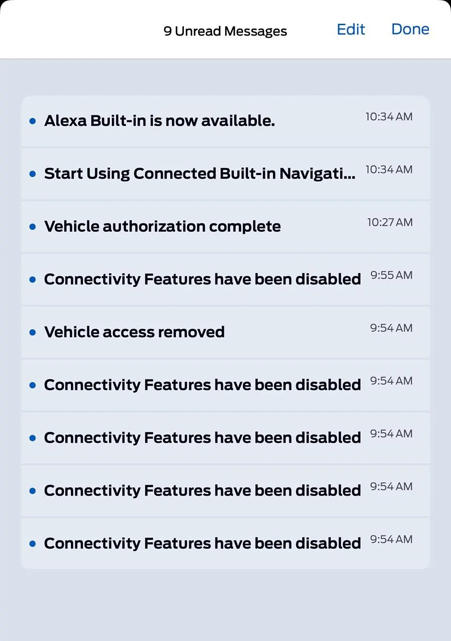

Yesterday I pulling in from work and plugged in like every other day and a couple of hours later I looked at my ford pass to see the charge level and it did not show charging and was at 67% 239km. I went out and the truck was plugged in and the lights next to the plug showed mostly charged. I unplugged and plugged in again and still nothing on ford pass. I left it. I normally chrarge to 90%. I started it up today and it charged to 100% but still no movement or connection to ford pass and still 67% other than showing parked. I have not received an update on the truck since the 18th and everything was fine past that. I logged on to the ford web site and the truck show 87% charged and 238km range , wrong as well. When I drove to another location it still show the truck at home.
Any ideas on what I should do?
The truck seems to have reset. All of a sudden I received a bunch of notifications from the FordPass app that I was disconnected and now it made me reconnect the truck and looks like it’s working.
