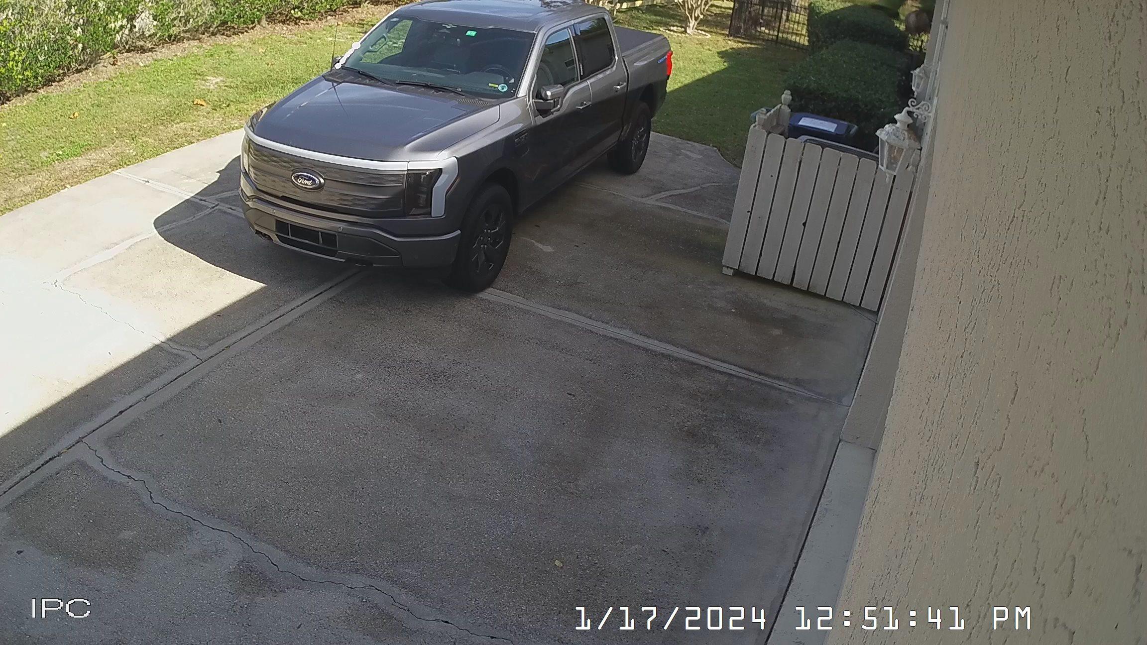

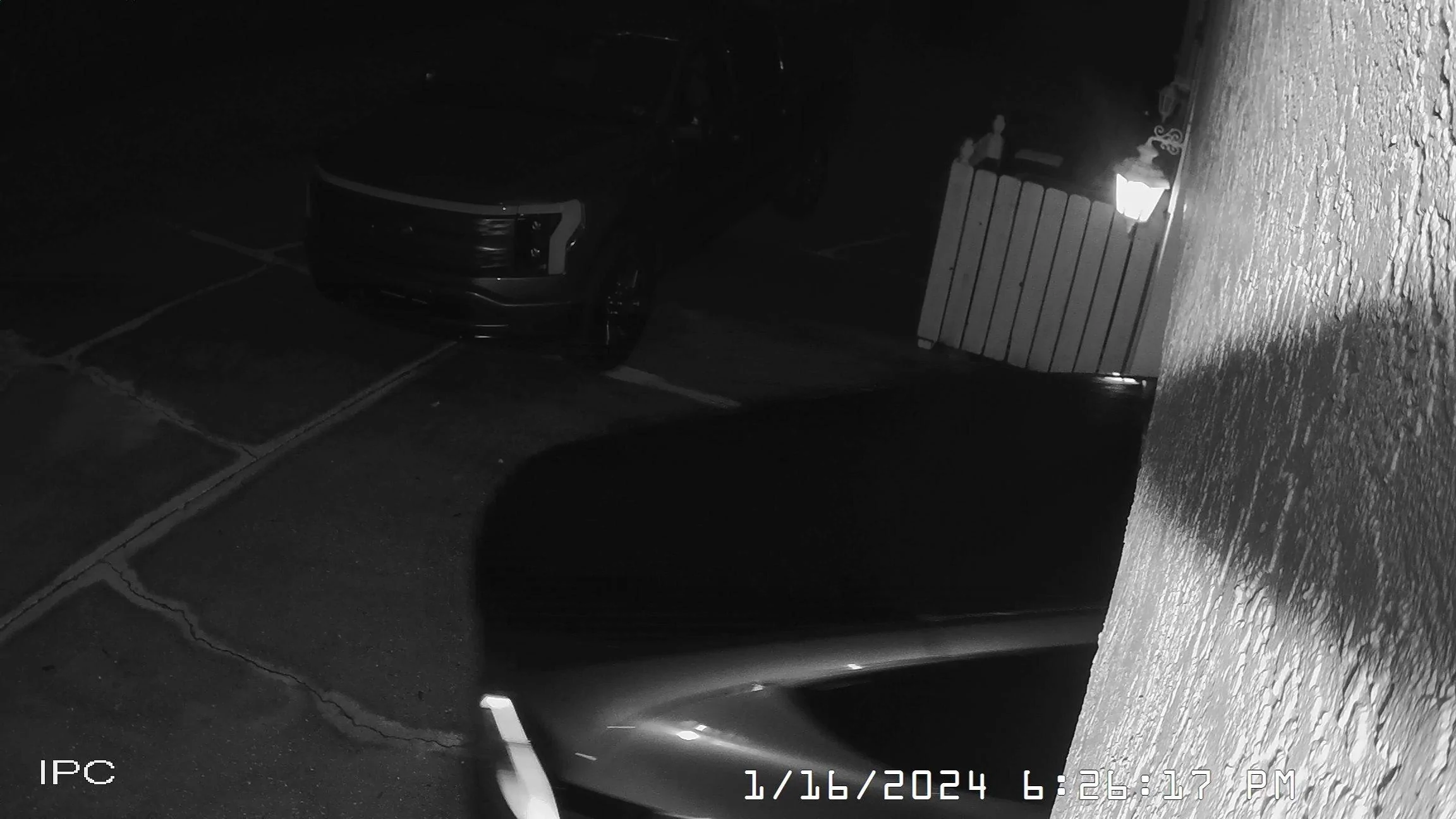

Security camera shows we pulled other car into the garage at 6:26PM and the Fronk was closed. No other motion detected overnight. Motion lights were not activated so no one approached the truck between 6:30 p when the fronk was closed and this morning when it was found open.
Only reasonable explanation was for some reason when my iphone was within Bluetooth range I accidentally held the fronk open "button" on my iphone. That is unlikely since I didn't go outside after 6:26 pm. Perhaps when I removed the iphone after parking the Tesla in the garage I held the "button".
Still it's a mystery.
