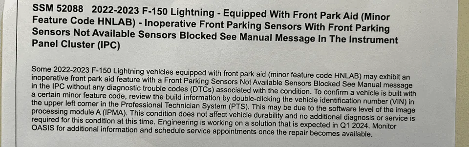

Me three. Brand new Lightning this week and I have left rear sensor and front right sensor doing the same thing with the same ‘parking sensor blocked’ error message. Dealer told me I’d need to leave it with them for a few days. I’ll share any feedback I get once they fix the issue
Houston dealer said they had 4 new Lightnings in with the same issue. They replaced the sensor for me (it took a few days cuz they need to paint sensor) and it has been working correctly since

Dealer had my Lariat for 3 days. Did some sort of reset and it didn't give the blocked sensor error for a day, now back. Dealer said the would have a fix in early 2024. Very annoying. I bought this one off the lot because the one I ordered and waited on for months came with a bad heater relay that had no fix in sight. This whilst my Raptor R in shop for yet another recall where they are replacing several oil seals that require engine breakdown. Not sure why I remain a loyal Ford fan. Getting very close to giving up on them.

I'd be interested in what the Dealer said the fix would be in early 2024. It took the dealer 3 days to replaced my sensor LU5Z*15K859*ACA and touch-up paint. The work order said they performed BCE diagnosis and found DTC B1B48:96 left rear outer sensor component failure.
The thing is, like your dealer reset, the fix worked for 1 day before the 'parking sensor blocked' error came back. On the bright side, it only seems to be acting up 1/2 the time now, instead of every time i put the truck in reverse. I'm bringing it again on monday so Ford can try to troubleshoot.

Could be a parts thing. I took mine in for a fix and they told me that they are waiting on parts to replace the sensors. We're going on two weeks now

Please share if the dealer finds a fix. I bought an ER Lariat in Nov 2023 and have the same issue. The dealer replaced the sensor but the error came back. I found this link on Reddit which is stating it is a software issue "Front Parking Sensors Not Available Sensor Blocked See Manual" - Fix is expected Q1 2024 : r/F150Lightning (reddit.com)

Thank you for this. My assumption at the time was that it was software.
As I wait for replacement sensors to arrive at the dealer, I've started to get more errors but for a different front sensor
