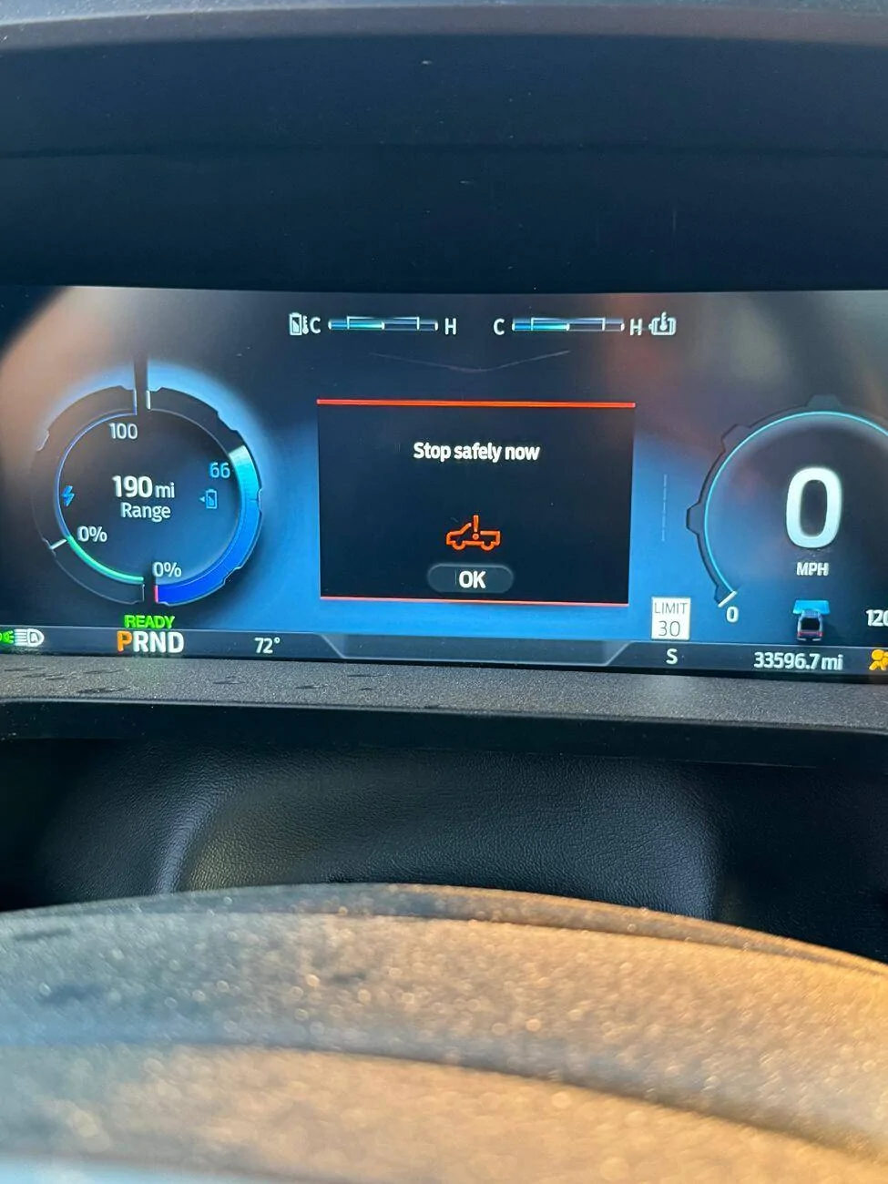

Fast forward to the evening of Friday, September 20th, when the truck flashed an urgent message to Stop Driving and pull the vehicle over safely. The truck threw another High-Voltage Battery Warning, stating that an electrical system fault was detected and the vehicle may shut down without further warning. I followed the instructions, pulled over, shut the truck off, and waited for a few minutes. I then re-started the truck and the same fault remained on the dash. I drove the truck the short distance home and shut it off. Yes, in retrospect that was probably not smart, but that is the fundamental issue. Am I supposed to just strand the vehicle on the side of the road and find a ride every time this happens?
In the morning, the fault code was gone, but so is my faith that my truck is reliable. I called the dealership at 9:00am on Saturday, September 21st, spoke with a service representative, and left an urgent message with the service manager. It is now Sunday morning and no one has returned my call. I am left wondering what to do. Is my truck safe? Can I drive it? I need to get to the school on Monday - can anyone help me and give me advice?

Update as of 10/2/2024: Dropped the truck off at a different dealership across town (about an hour away from our house) following another "Stop Safely Now" and "High Voltage Battery Warning" alert about a week after the first. (No response from the original dealership who attempted the repair after 4 voicemail messages and 2 texts describing the problem). Last week, the truck also threw a fault of Inoperative Front Camera as well as an alert that the Pro Power Onboard Reserve level was met even though there were still 173 miles of range showing as remaining.
I initiated a buyback request from Ford, since this truck has had electrical issues since about a week after we got it and has not been successfully repaired after numerous attempts and 3 1/2 months sitting at the dealership. Ford denied my buyback request because we have had the truck for over a year.
Yesterday when we dropped the truck off at the dealership, we were told they would need to recreate the fault in order to try to figure out what was happening, even though they could clearly see the history of faults when they viewed the truck's history on the computer. Meaning, they would have to drive it around until the fault triggered again and then read the codes while they were still active. No estimation on the length of time this could take or even if it will be possible to recreate the fault or complete the repair.
Meanwhile, we were also told that when the Stop Safely Now alert triggers, the truck can suddenly stop in place. . . meaning that without warning, the wheels will completely lock in place and not roll - leaving the truck stranded wherever the wheels locked with no ability to even roll the truck to the side of the road. Envision this happening in the middle of a highway!! This, to me, means that the truck is definitely not safe to drive and is certainly not reliable.
Has anyone else had these issues?

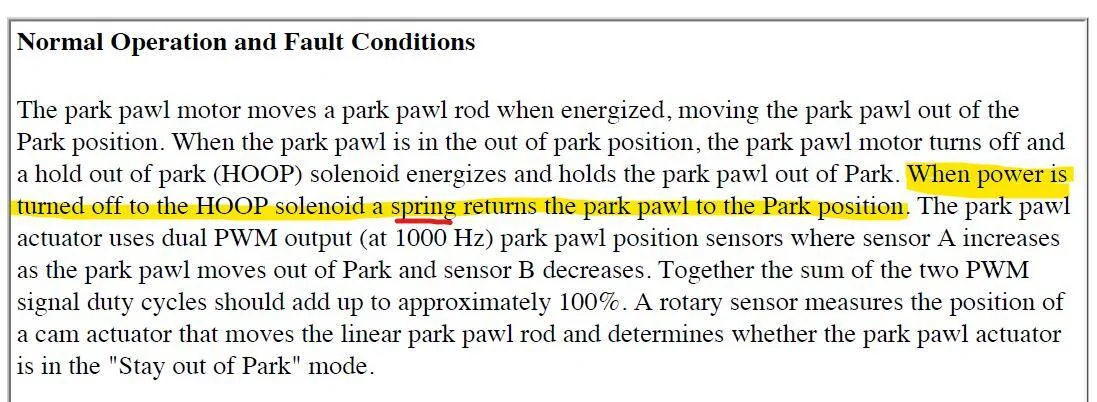

Not sure that is true, for it to move to lock position, the shifter would need to go to the park position.
As long as the mode selector is in D, N or R the rear motor won't lock up.
1) No, “Stop safely now” will not result in the wheels locking up. You could lose power.

The service rep at the dealership told me that the wheels are electrically powered and there is an emergency strap inside the truck that needs to be pulled to allow the wheels to turn in the event of a loss of power. He gave the example that to pull the vehicle up onto a tow truck, the wheels need to be manually released using the emergency strap in order to roll when towed. He also specifically said that with a loss of power, the Lightning is not like a gas vehicle where the car rolls to a stop but that the wheels stop and will not turn, not allowing the driver to coast to the side of the road.
I am hoping that I misunderstood what he said and would love more clarification on this. I appreciate any information you all can provide.
I mean technically that's not accurate as there's nothing physically connecting the "shifter" to the drive motors and the parking pawl. Those are all electronically actuated so if there was some sort of error or fault in the module that communicates with the drive units or parking pawl actuator, it could easily lock up.
Now I'm not saying this will happen, but it's certainly possible.
I'm aware that it's all controlled by wire, the question is, does the parking pawl default to lock-up by a spring loaded action when 12v is not present on the control circuit?

Again, the issues the OP and many other members who have had this problem relate to the HVB and contactors / controllers failing. If there was sufficient 12vdc energy to get the truck into a drive mode, there is likely enough energy to maintain the park pawl in the drive mode, {not locked up}.
