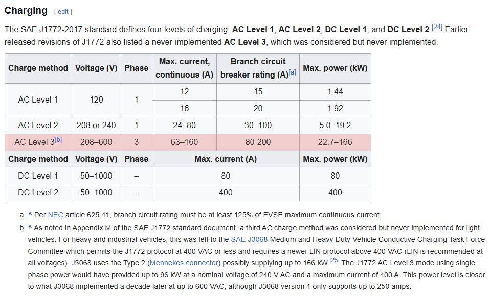

From Wikipedia entry for SAE J1772:
Ford F-150 Lightning Highest KW AC Charger? 1745441089334-d7

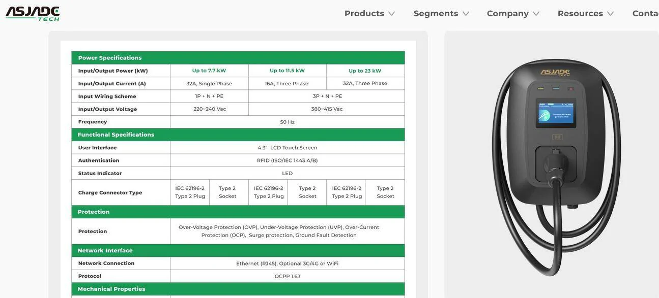

Thanks Maquis, I'm a Min/Max person hence the use of Lightnings in first place. Too bad we've left "power" on the table from a charging perspective. I'd found this one from EU (made in Taiwan) was pondering bringing in to "try".
Ford F-150 Lightning Highest KW AC Charger? 1745443260442-h
That's at an input voltage of 380-415, you will have a crispy truck if you try it.

That EU EVSE has a different output plug and it’s not compatible with the Lightning’s J1772/CCS1 charging standard. I wouldn’t waste the money. It won’t even power on, or if it does it’ll fry some components. The frequency is 50Hz rather than the 60Hz the grid provides and your appliances expect.

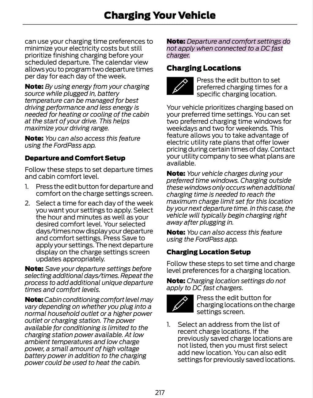

AFAIK, our trucks do not have the capability to precondition using departure times on DC.

I see that you have 5 Lightnings in your signature, you could employ a "lot jockey" to move the fleet to DC ports, once each is topped up for the next day of service, move the truck(s) to a J1772 EVSE at 32/40/48 amps would give you sufficient power to allow overnight & departure conditioning to work for all the trucks.
If you don't have the payroll for a dedicate yard person, maybe offer an incentive to one of your employees to hang around after hours to shuffle as needed.
On average I've only seen battery conditioning running about an hour or so, get your early bird employee to do the AM shuffle.

Although it may not precondition if you too up the charge from say 95 to 100 it should start the heater and get the battery and heater loops warm. Not sure if that would be a manual process or if you have an app where that could happen
