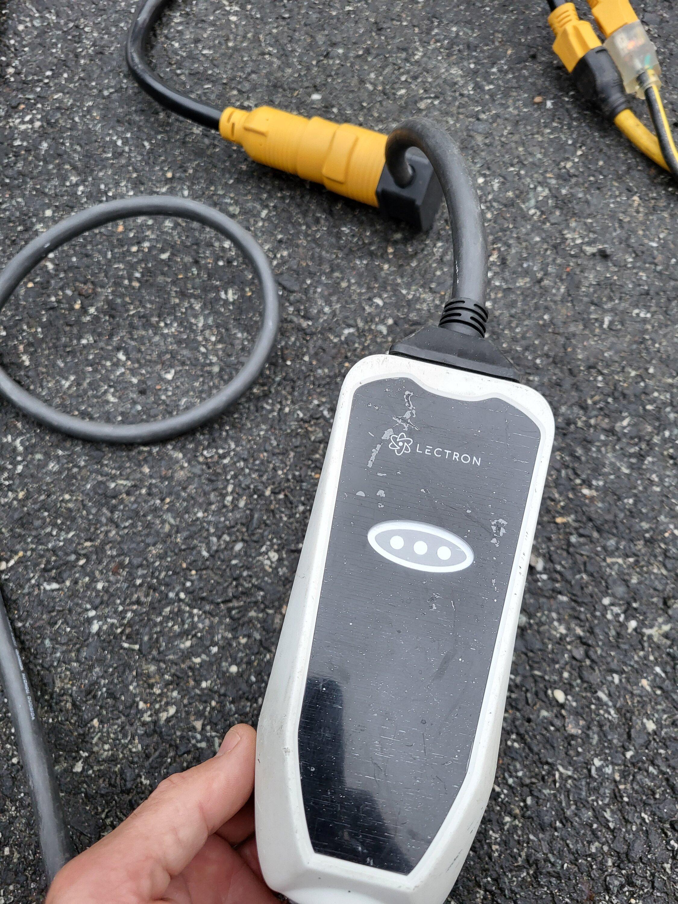

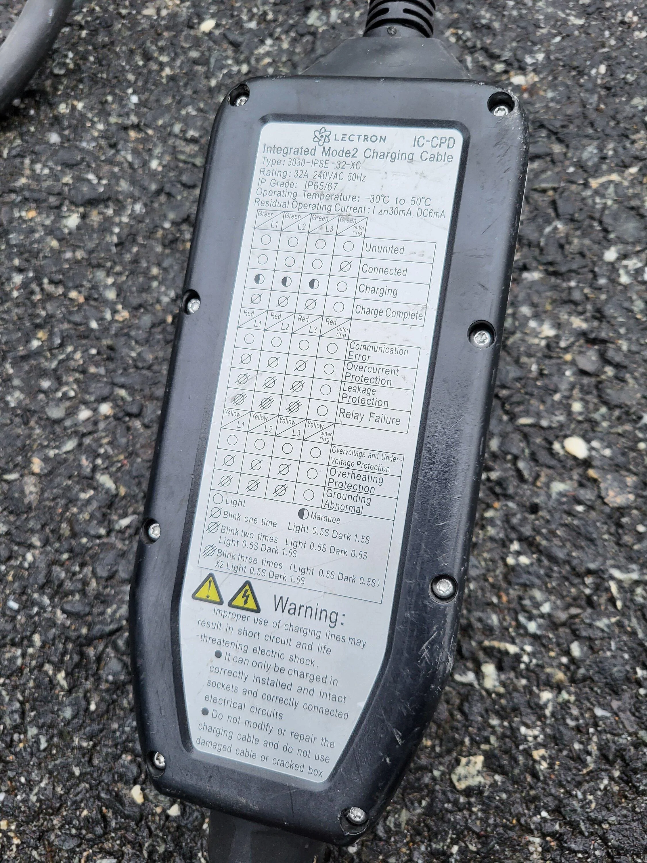

Hello Amps
What model is your Amproad charger.
I only found Amproad iflow p9 portable charger and it doesn't do less than 24amps at 240 volts.

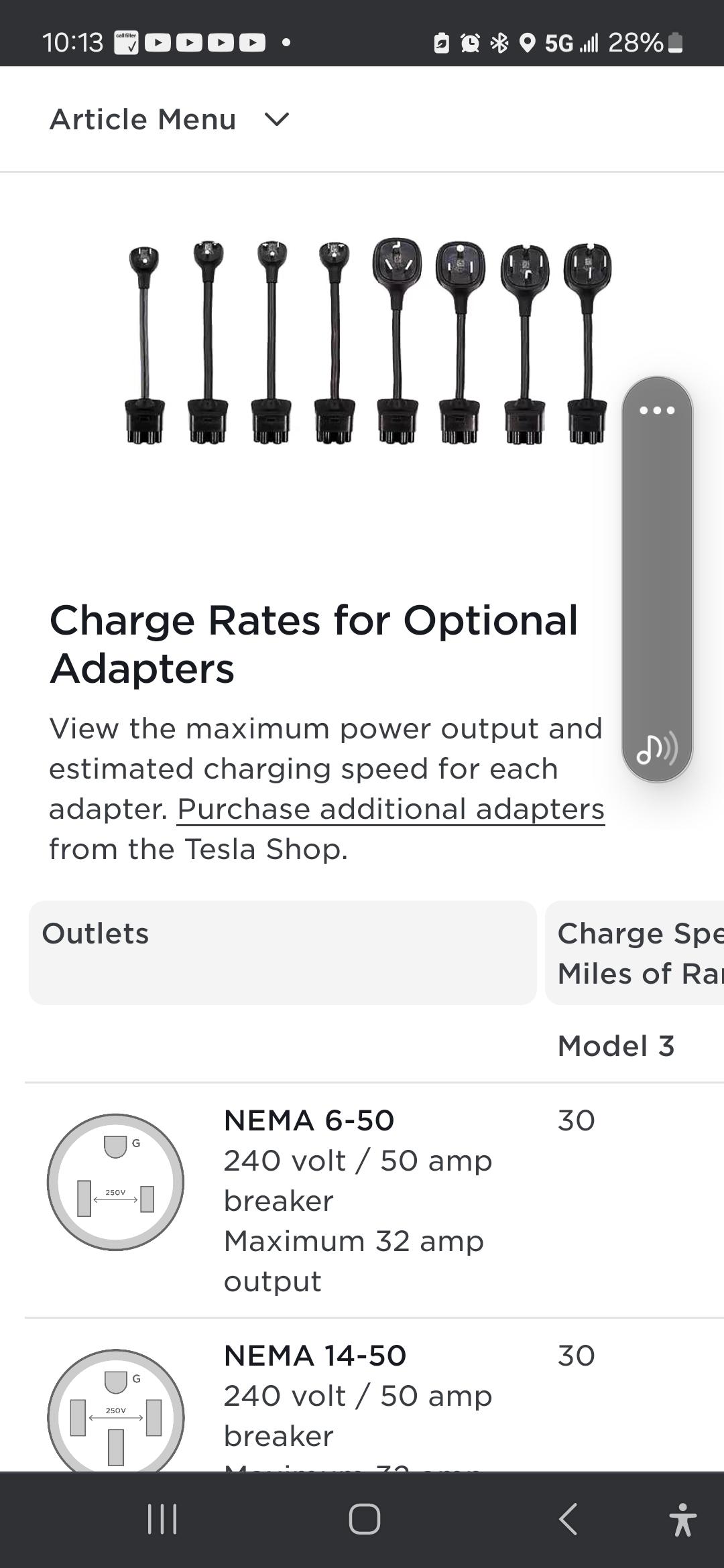

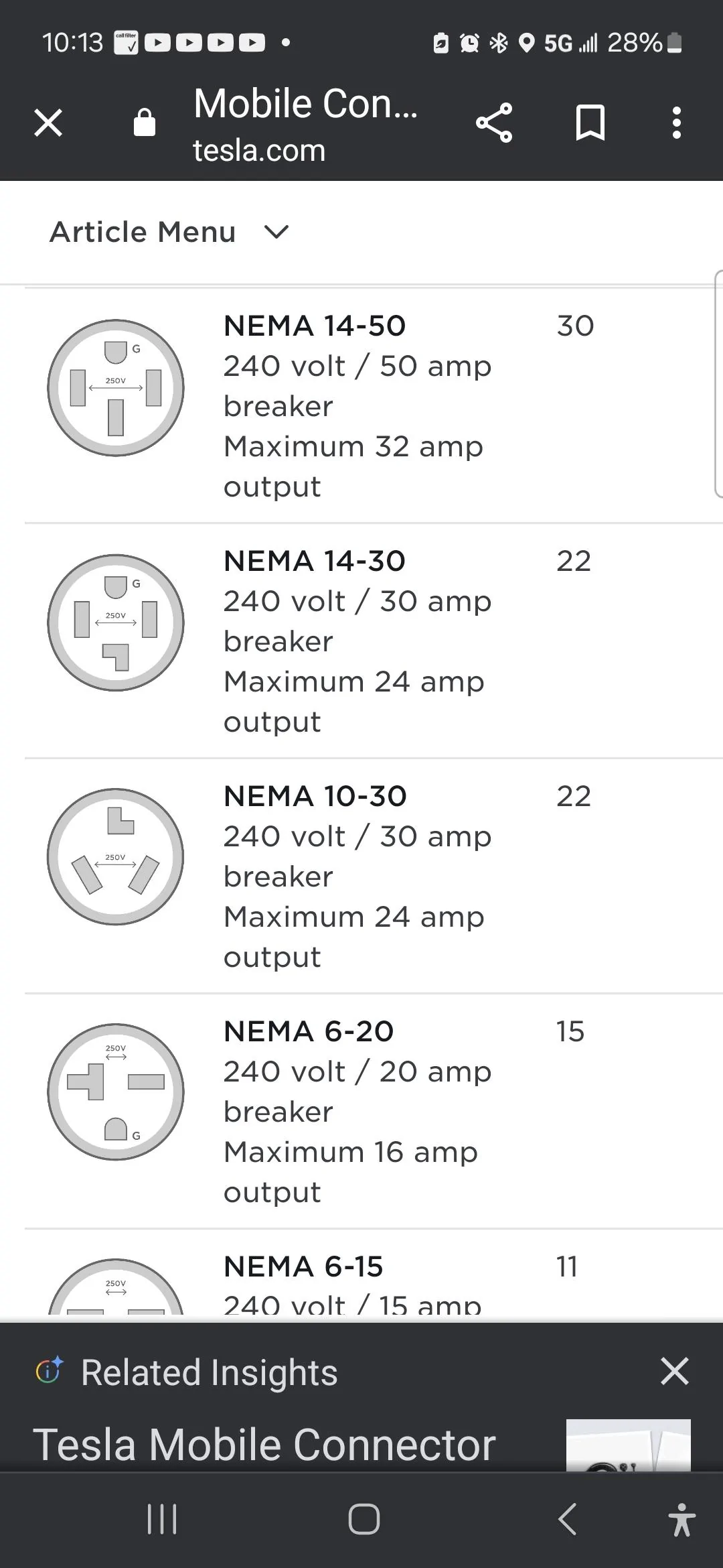

I think the Tesla charger may work with the 6-20 pigtail.
Can anyone confirm this.

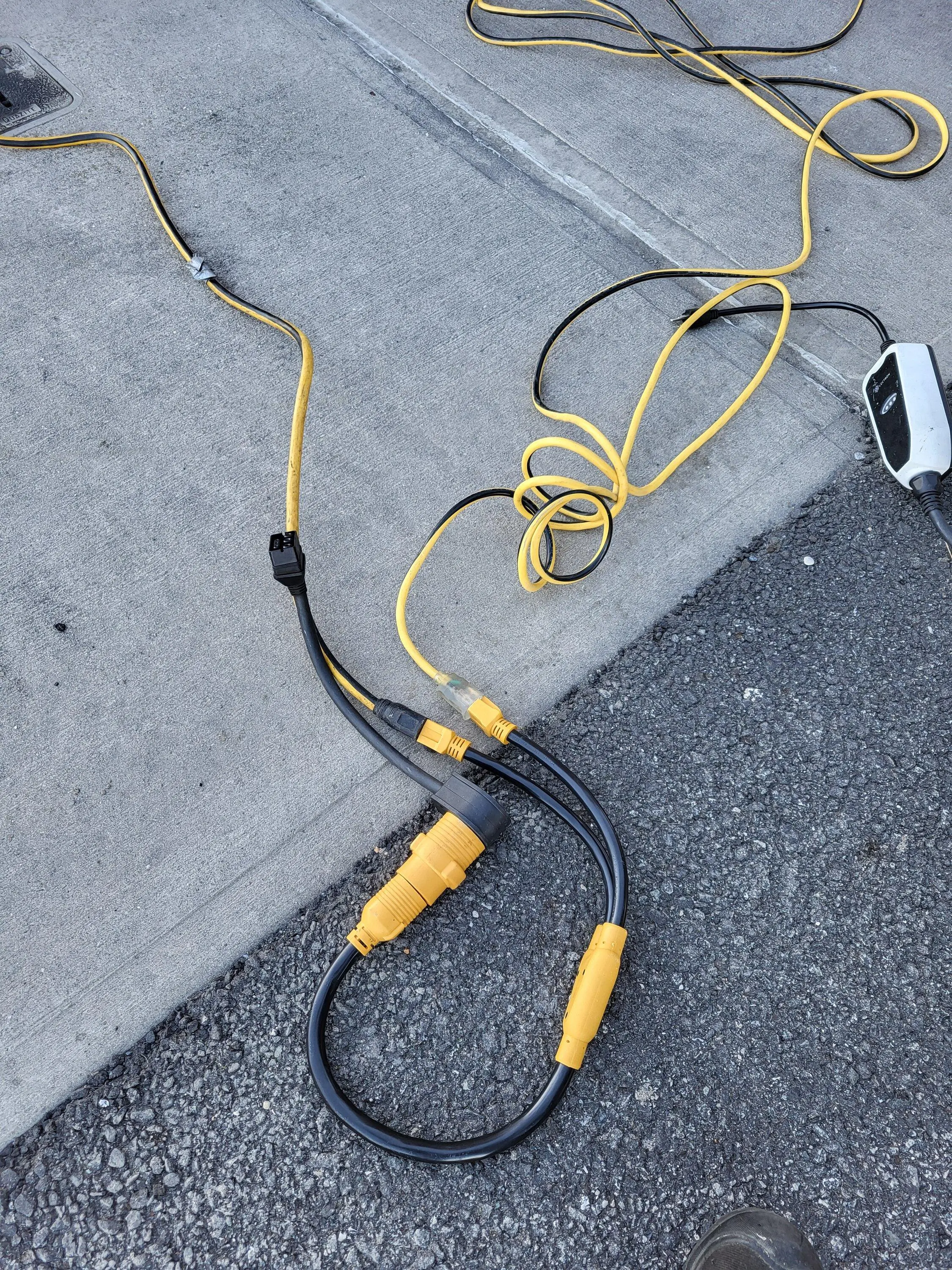

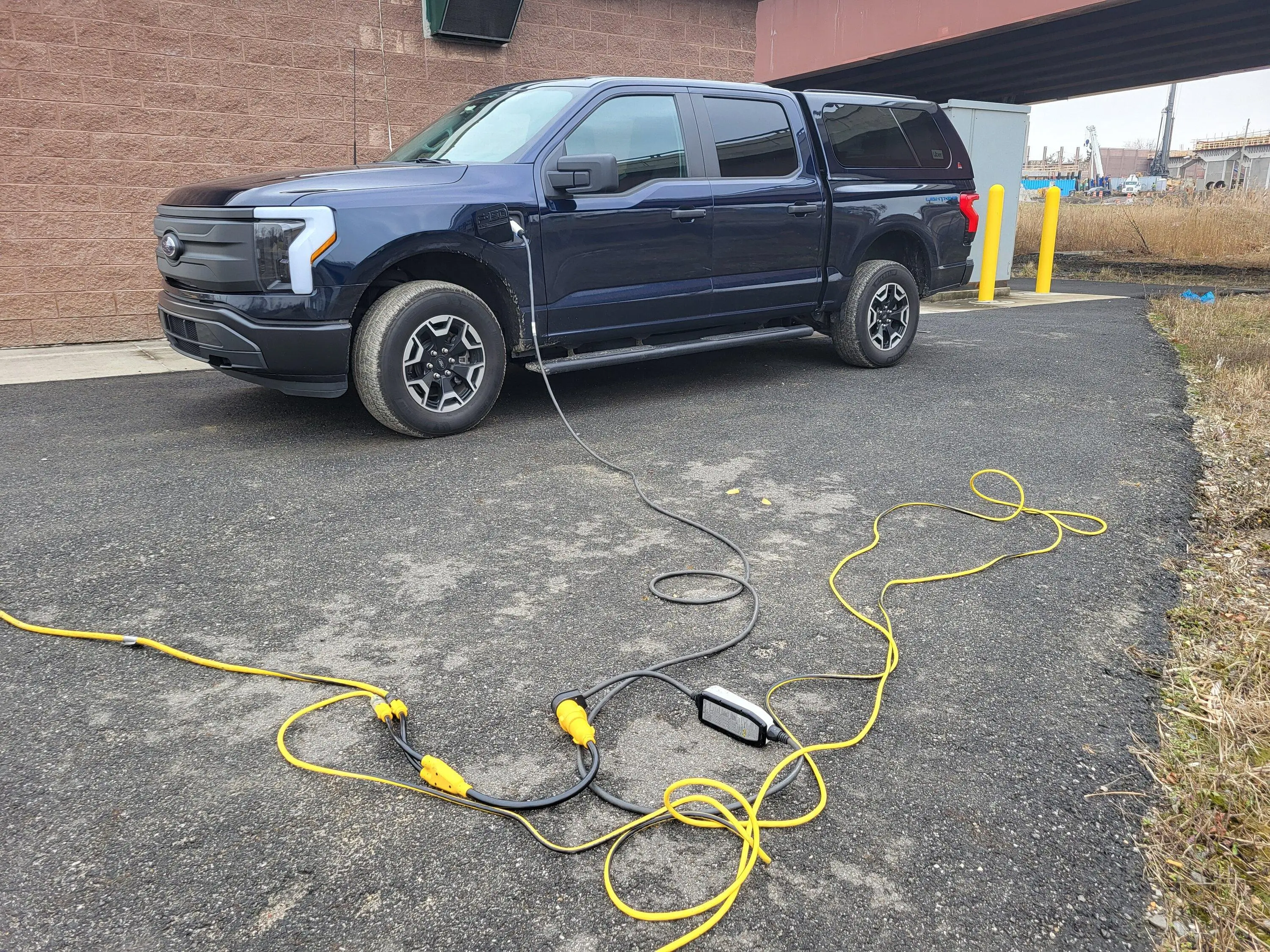

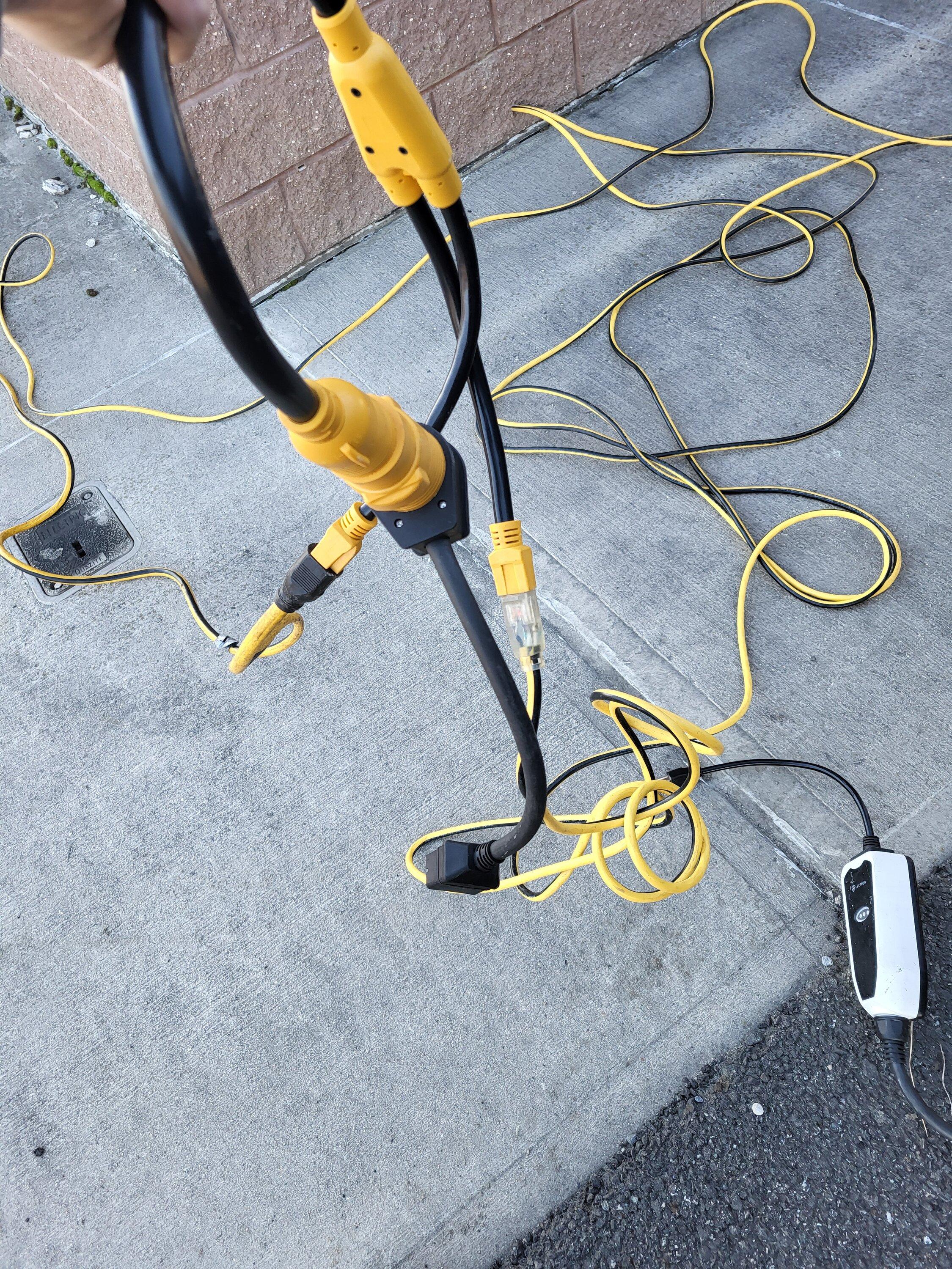

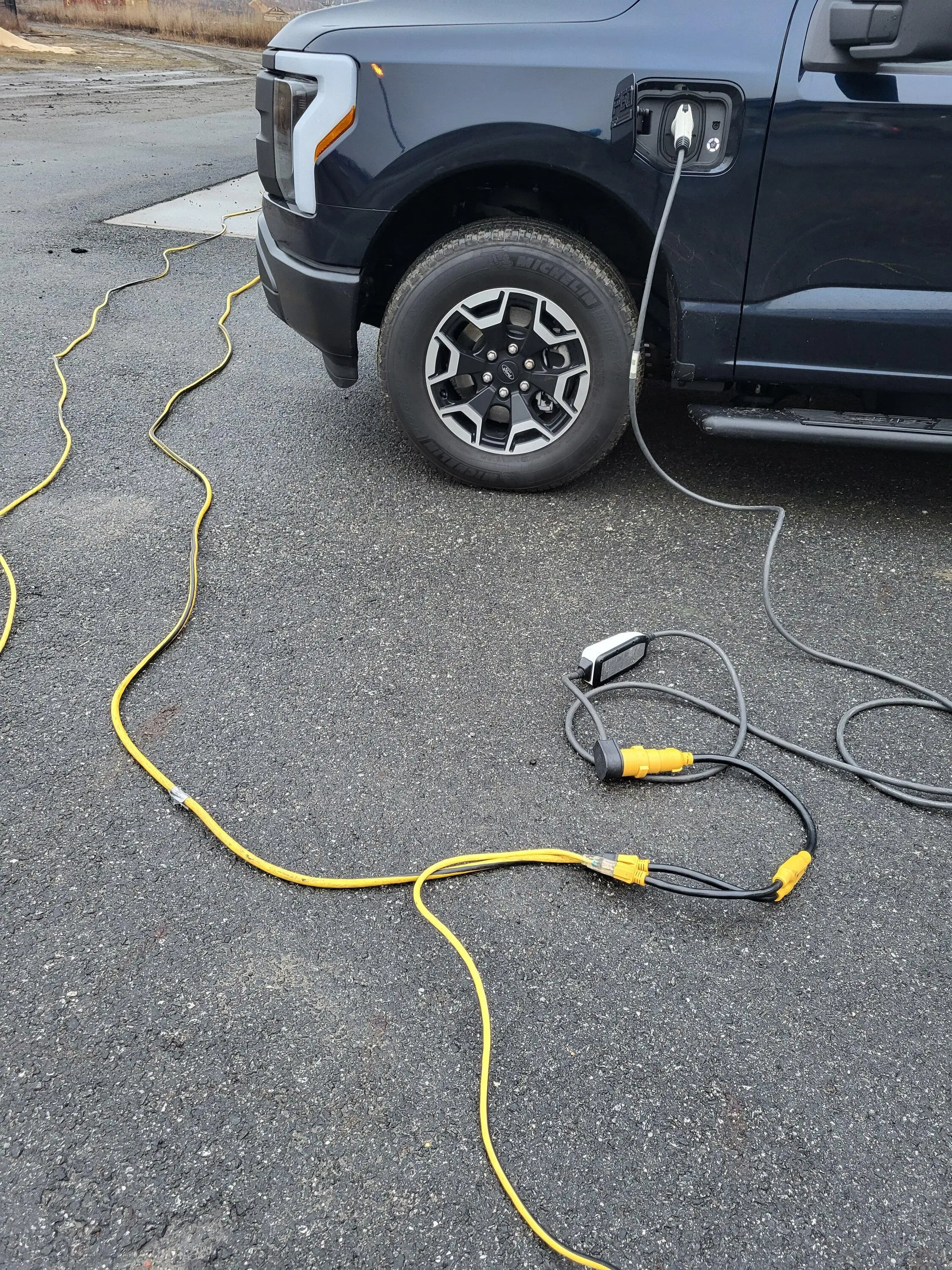

Focusing on
Looking for 12amps at 240volts
On 2 separate dedicated 15amp circuits (120VOLT CAMPGROUND OUTLES)with extension cords to a pigtail to the portable charger.

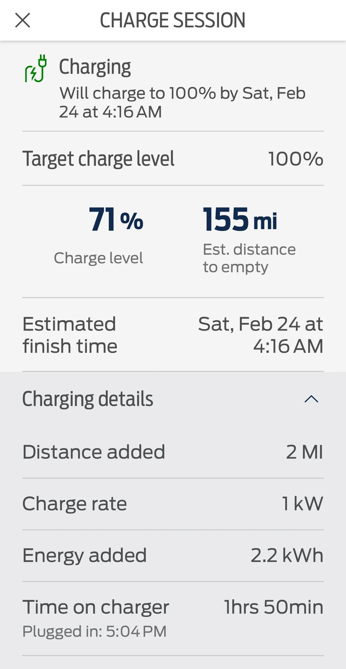

Looking through the ford menus on app and truck I don’t see a way to lower the current draw. Is this possible? Where? Have latest software updates on app and truck.
Yep it should be able to be adjusted, but nope?! As 110v puts out one KW on Ford, on my old Tesla it would be in the double digits? Unless Elon was fudging the numbers, like dieselgate?

It's simple math. 120V X 12A = 1.44 kW. Could be lower, or a little higher, dependent on your exact voltage. FordPass rounds down. and part of that 1.44 kW is used to run systems on the truck, so it probably charges around 1 kW.

I can confirm that two 120v L1 + L2 (two separate circuits and phases) combined into a 5-15r pigtail using the 5-15p 120v dongle on the Ford Mobile Charger will charge at 240v at 11.5 amps. However, if either of the circuits are GFCI protected the GFCI will trip. Has anyone found a workaround to this? When visiting a friend or renting a VRBO it would be nice to be able charge over night.

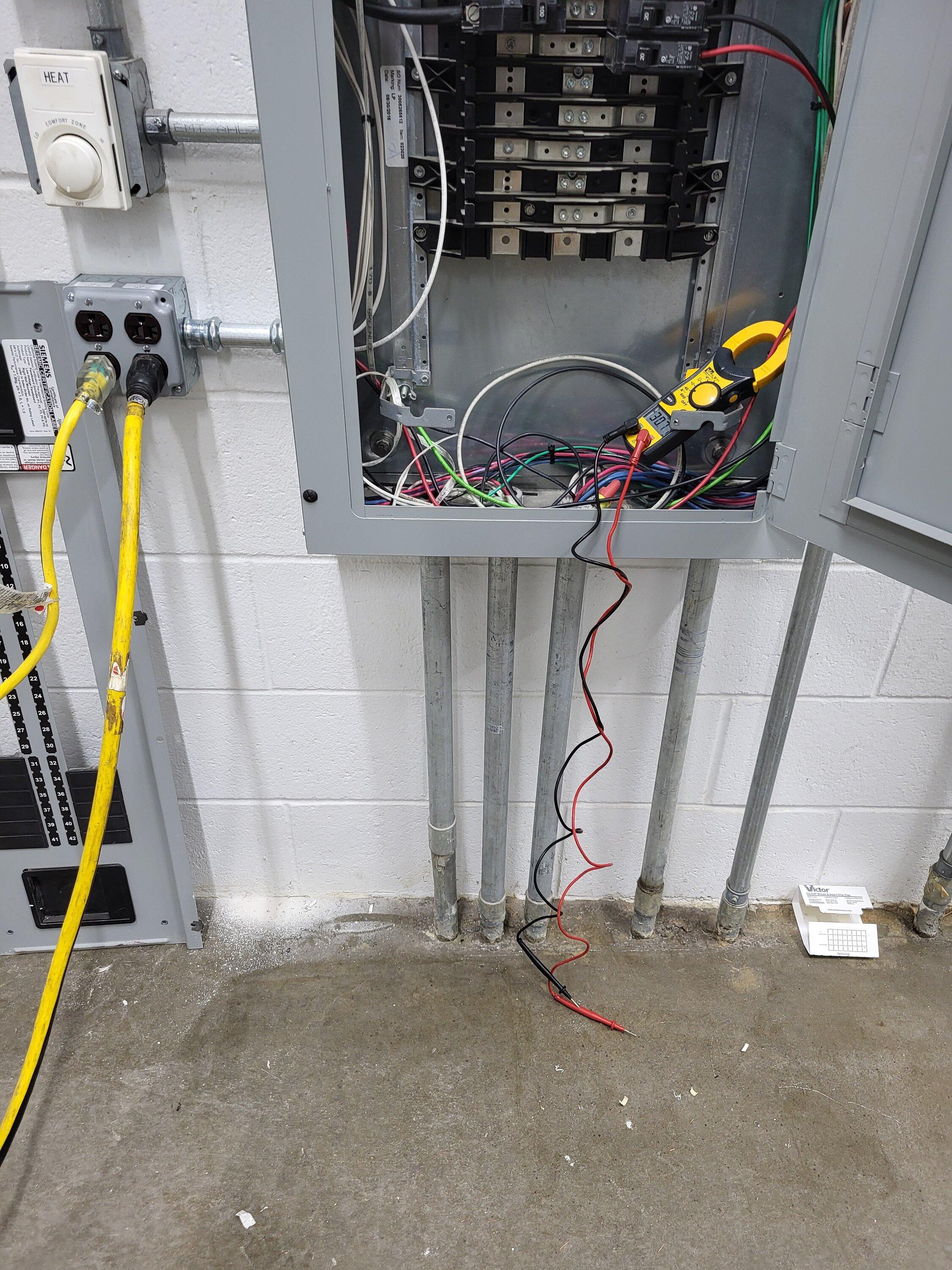

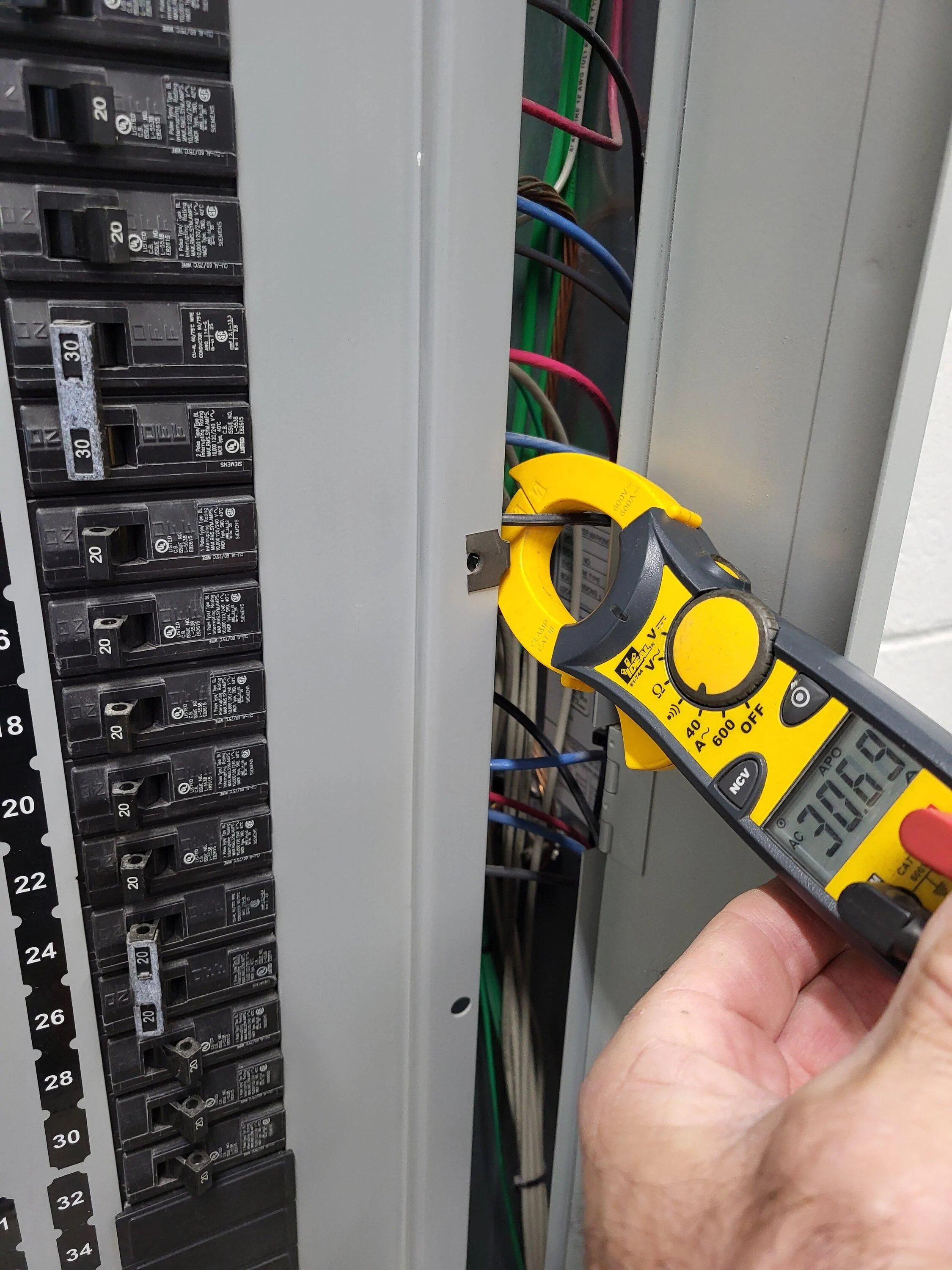

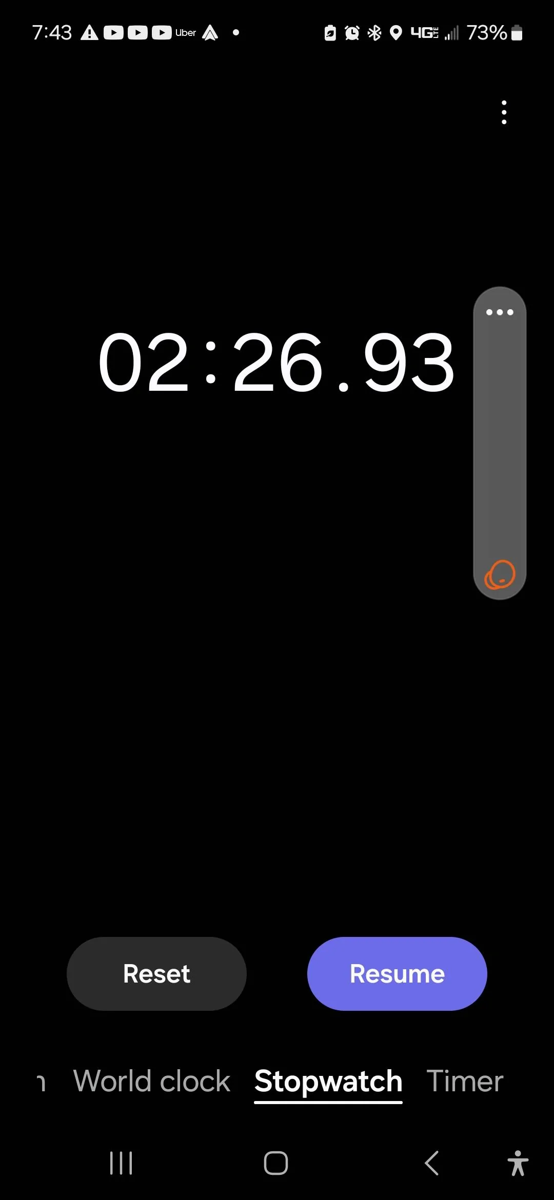

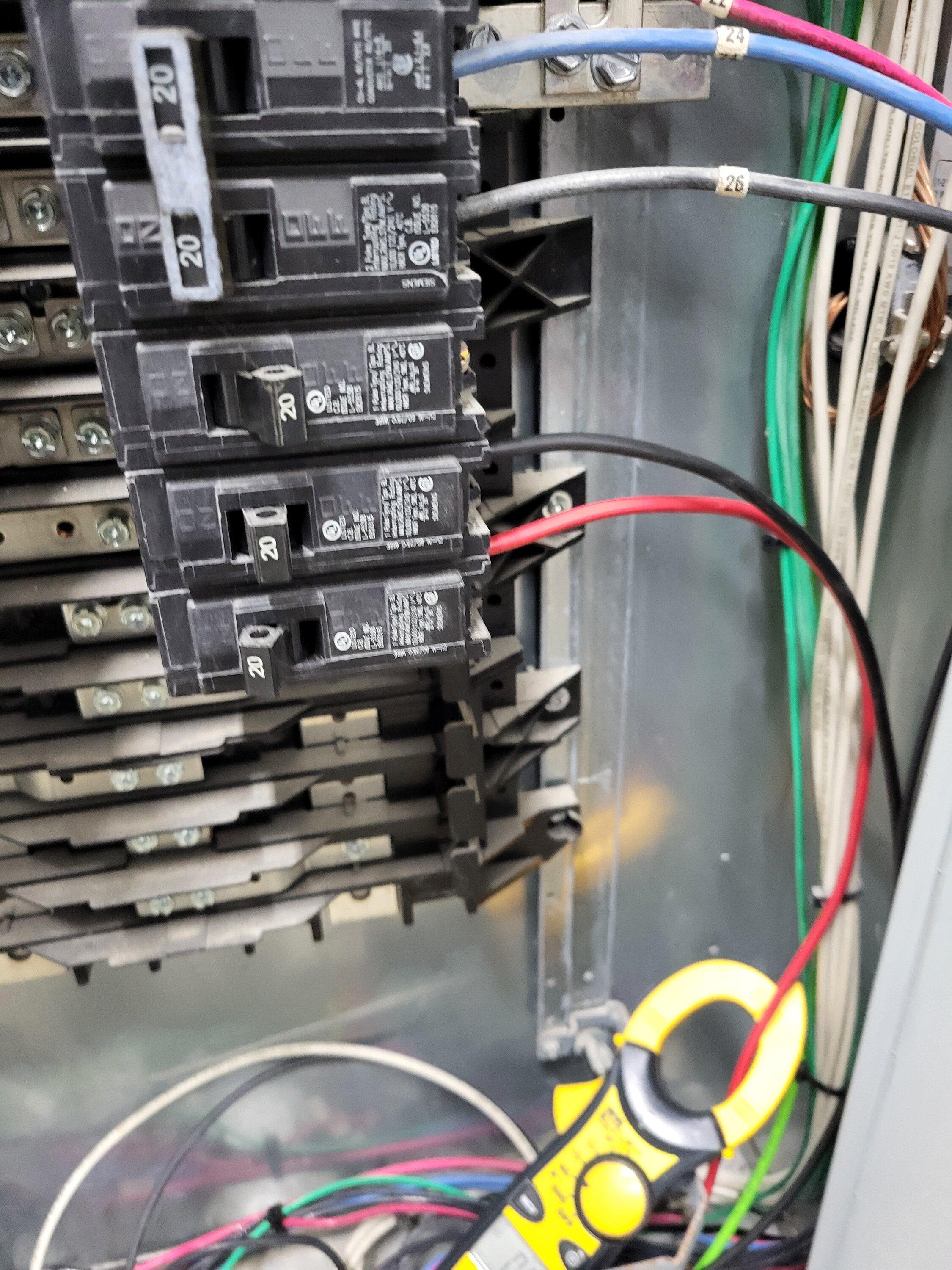

You got me stirred up again with these numbers,so I just did another test.
A 20amp breaker will hold 30.5amps for over minutes.
Ford needs to add software for amperage adjustment in the truck it self and not rely on chargers to do the amperage adjustments.
