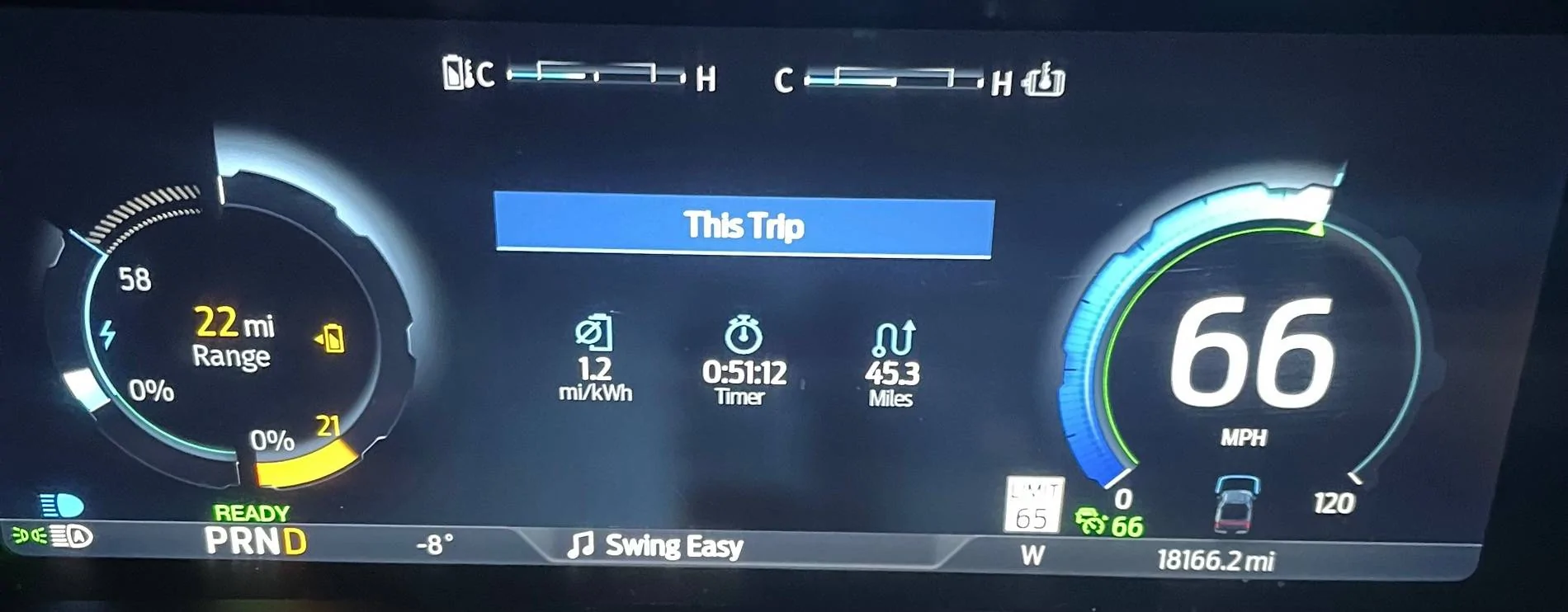

Less than 1 mile per percent

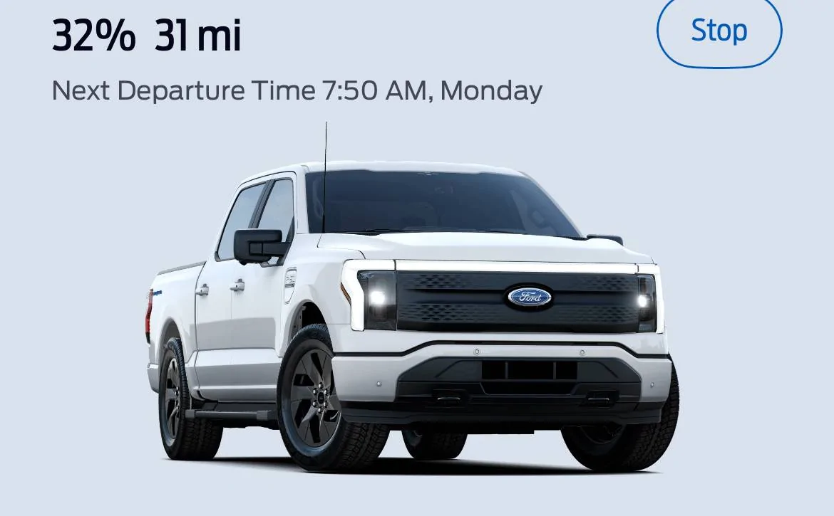

How can you precondition from a parking lot? I was out. Also, if you look at the first picture, the temperature on the battery isn’t bad. I also hit a fast charger to heat it up a little before we left.

Rick….. I am fully capable of making sure I have enough charge at any given time on a PLANNED trip but 1 mile per1% no matter how you plan it is still unacceptable. I don’t look at the range. I look at the percent and that’s what I use. I know I need so much percent for so much. And as I’ve said multiple times now. This ain’t cold!!! We’re just scratching the surface here so I’m assuming that eventually it will be half a mile per one percent. And with the nearest town being 45 miles away from me, any kind of emergency situation this just will not work. And it would be moronic me to continue to try.
imagine after leaving home with a 100% charged battery and going to a hospital 45 miles away for an emergency room visit after getting stitched up and dealing with all the hassle of that you go ā€œoh shoot I gotta hit a charger just to make it homeā€ it’s not about it being the wrong truck for me. It’s the wrong truck for anybody that experiences what I would call a real winter.
Then what happens if a 40 mile an hour wind picks up halfway home all of a sudden what was enough charge to get home aint enough charge to get to the next turn.
