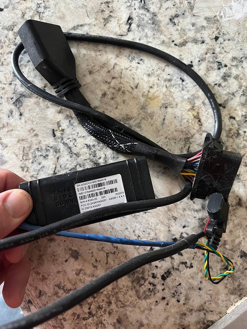

no, the truck came with this, though I was hoping it was something to link up with a better route planner, but from looking up the numbers, all I can tell this is for is for tracking a vehicle previous owner must have not trusted his wife.
Dealers install this shit without telling you to make it easier to repo. I’m sure they have it in their paperwork, but no one reads all that.
That's super interesting. It's a GPS tracker, specifically a PHILLIPS CONNECT Arrow-QG Vehicle Tracking Device.

Someone had already unplugged it, but it was zip tied up underneath by the odb port
Side note. Take the SIM card out of that thing. You can use the data for awhile. I found one of those in a car I paid cash for last year. Took it out and it had a T-Mobile SIM card. Put it in my iPad and it worked with unlimited data for 7 months before it stopped working. 😁
