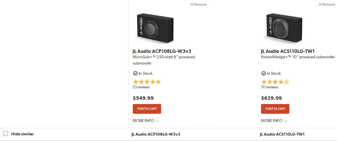

I was doing some research, and I was wondering if you saw this JL Audio sealed 10" powered sub, which has almost the same dimentions, and why you wouldn't have gone with it? There is a guy on the Mach=-E forum that loves this sub in his car, and I was thinking about putting one in both our Mach-E and Lightning.
https://www.crutchfield.com/p_13693334/JL-Audio-ACS110LG-TW1.html
I may be wrong but I think the big difference here is ported vs sealed subwoofer box. The 10” is sealed which I understand creates “tighter” bass. I don’t have any direct experience with sealed enclosures.
I've had both, you are correct.
Sealed is "tighter" also described as punchy. Ported and bandpass are more boomy.
I overlooked that. I may actually lean to the 10" now. I was planning on installing the 8" eventually.
From my knowledge of JL products the W3-3 is a higher quality sub compared to the TW1 line. A comparable line would be the TW3. An 8" W3-3 will be tighter/punchier but quieter, a TW1 10" will be a little boomier but also louder. The 8" is probably Ported to gain volume at the expense of some of its punchiness.
If given the choice, I'd rather have sealed then ported. My rap and hip-hop days are behind me. IMO, rock sounds better with a sealed box. The extra wattage and slightly smaller package is just a bonus.
