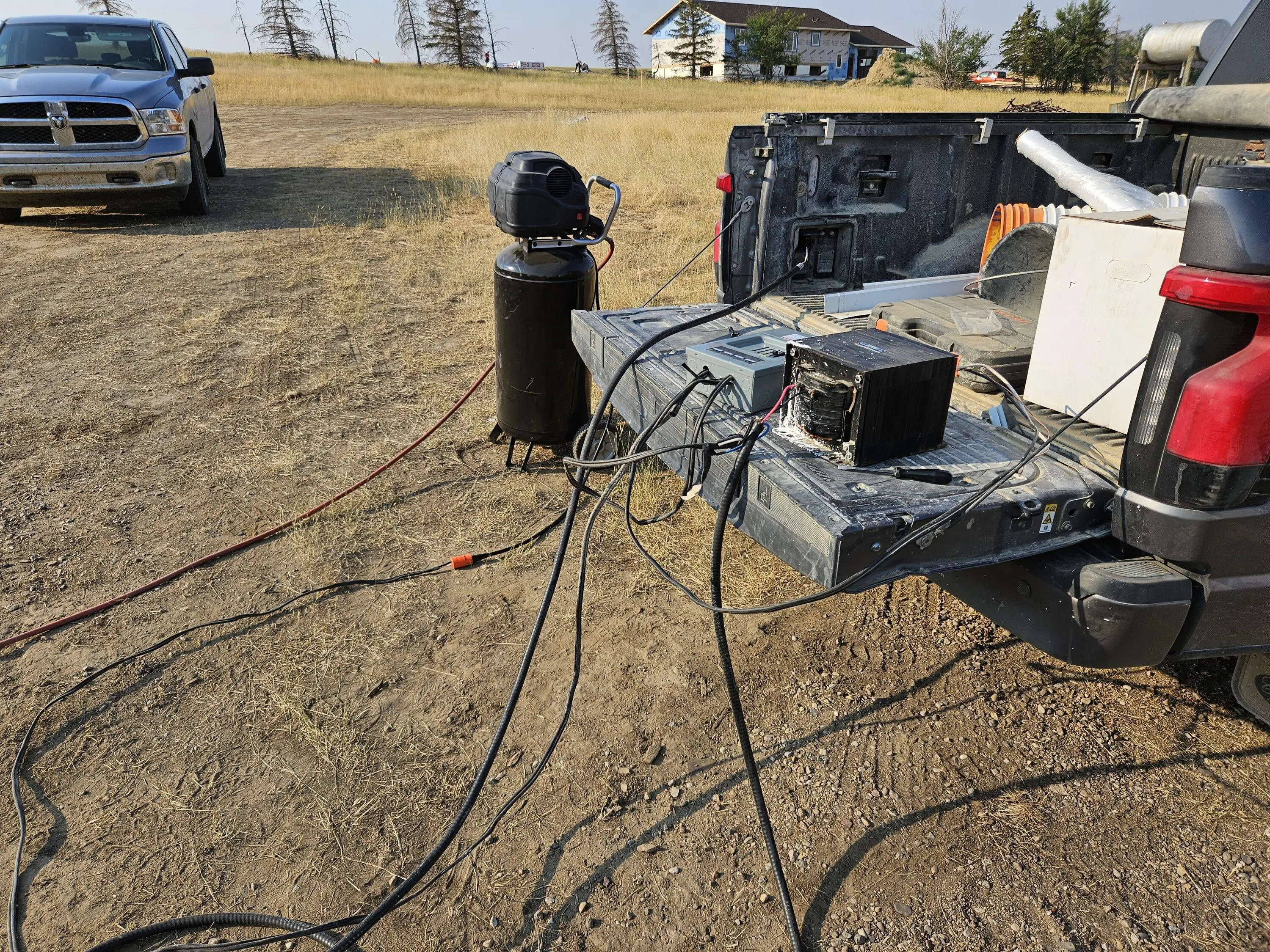

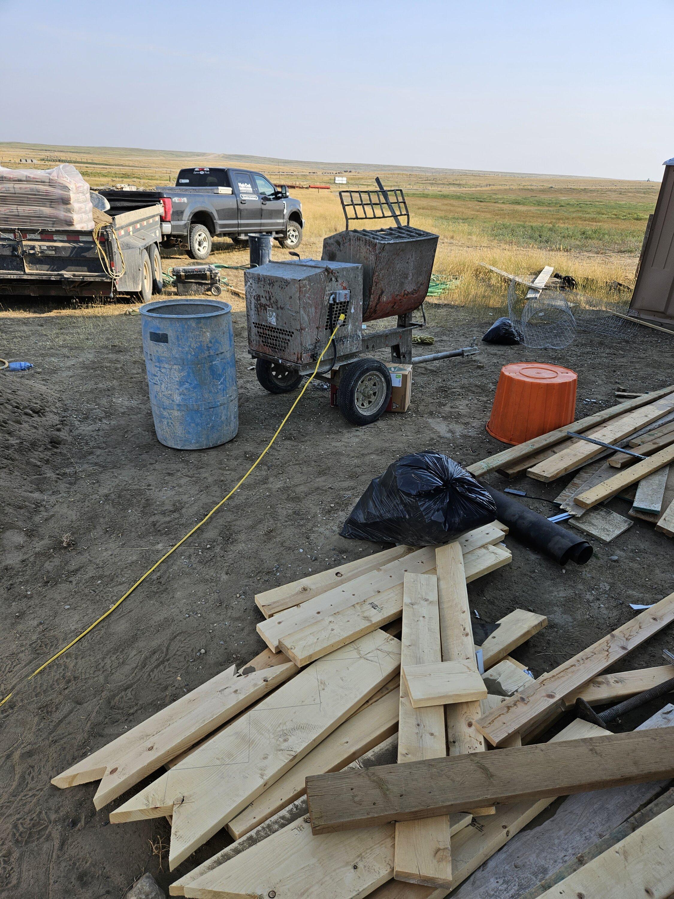

Because I have specific high power draw loads I needed more amps at 120v. So I rigged up a 250-120v transformer to double my output.
It works flawlessly just starting to build a rig to carry it around transformer is around 150lbs

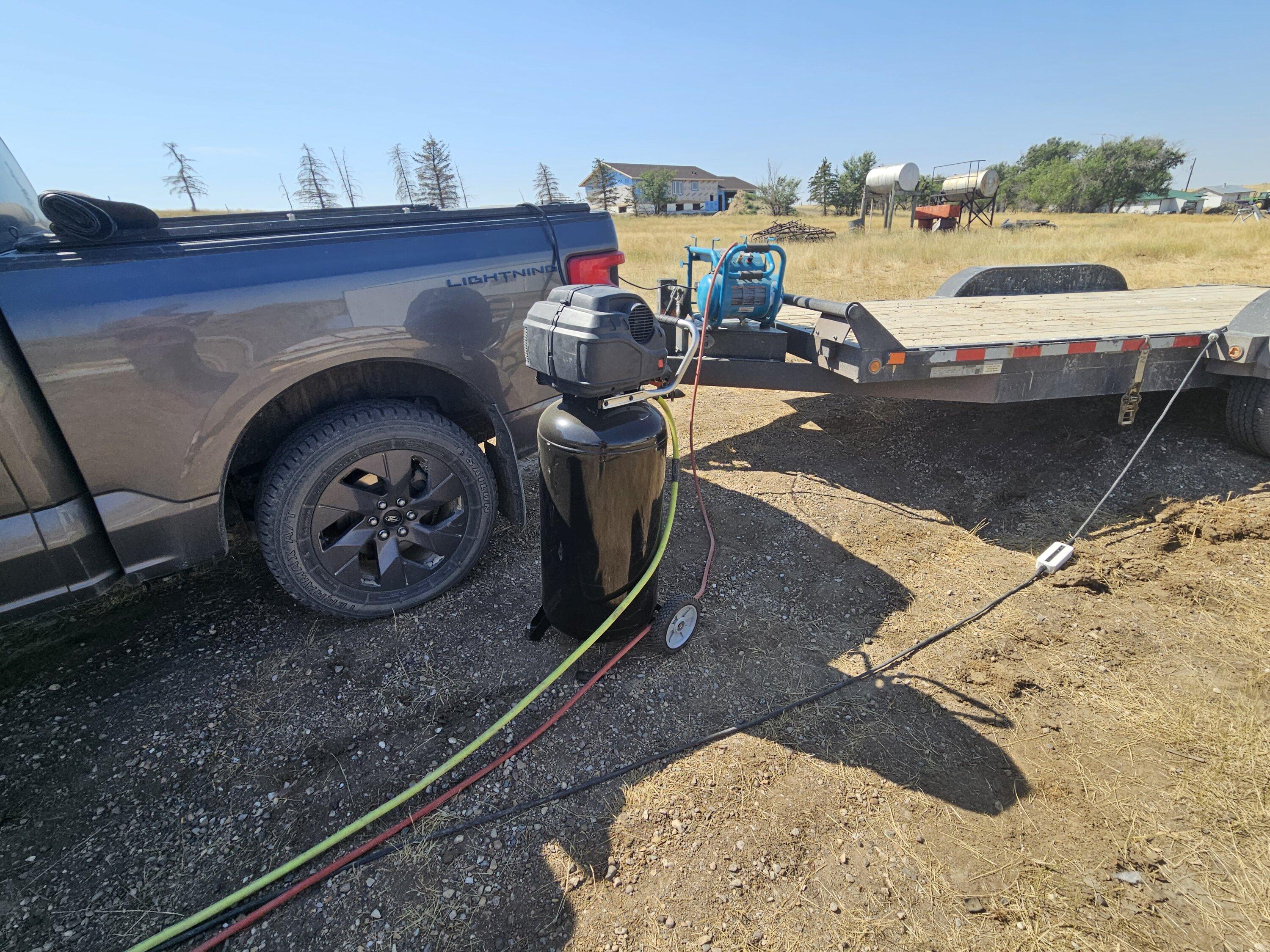

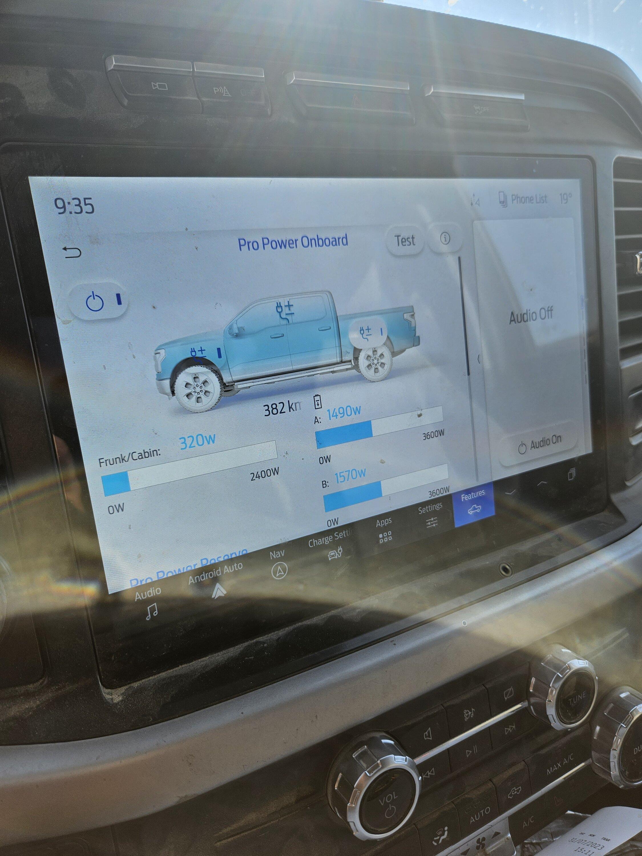

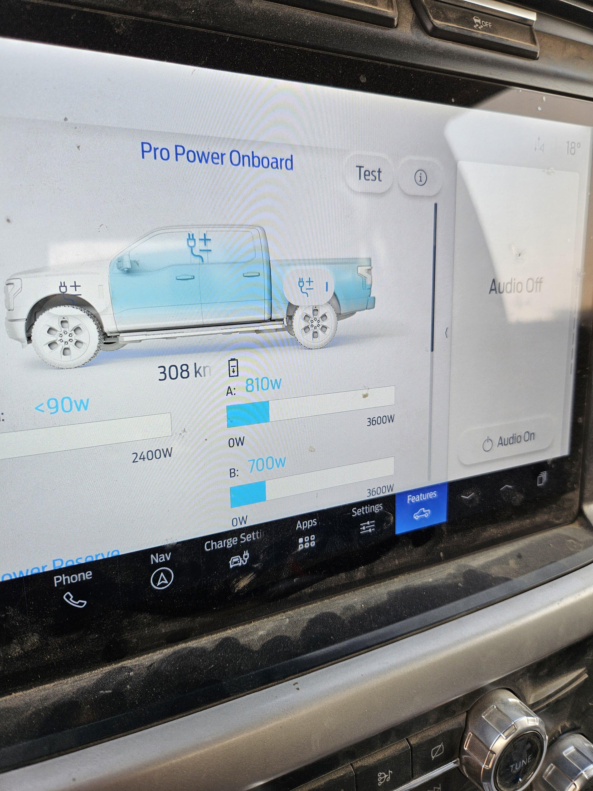

We were able to run out cement mixer that needs a dedicated 20amp circuit. We tried to run it off the 120v lines from the truck and it would flip the breaker instantly.
By using 240v from the truck I'm using both inverters to run my 120v load
