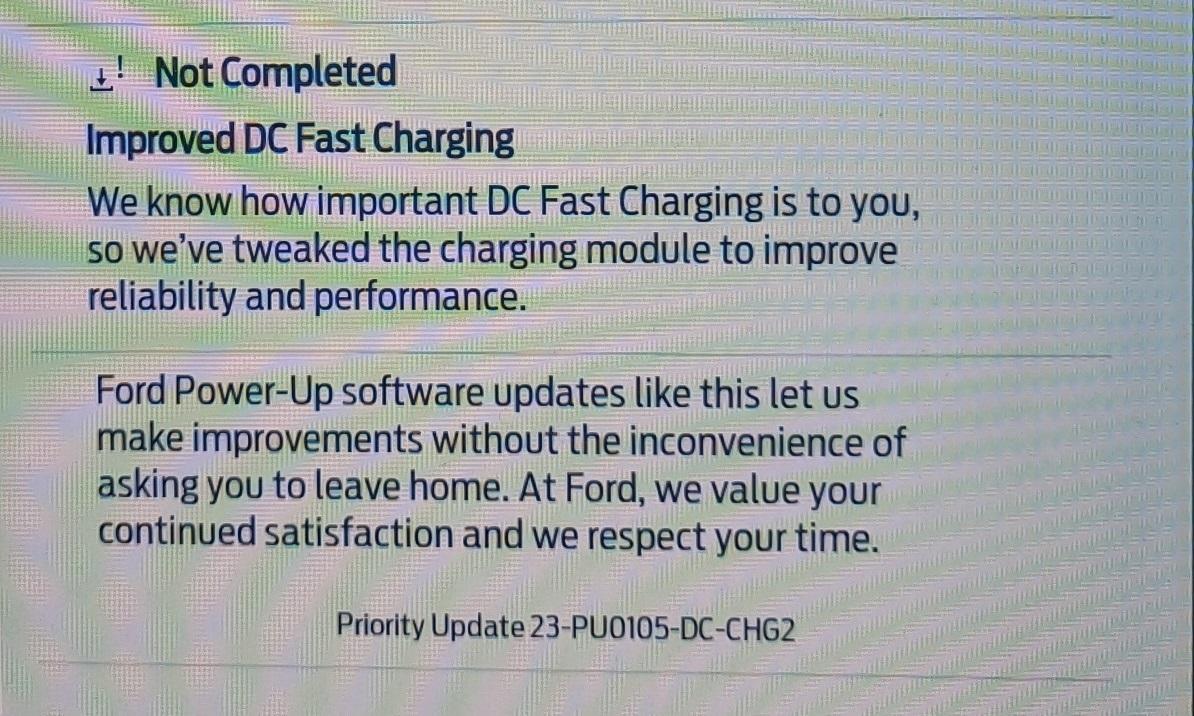

I'm now on trip # 14 back to the dealer trying to fix the below. It's been with them for a week this last time going back and forth with Ford. I have no idea what happens out of warranty, but this has not been confidence inspiring.
Ford F-150 Lightning Lack of OTA Updates...Am I the Only One? error
