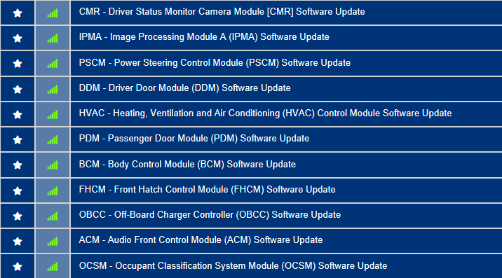

Still no signs of updates for me…
Are you looking for something specific? Like the OBCC for example?
You don't currently have a gateway, or APIM (Sync), or TCU update in your list...and most (if not all) of the updates you currently show haven't gone out as OTAs anyway.
And according to your session history the service techs didn't update anything while they had your truck...they just gave it a check with FDRS, and obviously decided that since you didn't have a GWM (gateway) module in your list that needed updating...that you were good to go and nothing more they could do.
Ford F-150 Lightning Lack of OTA Updates...Am I the Only One? jhawkbear-17-Mar-24
Cruise control related updates (OTA versions of the CMR, IPMA, PSCM) are kinda all on hold right now while they sort out how they're going to certify and then roll out BC 1.4. And that will probably be rolled out to the '22 and '23 model years as separate groups when it does happen.
Most of the other stuff in this list with the exception of the OBCC hasn't even gone out as OTAs that I'm aware of. I could be wrong.
