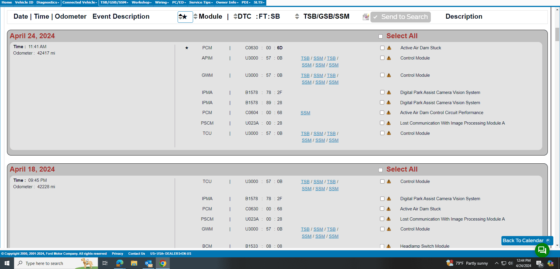

You're on the latest Sync version. Not sure about the issues with the screen. However, I am surprised you say your BC regressed. The dealer did the latest IPMA/PSCM updates which contain the improved BC performance associated with BC 1.4. I see they also performed an IPMA calibration procedure. Do you have FORScan? Your truck is reporting a bunch of codes that I don't like. All these U3000 codes within the APIM, GWN and TCU are not normal. And it's been recording them for over 60 days because that is how far back this info stays recorded in the cloud and I see the code as far back as 2/23.
Ford F-150 Lightning Lack of OTA Updates...Am I the Only One? Picture1
If you have FORScan, I would try resetting all three of those modules and clearing the codes on them to see if they go away. I can't tell if this warrants a dealer visit or not from what I can see, but I can tell you that these codes I do not see every day.

Yeah it’s a shit show to be honest. I don’t want to go back to the dealer and will probably invest in Forscan.
Just yesterday my from air dam was halfway down, it reset itself after a couple of power on/off cycles. I am getting different chimes every now and then.
It might warrant a dealer visit but at this point it’s better to let it die first, trying to explain to the dealership what is going is a task and hey won’t plug in unless there is an actual issue.

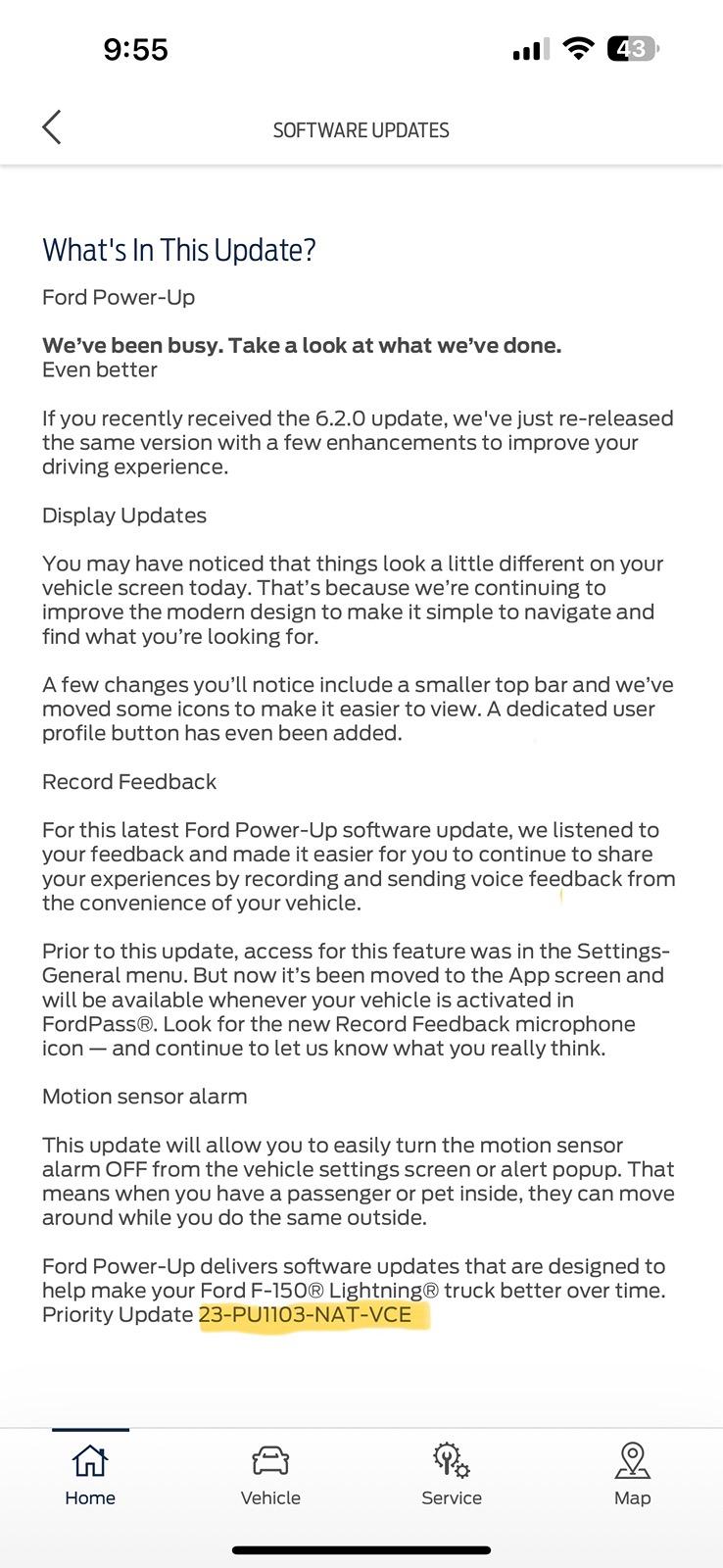

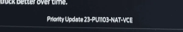

Could you confirm if it's this update?
Ford F-150 Lightning Lack of OTA Updates...Am I the Only One? 1714182878129-zc
If so, make a mention in this thread: (3) Priority Update: 23-PU1103-NAT-VCE (re-release of 6.2.0) | Ford Lightning Forum For F-150 Lightning EV Pickup: News, Owners, Discussions, Community (f150lightningforum.com)
If not, what is at the bottom of the description on the Sync screen list of changes, might need to scroll a little.

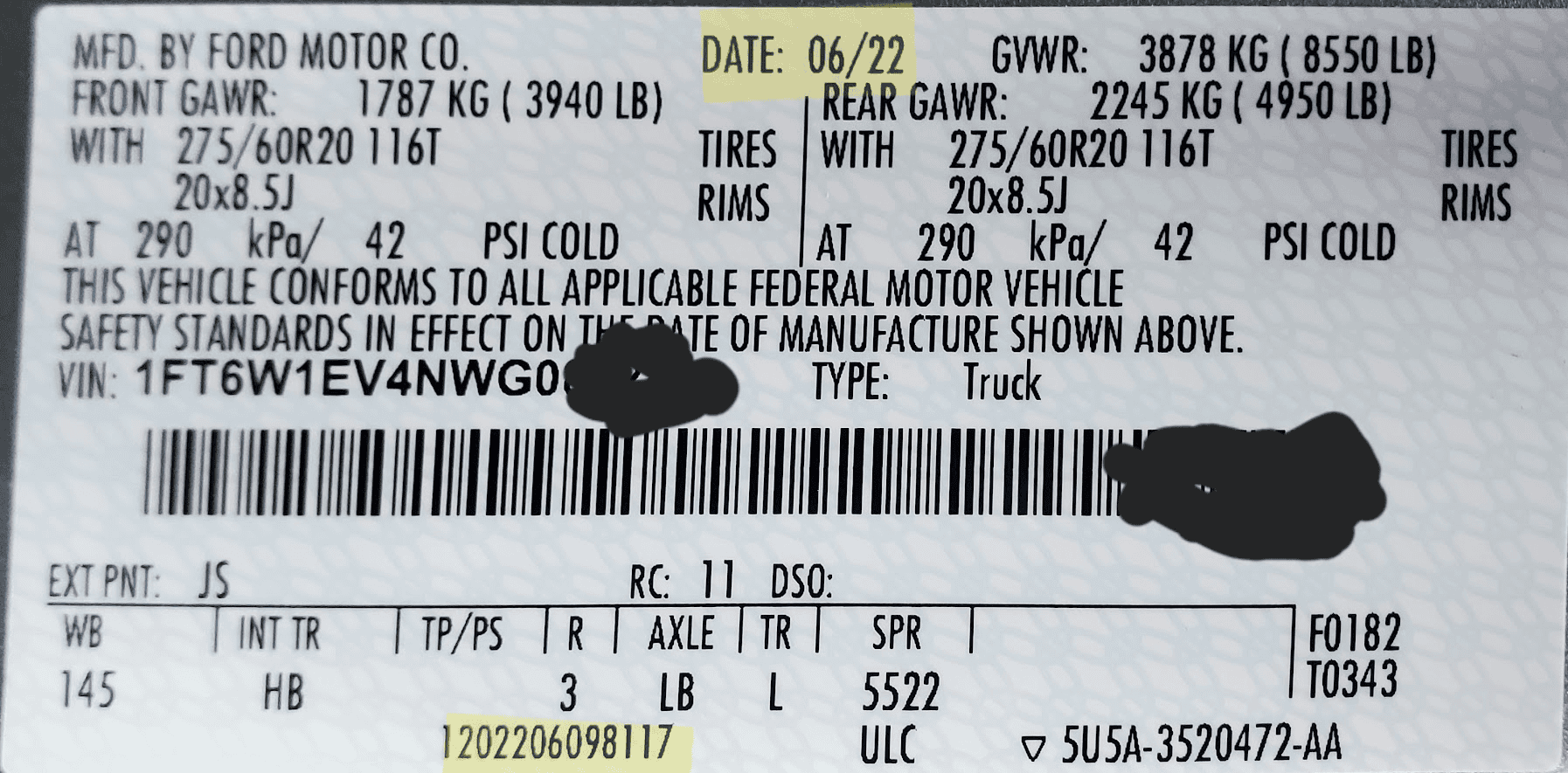

I just got 4.2.1.1 this week on my 2023 Lariat ER purchsed this month. Must have been sitting on the dealers lot for awhile. How do I tell what build it is?
Look at your door jam sticker for the tire specifications, there are two dates, top center and bottom center, my truck was built in June 2022 {06/22}, the planned blend date was 6/9/2022, it actually got built a week or so later due to a lag in production flow that week, actual built date was 06/17/2022
