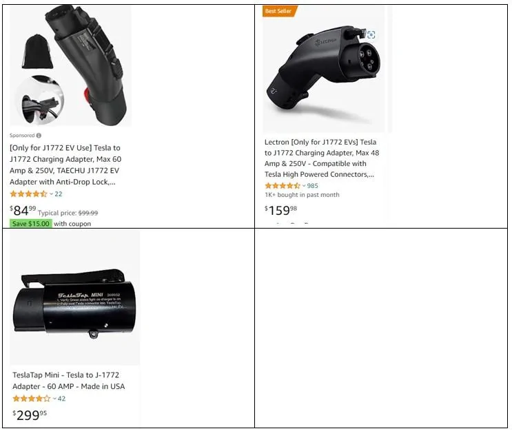

$300 for an adapter lolol. Gtfo. 60a is more than enough.

FWIW, I use that Lectron adapter for L1 charging almost every day, adapting a Tesla mobile connector to my Lightning. Build quality seems decent. Haven't actually used it for L2, yet, though, and I probably wouldn't try to use it for more than 40A continuous.

I bought a tesla tap mini as we have a Tesla wall connector at home.
It is expensive.
It is small.
It is an excellent device.
No, you can't use it with a supercharger.
I'm not a fan of buying cheap #@$% stuff for charging my vehicle(s) in my garage.
Basically, if you don't have regular access to a Tesla wall connector, then it is likely not worth the cost.

The current Tesla to J1772 adapters (the TeslaTap, TeslaTap Mini, and other brands) are only for charging from Tesla mobile connectors, Tesla wall connectors, and Tesla destination chargers (Tesla destination chargers are free Level 2 chargers at many hotels, restaurants and attractions). These adapters do not work with Tesla DC fast chargers, and probably do not work with any Tesla charger that requires payment through the Tesla app or via plug-and-play.
That said, I find these adapters quite useful, and I recommend carrying one on your truck for overnight road trips: I keep a TeslaTap Mini 80A on my truck. I've run across some hotels that only have Tesla chargers available, and at many hotels, the Tesla chargers deliver more charging current than the J1772 chargers.
Select the adapter that matches your truck's maximum charge acceptance rate. An adapter that is rated for less current than your truck's maximum is potentially dangerous, while one that is rated for more current than your truck's maximum is more expensive but delivers no benefit to you. SO:
  • SR Lightnings have a maximum acceptance rate of 11.3kW, which is a hair over 47A. Any Tesla to J1772 adapter rated at 48A or more is fine for a SR truck -- but a higher-rated adapter won't charge your truck any faster than 11.3kW. Do not use an adapter rated at less than 48A with an SR truck.
  • ER Lightnings have a maximum acceptance rate of 19.6kW, which is 80A. You must use a Tesla to J1772 adapter rated at 80A with an ER truck. While most Tesla chargers won't deliver more than 60A, there exist some that could.
Exceeding the adapter's maximum rated charging current could be a safety hazard. The adapter is a passive component, so it can't notify the truck or the charger of its current limit. Since neither the truck nor the charger would be aware of the restriction, they could overload the adapter, potentially causing Bad Things to happen: damage to the adapter, damage to the charger, damage to your truck, or even a fire.

Let's not talk about the promises of the future.
I'm trying to understand the options available now locally for a road trip and in a bind. (I have a SR Lariat)
Are the "Tesla to J1772 charging adapters" $80-$160 Only:
  1. if you were visiting a friends house that has a Tesla wall Charger
  2. (AND)
  3. would NOT work at a Tesla commercial charging spot (Like Wawa)
Are the "Tesla to J1772 (TeslaTap Mini) " $300-$400 needed for:
  1. A Tesla commercial charging spot (Like Wawa)?
  2. I assume a 60amp (would give me ~30Miles/Per hour charge) 80amp ~40m/hr
  3. What is required to use a Tesla Charge location at this time?
    1. Tesla app account?
    2. Would this work at all Tesla charging locations?
Always appreciate the help. Thanks
I have both a Lectron and a Tesla Tap. They’re good to pick up for use at Tesla destination chargers and on friends tesla wall chargers. But they won’t work at super chargers. Generally speaking I do recommend one if you’re road tripping as it’s just more options.
