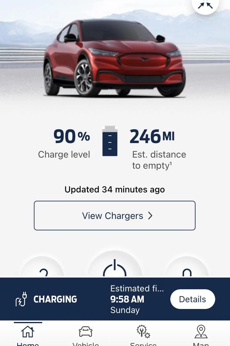

FordPass does have a banner while charging:
Ford F-150 Lightning Lightning EA Charging for EV Dummies 4608861A-C0DD-4ACB-BDB7-B3A3A13B9E06
You do have to tap “Details” to see current charge level.
Also, some fine folks have created customizable widgets for both iOS and Android that can do exactly what you want (I think). Head over to the Mach-E forum and search “Widget.”

Ok...does it appear outside the app or do you have to be in the app to see the window you are providing in your post. The pix looks like it's within the app. I could be wrong but thats what it looks like to me. Something like a simple status outside the app should be made available for smart watches as well so customers can get info on their watches without even looking at their phones. It sounds kinda techy, but man that'd be handy.
