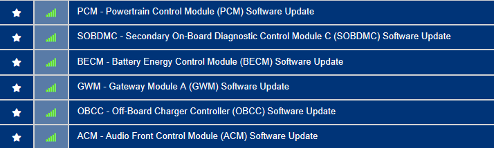

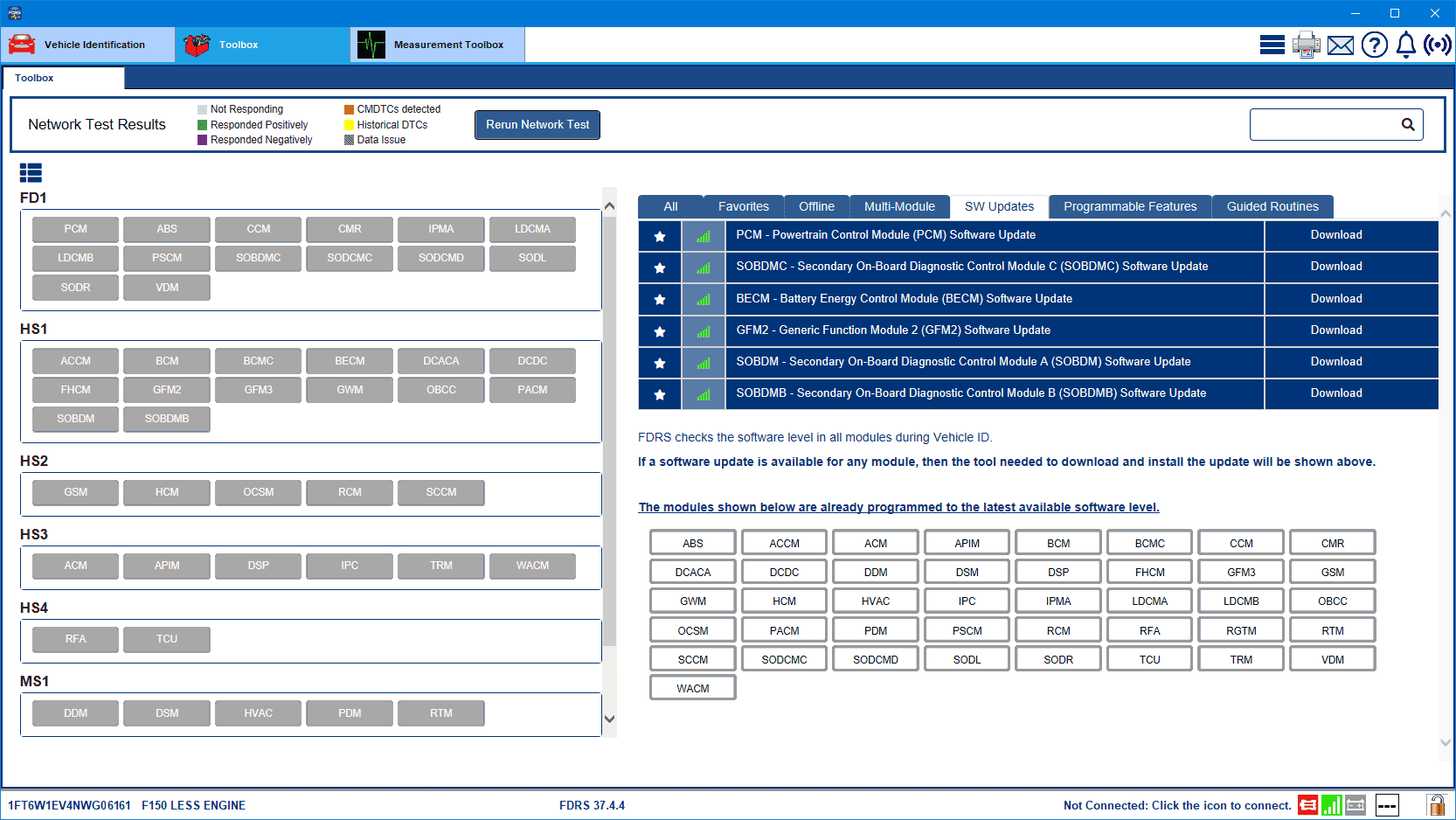

13 Sep 23 and this morning a set of Powertrain updates showed up for my '22. This follows a previous pattern of releasing updates on a Wednesday for Lightnings. (Mach Es seem to be on Fridays most of the time).
I've checked VINs on two '23 models and they got these updates in their list as well.
Ford F-150 Lightning Lightning Software Updates using FDRS 22_Lightning_Powertrain_Update_13-Sep-23
I do not have an ABS in this list but it will be there for some folks, it is part of the powertrain coordinated group of modules for the purposes of updates, and will be scripted to update in the pre-defined sequence after you select the PCM and hit "Run".
For those who don't know, all these are what's called 'coordinated' updates. Selecting the PCM kicks off a scripted update of all the modules you see here. You just sit in the seat and hit the "OK" button when appropriate most of the time. These are all CAN bus updates and will require a powersupply to be used.
Expect things like your guess-o-meter to be reset because the learned values will get wiped out by the update. Happens on ICE vehicles too.
Remember to do a CMDTC view and "Clear and Retest" both before starting updates and then again after you're done so that everything is "green" when you are finished and ready to disconnect.
Finally, I don't know what these powertrain updates are intended to correct or enhance. Powertrain updates generally come out once or twice a year (or more) and generally bring refinements.
EDIT: It looks like the BECM at least is tied to the CSP 23B57 program. It will enable a reduced power limp home mode in the event you have a battery issue (bad cell, or cells).

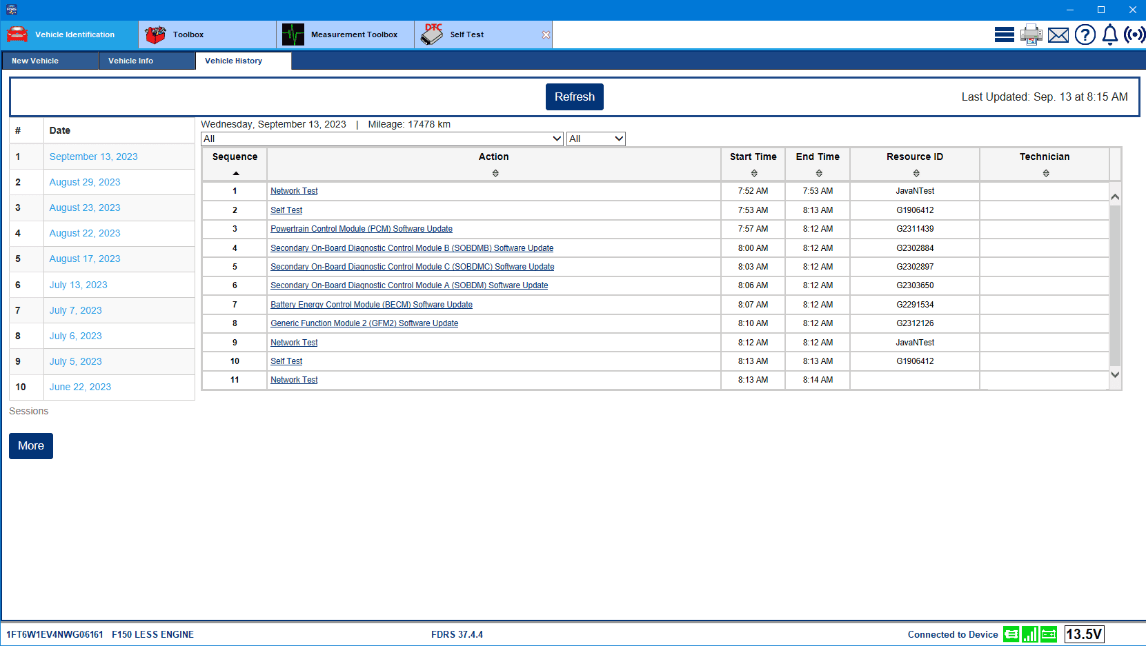

So to wrap this up now that it's all done and dusted, here's my session log from doing those updates. You can see that it doesn't take that long really. (Of course your dealer would have charged a couple of days to do this) ;)
Ford F-150 Lightning Lightning Software Updates using FDRS 22_Lightning_Powertrain_Update_13-Sep-23Done
The GFM2 was the last module updated and because of that, I guess, it didn't initially clear off the software list afterward. I tried the Rerun Network Test button once and that didn't clear it, so I then turned the truck completely on (not just Accy mode) and cleared and retested all CMDTCs and then hit the Rerun Network Test button again and it dropped off the list. All green, all good.

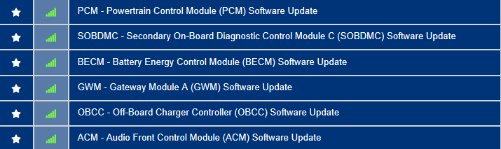

1FT6W1EV2PWG22853, 31 Jul '23 build date.
Ford F-150 Lightning Lightning Software Updates using FDRS 1FT6W1EV2PWG22853-13-Sep-23-31-JulBD
1FT6W1EV0PWG25007, 1 Aug '23 build date.
Ford F-150 Lightning Lightning Software Updates using FDRS 1FT6W1EV0PWG25007-13-Sep-23-1-AugBD
1FT6W1EV1PWG22567, 3 Aug '23 build date.
Ford F-150 Lightning Lightning Software Updates using FDRS 1FT6W1EV1PWG22567-13-Sep-23-3-AugBD
Dealer techs do not apply updates during PDI unless there's a "Stop-Sell" or recall. They do nothing more than check OASIS for any messages that would tell them what they are required to do and then just take the truck out of transport mode. That's pretty much it.
