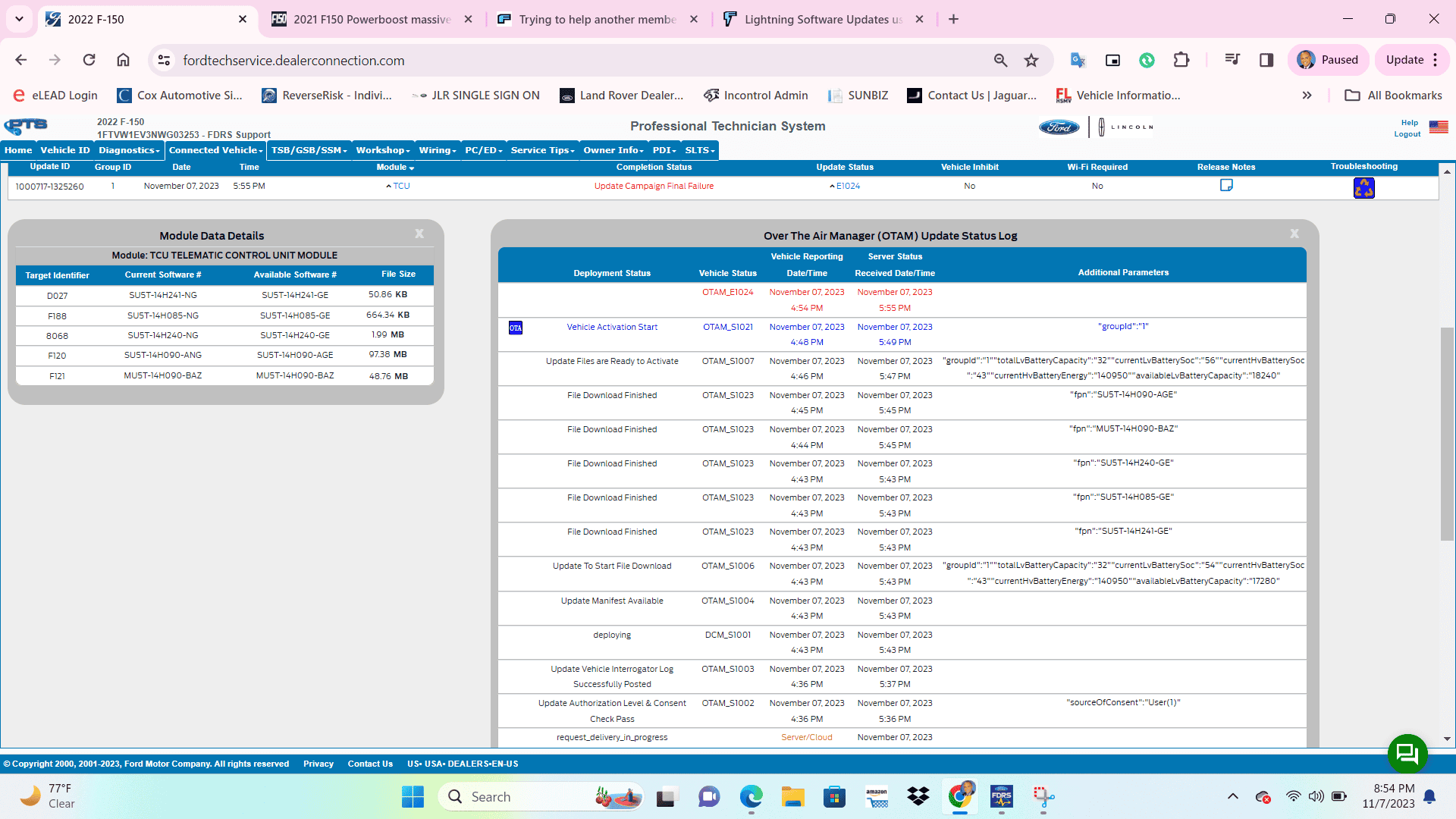

In what is bitter/sweet news, you are the first truck I know of to be sent 6.4.0. It is the TCU update I've been seeing out there in FDRS. PTS shows it failed due to low SOC, but the way it failed is weird. The OTA trigger was for 14 days and it says it failed the same day it was sent.
When you can, check for updates in your truck's settings and lmk what it says. I suspect it may have gone through even though PTS says it failed.

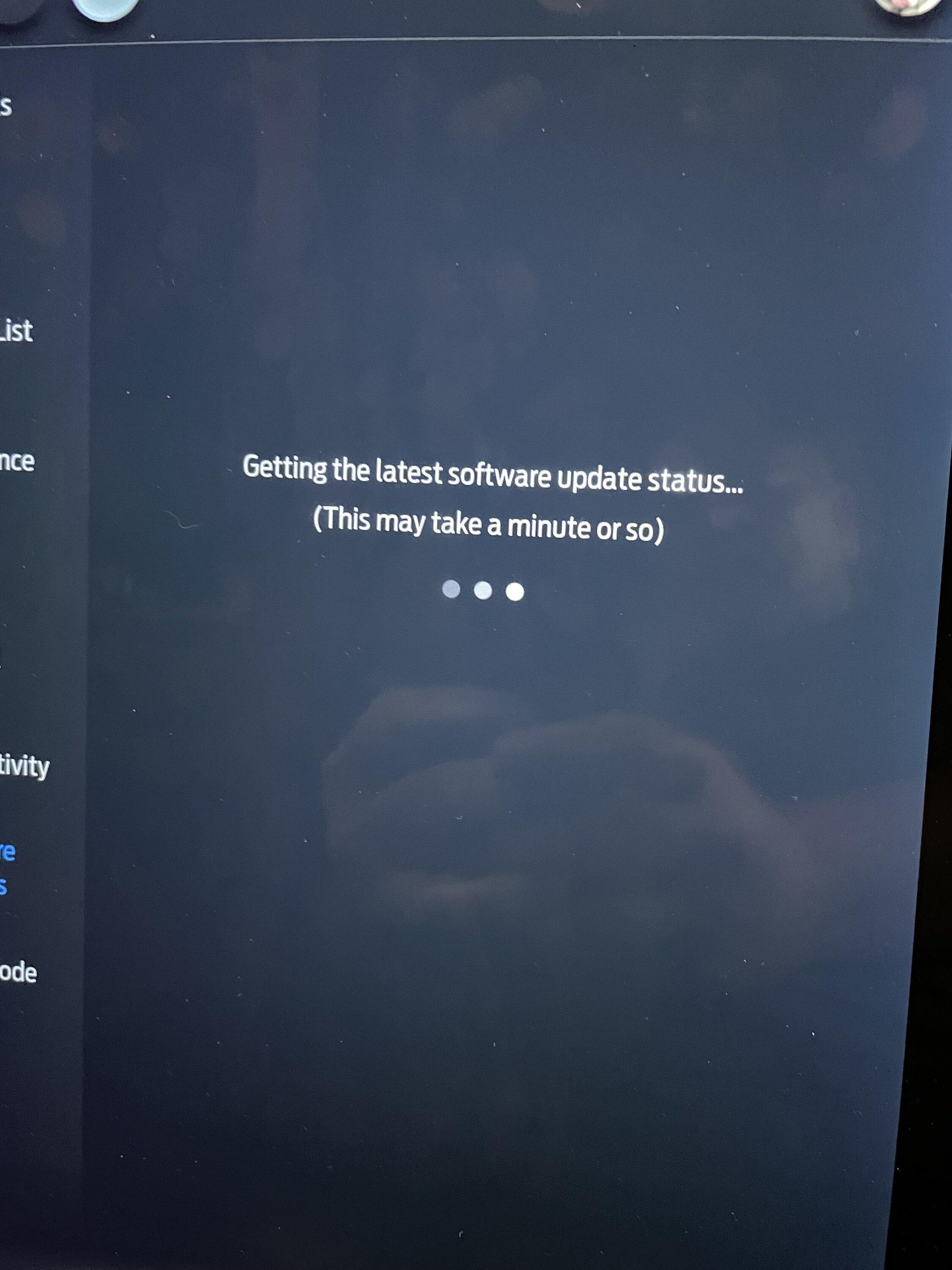

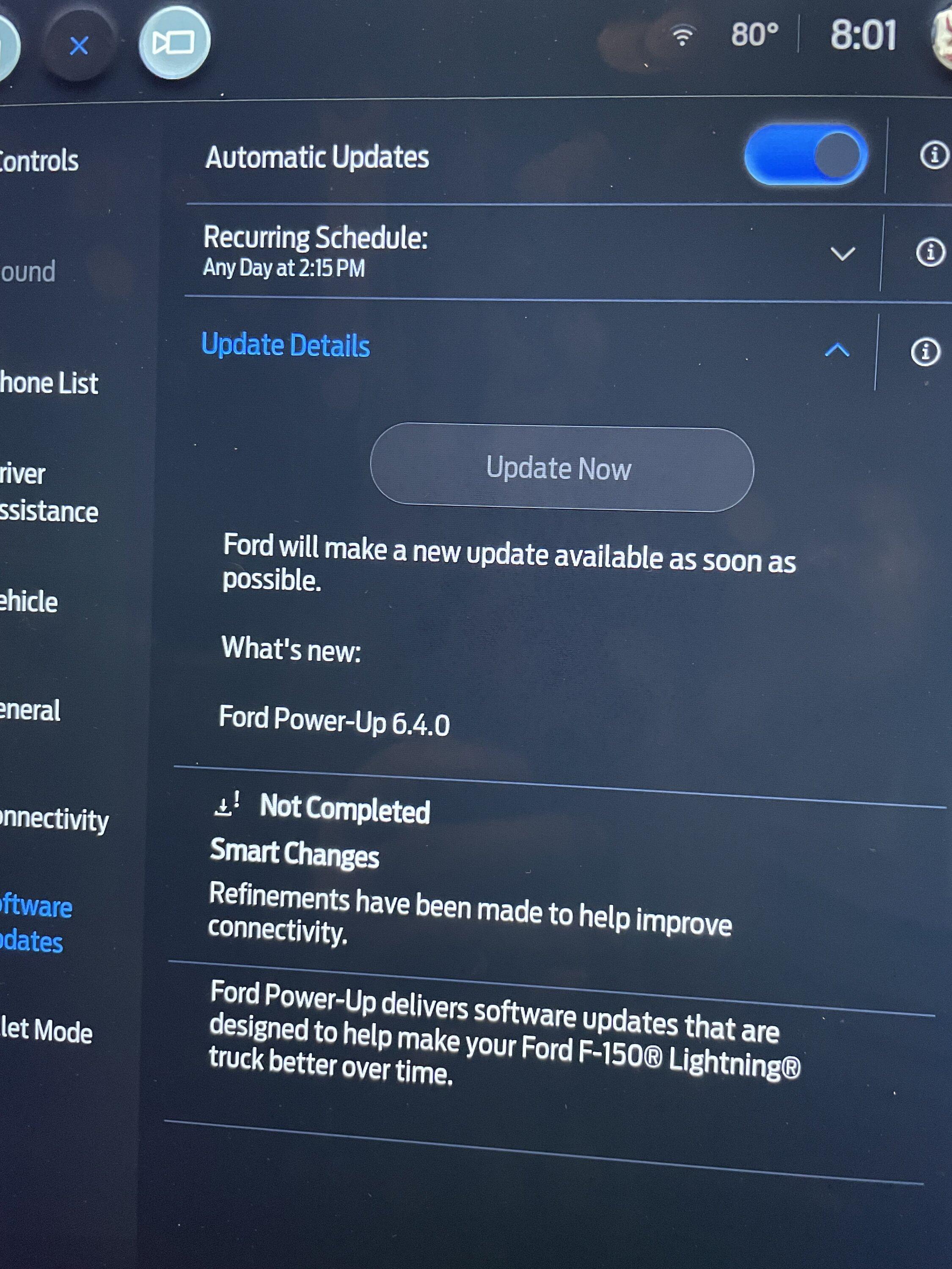

Indeed 6.4 has downloaded, but failed to install. That time is when I got out to go vote and then to dinner.
I captured a new screen I have not seen before as I checked for the update, it states "Getting the latest status...." so this must be some of the improvements they've been making for SW updates. The truck is truly checking in to see what the latest is.
From there - my failed 6.4 SW, but oddly it starts with "Ford will make a new update available as soon as possible".
