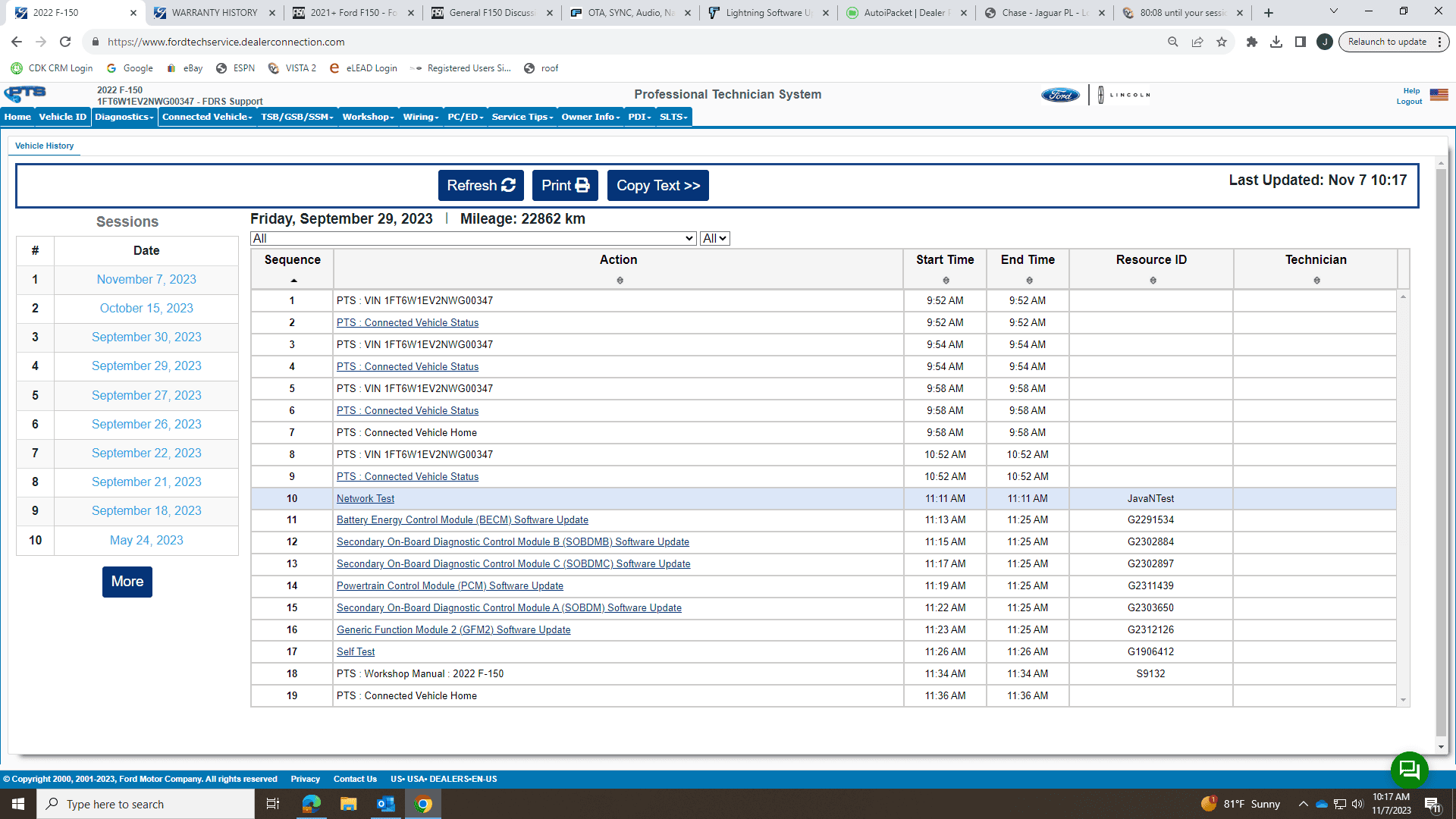

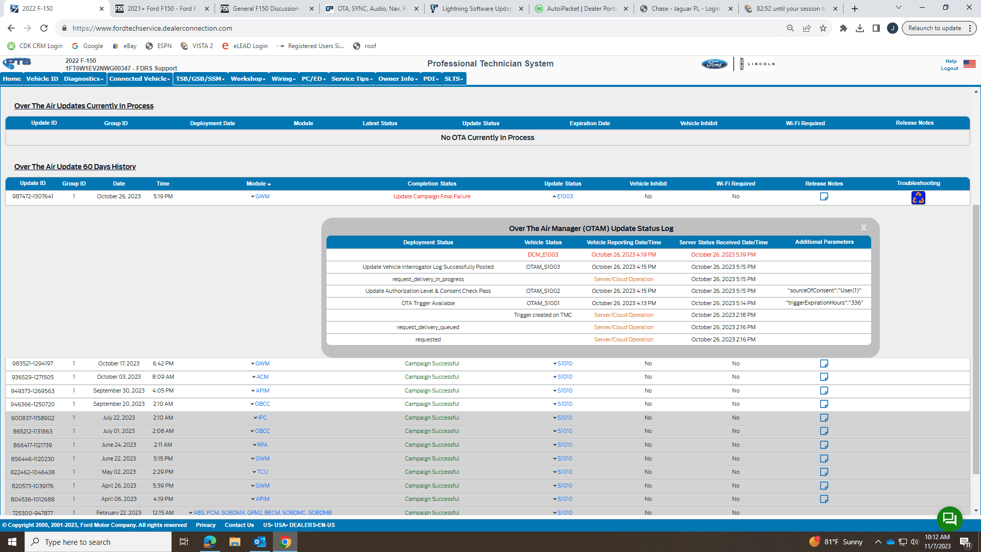

Not to step on @Mike G 's toes or anything; I don't know if he has access to PTS to check the details for these kinds of things. A screenshot of your OTA dashboard is below. 4.2.2 shows that it installed successful back on 4/6; that is the APIM update you see close to the bottom of the list. 6.1.0 show it installed successfully on 10/17. On 10/26, you were sent 6.2.0 which PTS shows it failed to install, but there is no error code provided to give any insight as to why it actually failed. It is not the first time I see an update fail without an explanation as to why it failed. The OTA failed before the manifest was posted for your truck to verify the files are correct and start downloading them. As far as getting OTA's sent you goes, I don't see any reason for you to be concerned. I am sure 6.2.0 will get resent to you sooner than later.
Ford F-150 Lightning Lightning Software Updates using FDRS 1699369953140
Vehicle history shows several modules on your truck were updated on 9/29. Warranty history shows your truck was at the dealer around that time, so I assume the dealer did these updates. The modules that they updated are below. This is important to your concern because these module updates could very well be tied to certain OTA's that you will either a) no longer receive because you already have them or b) will fail if the OTA gets sent to you because you already have them.
Ford F-150 Lightning Lightning Software Updates using FDRS 1699370353057
Now, why your truck is saying that 4.2.2 failed after a Sync reset is beyond me. However, weird things happen. My own truck says the last update I got was 4.3.6 and PTS shows that it failed. That update is a PCM update which would have wiped out my tune had it gone through, so my truck saying 4.3.6 went through successfully is a lie. I have pulled the files from my trucks PCM to verify I still have the old strategy, so the update for sure did not go through. Personally, I would not stress the fact that your truck is saying that 4.2.2 failed now 6-7 months after it installed.

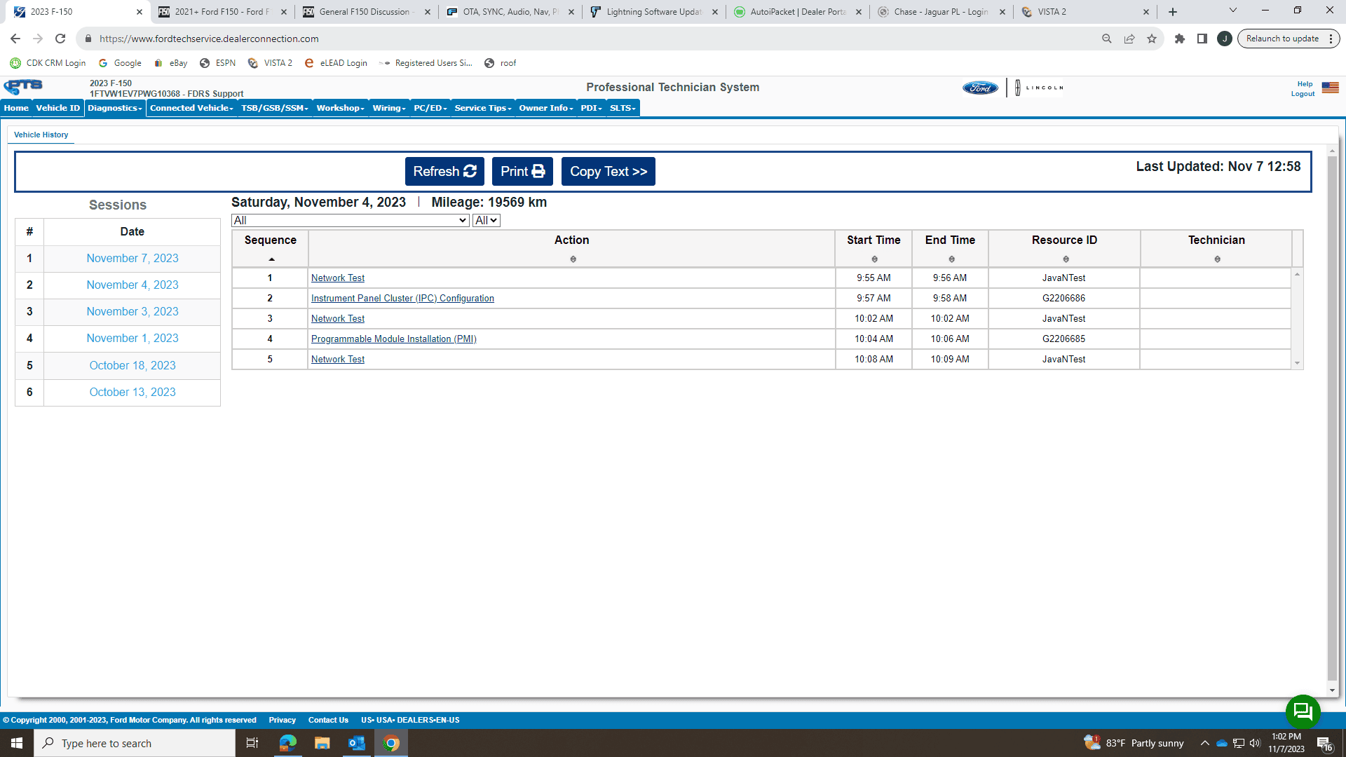

I can check FDRS for you later when I get home to my laptop to see if you have any more modules pending updates. I have had a few people PM me the VIN to see if the IPC update is pending for them in FDRS, and I have yet to come across one Lightning that has it. I think maybe Ford pulled that update to fix something.....I can't say for sure. I don't have any other logical reason as to why the IPC update isn't showing for so many trucks, Maybe Mike can shed more light on this theory since he knows these trucks better and has been following these issues along for much longer than I have. Your truck is on Sync 23237 which is the latest and greatest.

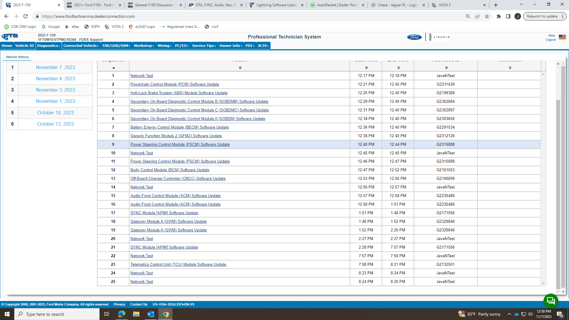

With that said, the modules that were updated on your truck are below:
Ford F-150 Lightning Lightning Software Updates using FDRS 1699380059999
I clicked every update and every one went through. The very next day, a config and PMI process was done to your IPC. I assume whoever did this was trying to pull the newest files possible on the server for your IPC. Based on the time stamps when the config and PMI process were started and were finished, it did not pull any new files from the server for the IPC, so the software is the same.
Ford F-150 Lightning Lightning Software Updates using FDRS 1699380208671
