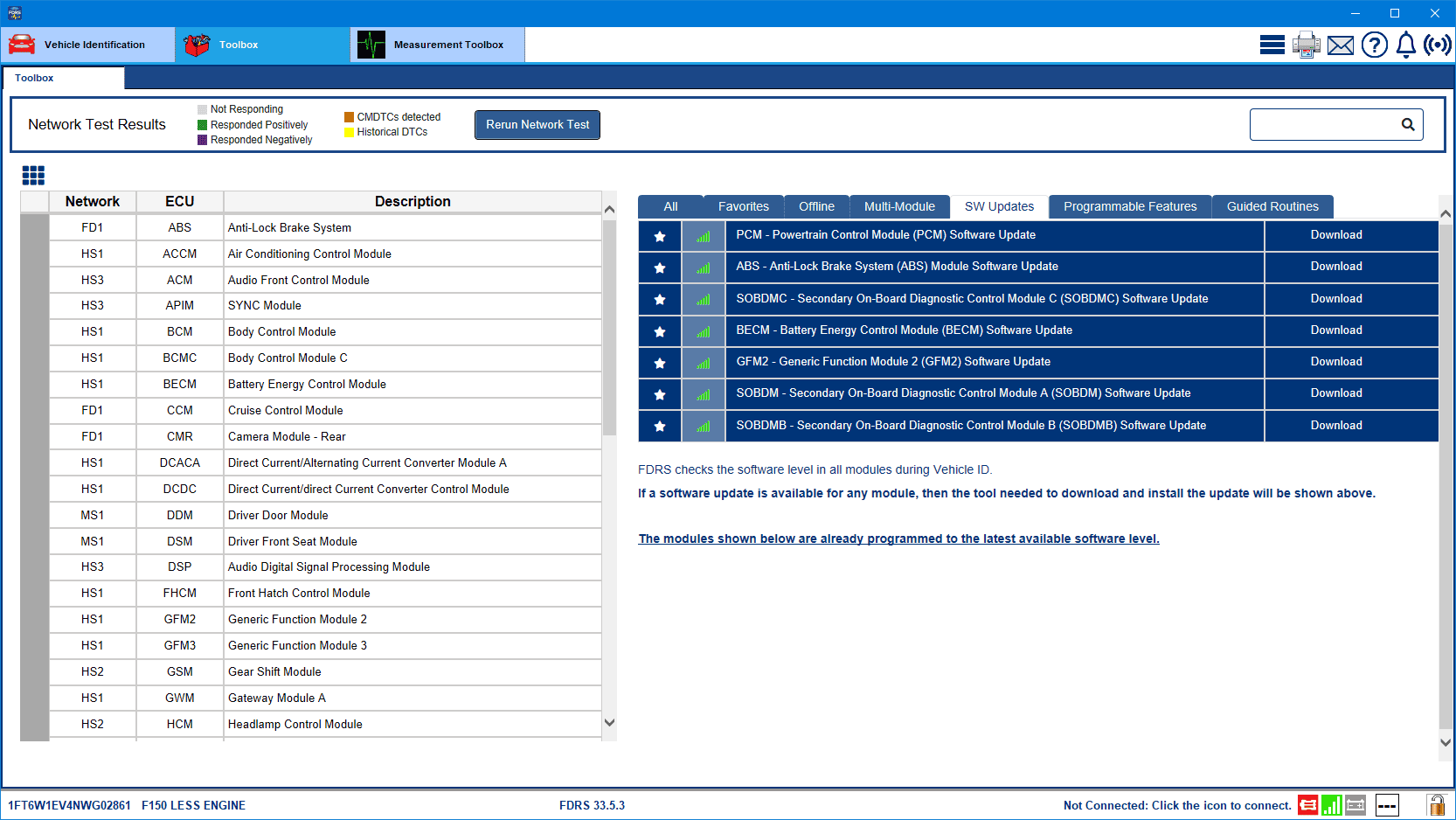

4 November and lots of updates this morning that were not there yesterday!
Looks like a selection of powertrain updates (PCM, BECM, SOBDM, SOBDMB, SOBDMC) and the ABS system and generic function #2 which I think may be the tailgate module but I'll have to double check on that.
So if you are doing these yourself you'd start with the PCM, and then the rest of the powertrain items would chain in sequence. Then the others in this list can be knocked off in any order.
Ford F-150 Lightning Lightning Software Updates using FDRS Lightning-Updates-4-Nov-22
I'll follow up with any observations afterward.

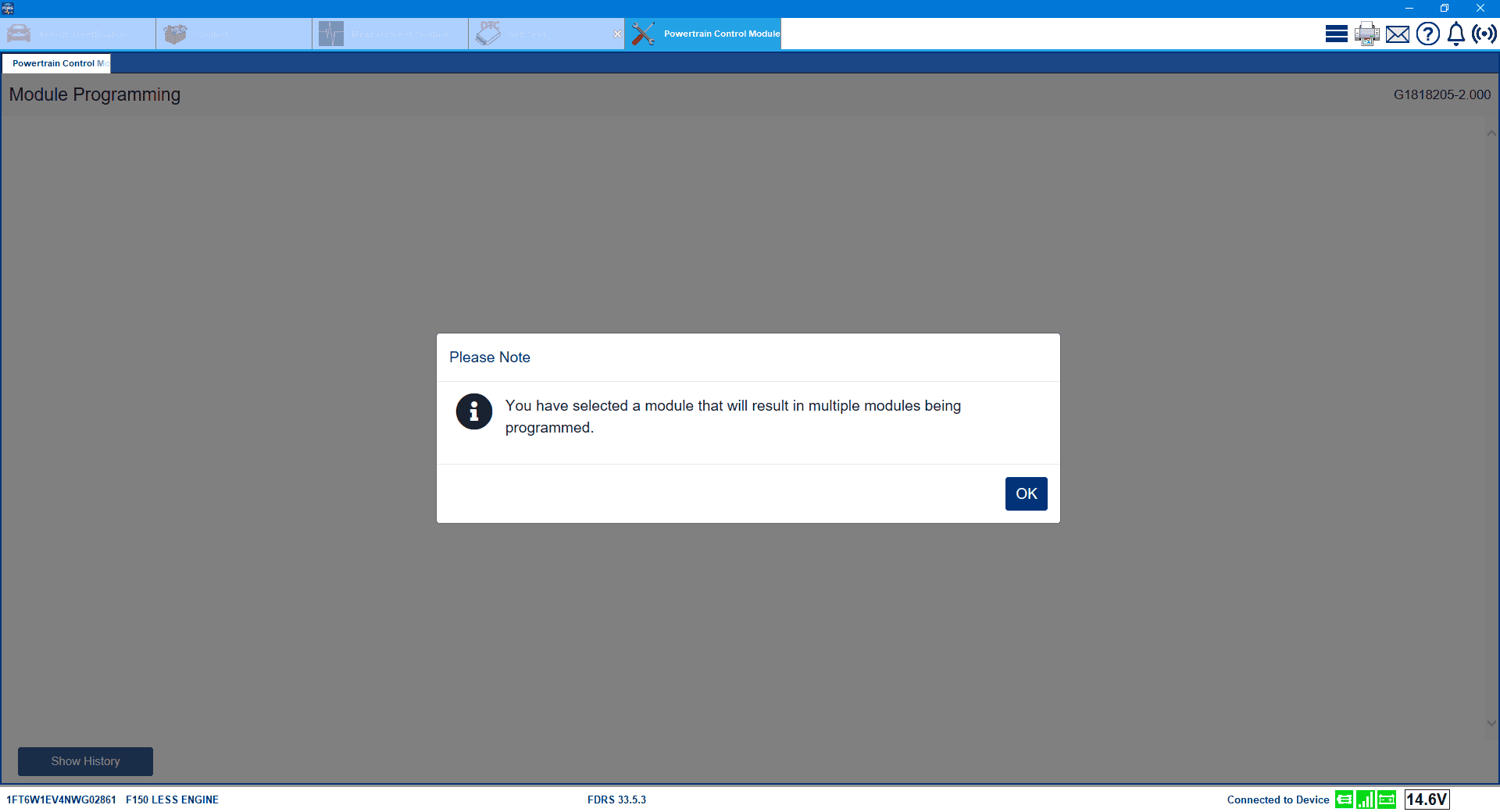

EDIT: All done and it was interesting. Above, I said to start with the PCM and it would chain all the rest of the powertrain items in sequence. Well here's how it went; I setup the powersupply and laptop and initially picked the PCM, no problem, very straightforward. What surprised me was that the ABS was next, I guess I had forgotten that the ABS is a powertrain module as well. So after the ABS was the SOBDMB, SOBDMC, SOBDM, BECM, and then this last one threw me and I wasn't expecting it, but the GFM2 was chained right along with the rest. So everything in today's list were all what Ford refers to as 'coordinated' updates that once you select one in the list you'll get a message like this one:
Ford F-150 Lightning Lightning Software Updates using FDRS Multiple_module_Note
And then all you do is turn on and off the "Start" button on the dash and select "OK" on the laptop when it's time....and it steps you through everything in sequence.
Total time on the FDRS laptop from the very first vehicle 'network scan' to the final logoff was 28 minutes.

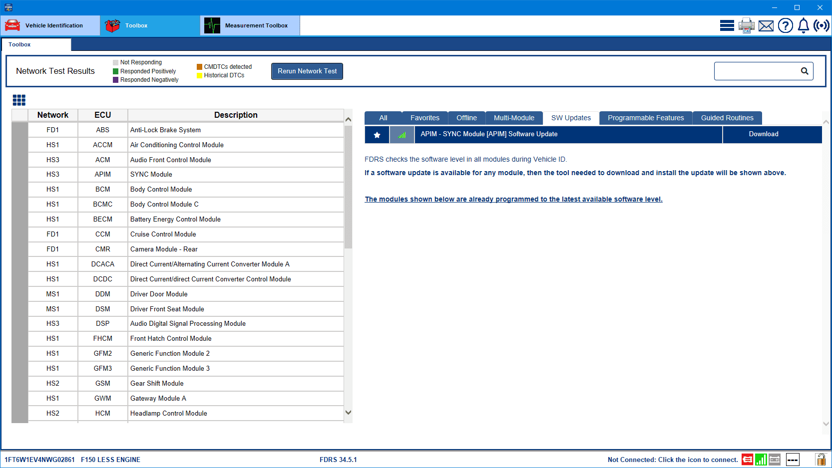

So for those of us who are doing their own updates, but only buy the two-day license when needed....before you have another go be sure to update your FDRS software, a new update came out late last night (16 Nov 22).
Ford F-150 Lightning Lightning Software Updates using FDRS FDRS_Update_34.5.1

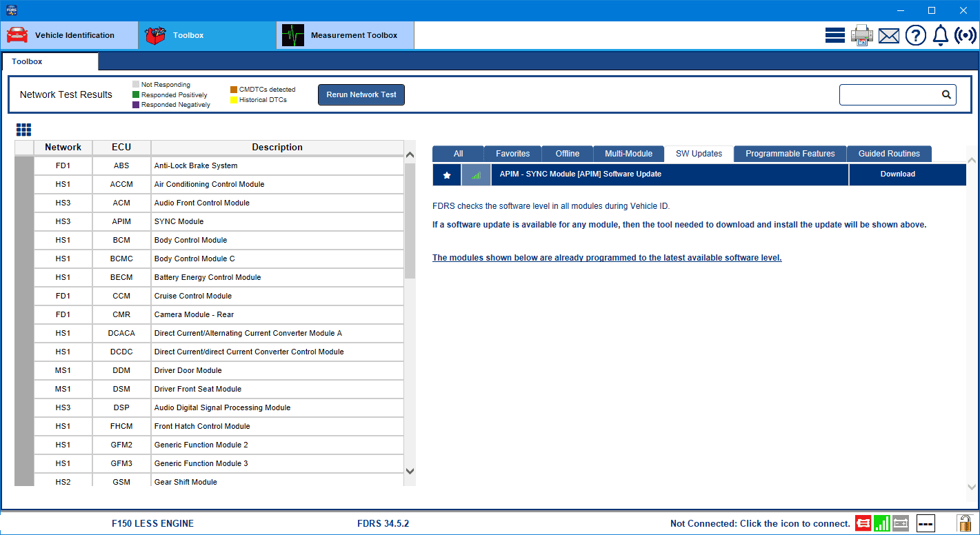

22 Nov 22 and a surprise APIM update showed up this afternoon. No idea what it will change or enable...but my truck today did not indicate that it had a pending PowerUp 3.5.5 like many other folks were talking about yesterday and today.
I'll do the update tomorrow and see if I can figure out what changed.
Ford F-150 Lightning Lightning Software Updates using FDRS Lightning_Update_APIM_22-Nov-22

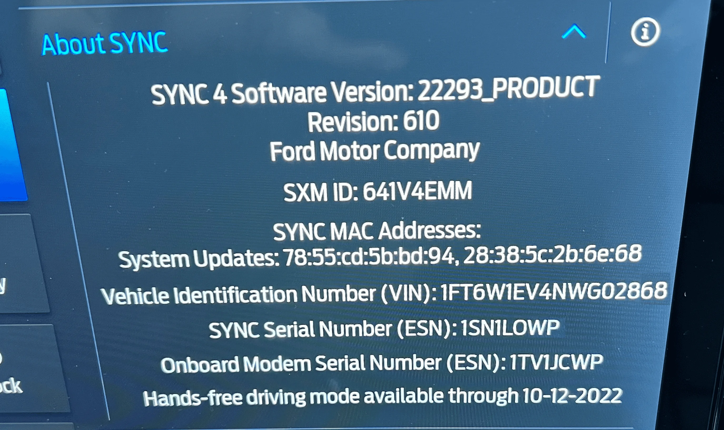

As a followup to the APIM post above...I just did the update. The Sync "About" screen says I'm at version 22293_PRODUCT and rev. 610
Ford F-150 Lightning Lightning Software Updates using FDRS Sync_610
The update was pretty uneventful except for a notice that one file failed to download and did I want a retry...to which I said "yes" and then it all went to plan.
For those doing this at home the "F188" DID value, which normally is the identifier for a revision, did not change...it's still the "-DT" revision from a couple of months ago that added the dual phone connectivity....but other packages in the update did change and as a result the Sync version went from 539 to 610.
I have no idea what the changes are since I haven't had time to thoroughly explore yet (other things to do this morning).

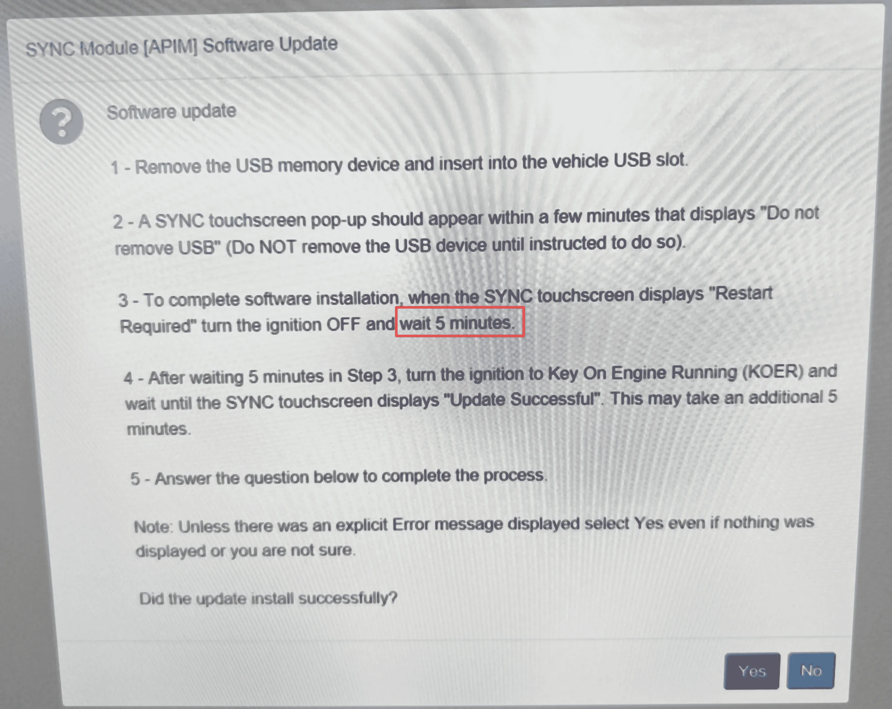

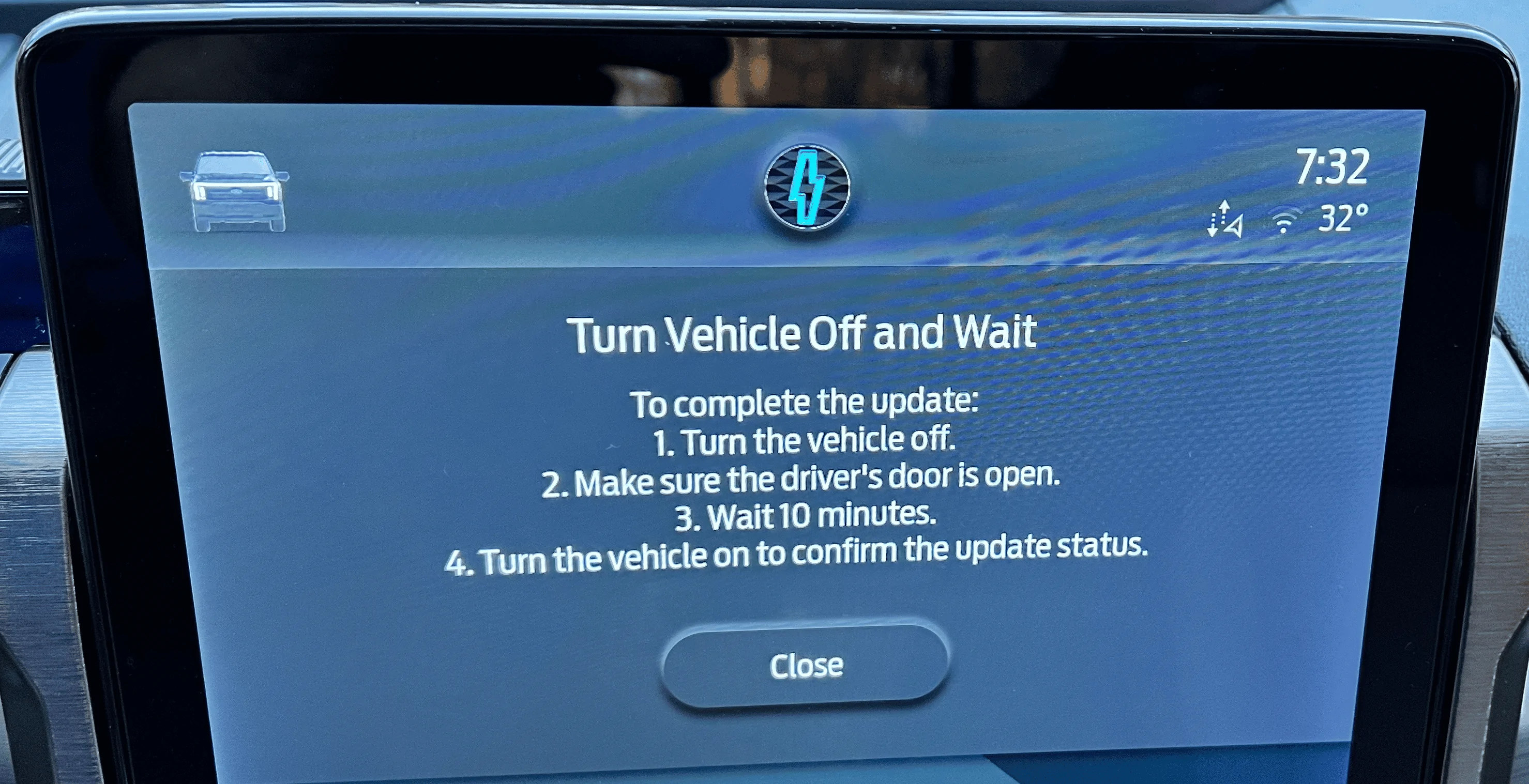

Also, if doing this at home you may get mixed messages like I did when following the instructions after the USB drive has downloaded the update to the truck's USB port.
The Sync screen says this:
Ford F-150 Lightning Lightning Software Updates using FDRS Turn_off_and_wait_10
But the FDRS onscreen instructions say to wait 5 minutes instead and nothing about leaving the door open:
Ford F-150 Lightning Lightning Software Updates using FDRS Turn_off_and_wait_5
I played it safe and followed the Sync screen instructions for 10 minutes with the driver's door open.

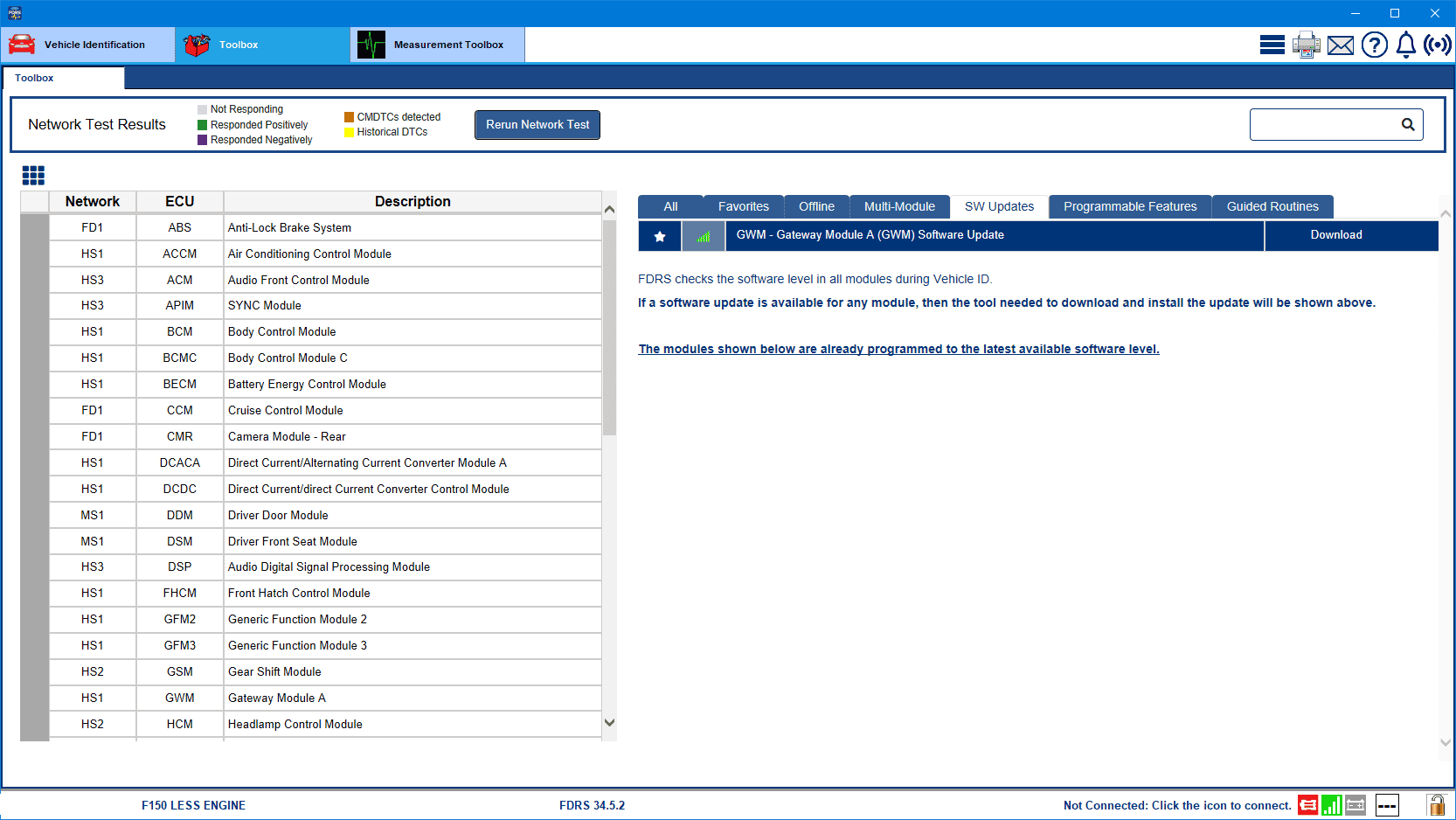

So this evening a new GWM (gateway) update popped up (wasn't there this morning). I'll knock that out tomorrow morning and report any new functionality...if I notice anything....I still have no idea what got changed in the recent Sync version 610 I'm running now. I've asked around on the F-150 forum and at least one very knowledgeable member over there got this update and just like me, has no idea what got updated or changed in the APIM.
Ford F-150 Lightning Lightning Software Updates using FDRS Lightning_GWM_7-Dec-22

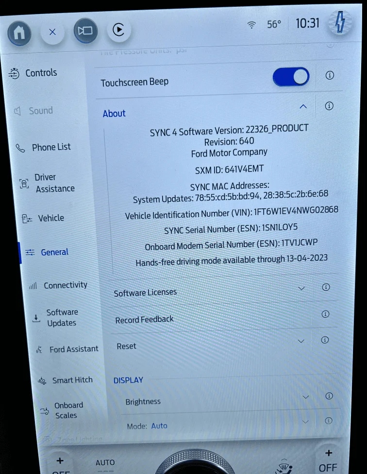

Okay folks, the previous updates were all leading to this....the major overhaul of the Sync system to the new interface.
I won't bury the lead...this update takes you to Sync 640, and is a whopping 6.27 GB big and took quite sometime to download even over very fast Starlink (thanks Elon!).
One of the first things that caught my eye was the Camera Software Button on the top row! WhooHooo!! They are listening to these forums after all!
I'll post some pics later I want to go out and press some buttons first and poke around a bit.

FDRS yesterday evening:
Ford F-150 Lightning Lightning Software Updates using FDRS Lightning-APIM-13-Dec-22

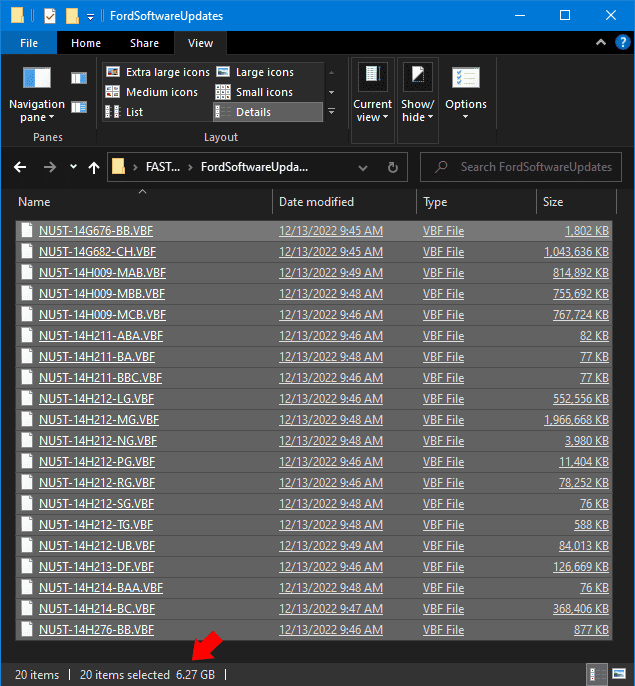

I dug in this morning and it took a long time to download. Cause it's the biggest APIM update I think I've ever done so far at 6.27GB:
Ford F-150 Lightning Lightning Software Updates using FDRS File_size_Sync-640
From start time to finish (including the 10 minute shutdown for the A/B switchover) one hour and ten minutes total.
Ford F-150 Lightning Lightning Software Updates using FDRS Sync_640sm
Loving the dedicated camera button!
Still no streaming of YouTube etc...I guess that's going to take a future update to the TCU like they did on the Mach-E to enable it there.
A little weird...got the new Sync interface on the Lightning with no streaming in "Entertainment" but on the Mach-E I've got the streaming in the "Entertainment" section but the older interface...
Oh and for those who are wondering...when you hit the camera button at speed you see the rear view in the top panel....and yes there's still a banner that says "Full View Not Available" right in the middle of that view. Not sure where that banner comes from..it might be in the IPMA.
