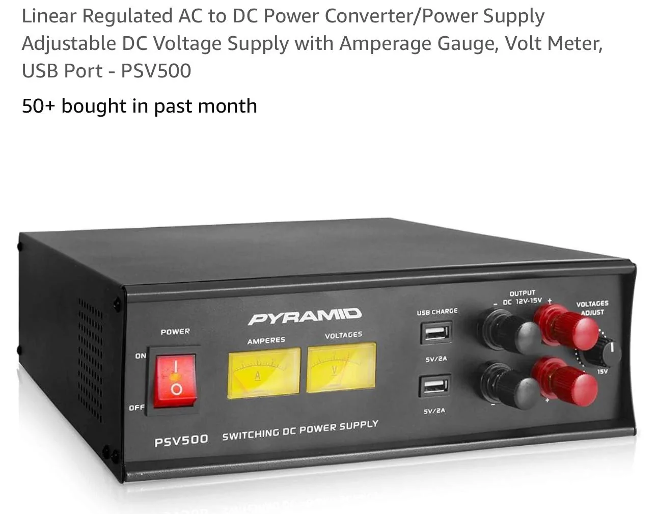

I’d think that is possible option, just not what I did.
I went with a different option to use for other things later on personally. It ran me about $110
https://a.co/d/0fGmKLjF

Here's my opinion on power supply options...
  1. In general, anything less than 50A is suboptimal.
  2. 2xPL2320, while it most likely will work, the 2.5-3hr updates should be "interesting" and there's in my opinion absolutely no reason to go with this option since the IOTA is only $40 more, the Pyramid is less, and both are much less of a "hackjob" connecting.
  3. Both the Schumacher and Clore PL6100 are nice units and a nice option if you need a powerful charger in addition to the power supply. I would personally pick the Schumacher because it has a 15A plug.
  4. The IOTA DLS90 has to be the best value on the market today at $200 (I paid more for mine). It's a solid unit, very clean 12V/13.6V output and has a 15A plug.(the 75A version has a 20A plug for some reason). The downside is that in in it's standard form it's only a power supply and you have to figure out the cabling (alligator clips or hardwired like I did on mine) yourself, so the first time setup is more complicated than it would be with a ClorePL6100 or Schumacher INC100.
  5. I have no opinion on the Pyramid unit above, seems to work for @ScubaSteve_TheReal so it's an option although it is on that 50A "limit"
  6. I would NOT recommend using one of the 50A $30 / 100A $60 power supplies on Amazon. Even though they "should" work from a (short term) rating standpoint (50/100A), you typically get what you pay for and I wouldn't be too surprised if they go up in a cloud of smoke after continuously supplying 40-60A for 3hrs. (IOTA,Clore and Schumacher all have built in cooling fans for example)
